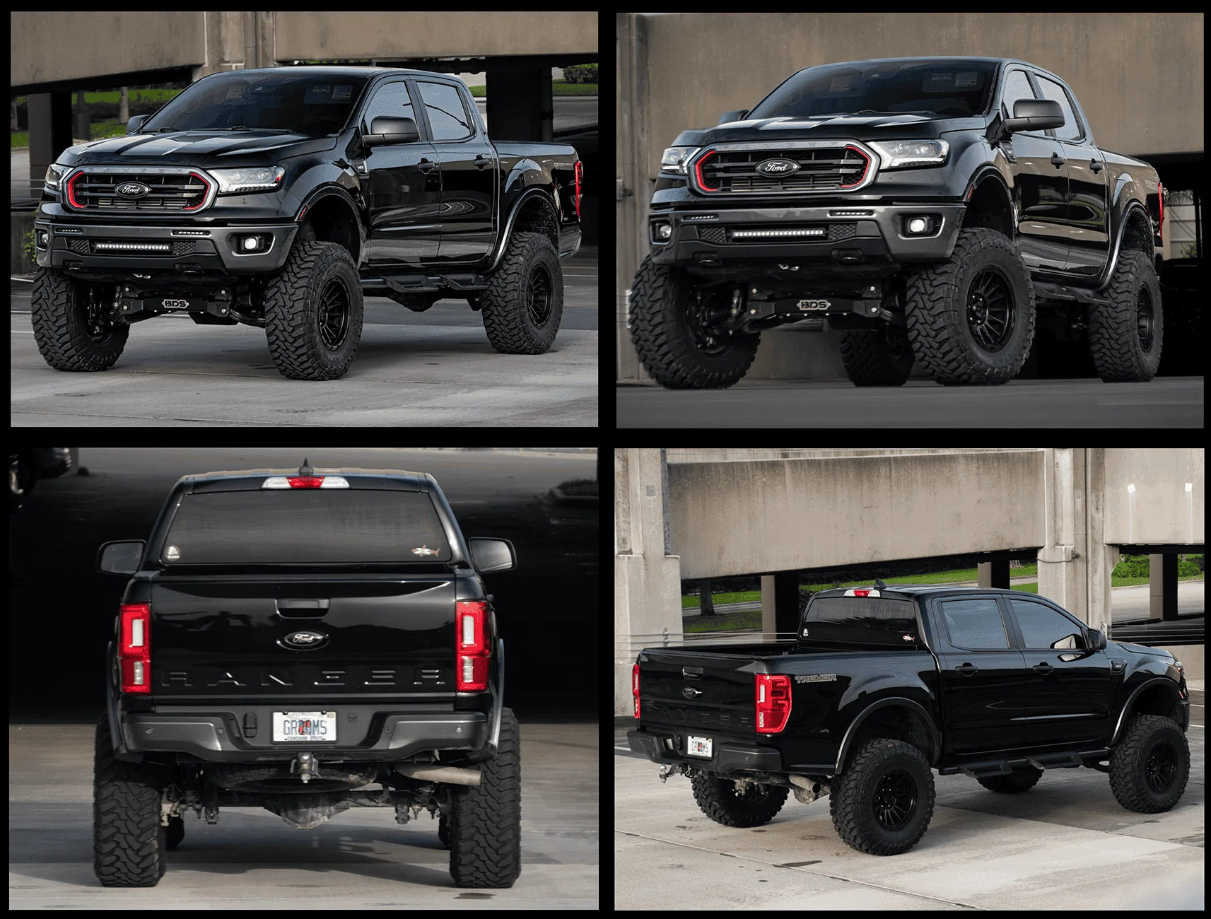

Tires are 35s (Toyo All Terrains) on 17 fuel wheels.
If you are looking at tremor lifts but don't want anything excessive, I'd just get a 2in leveling kit and a rear 1in block, it's a solid stance with the tremor suspension. (Should get UCAs too)
This is a 6inch BDS coilover kit, so it removed tremor shocks/coilovers and dropped the diff. @tygr2007 and I both did BDS 6in kits, I'm sure he can offer some good insight too. He convinced me to buy my kit.
If you are still going to get a 6inch lift, get BDS. And be prepared for spending more $, it was not fun on my wallet, you will also need new wheels because of the massive knuckles on the kit. My shop charged $1100 for install, alignment, and mount/balance, and they installed my smartcap, most shops will probably quote around 1k.

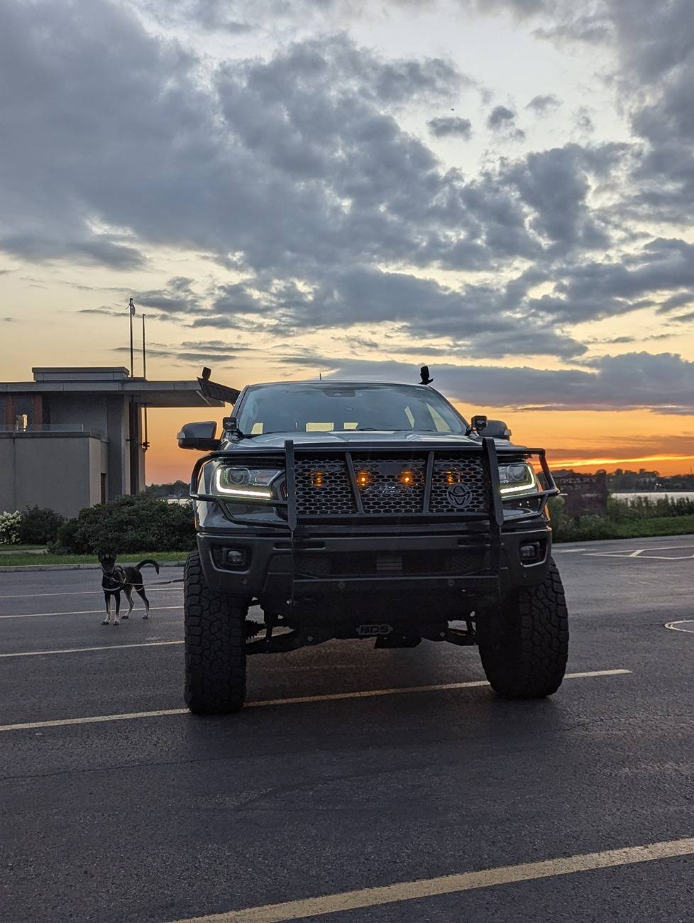

Technically an 8" Lift. It's got a baby lean- about 1.5 in lower on the rear.
What do you tow with your truck? I keep talking myself into leaving my '21 Tremor alone because we tow a 19' travel trailer. Only did a 1" level, 1" wheel spacers and 285/70/17. I sometimes think of going another inch higher and taller on the tires too but she drives so well on/off road and while towing, I don't want to mess with it.....until I see another Ranger that has a more aggressive lift/tire setup and see how clean it looks.
