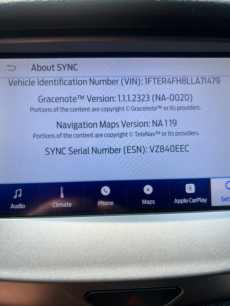

Is your Sync version up to date 3.4 23188? Have you tried a new USB cable to the phone?

My apologies. It was the next picture in the reel. But confirmed. Sync 3, Software Version:3.4. Build 23188_Product
