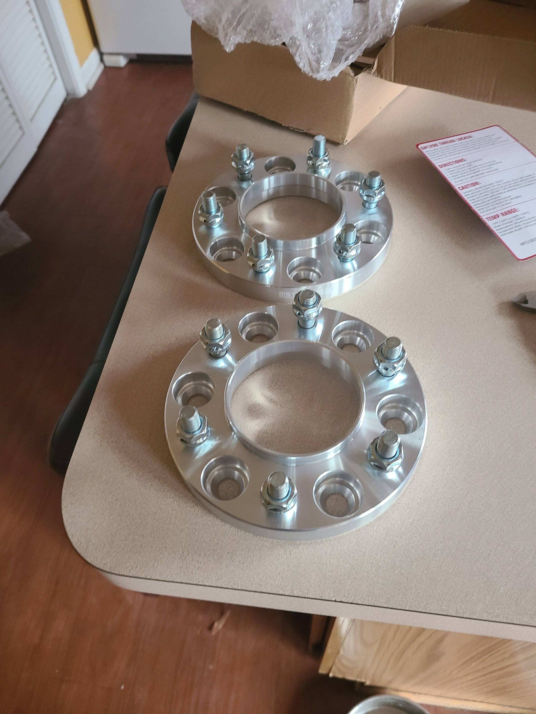

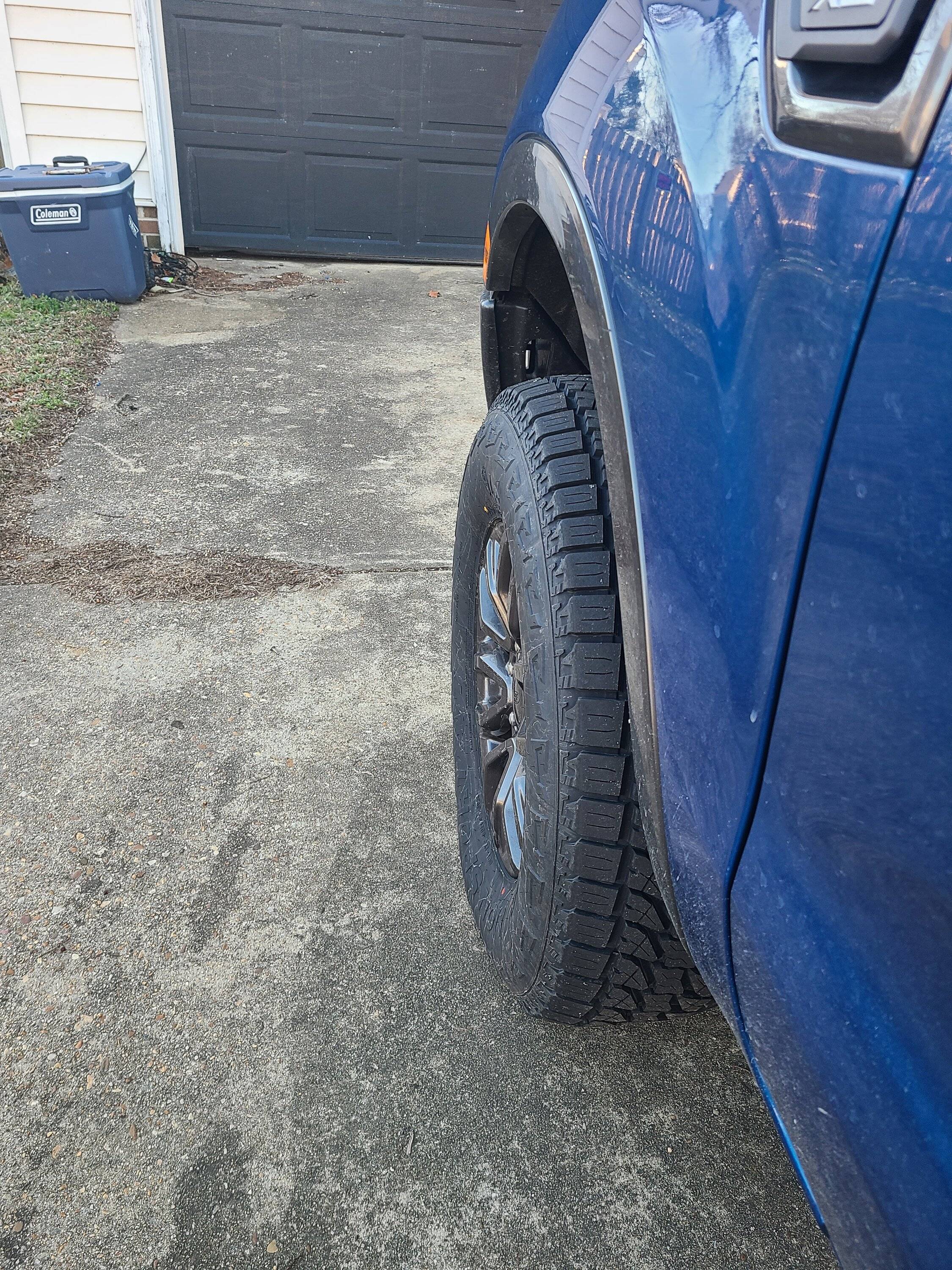

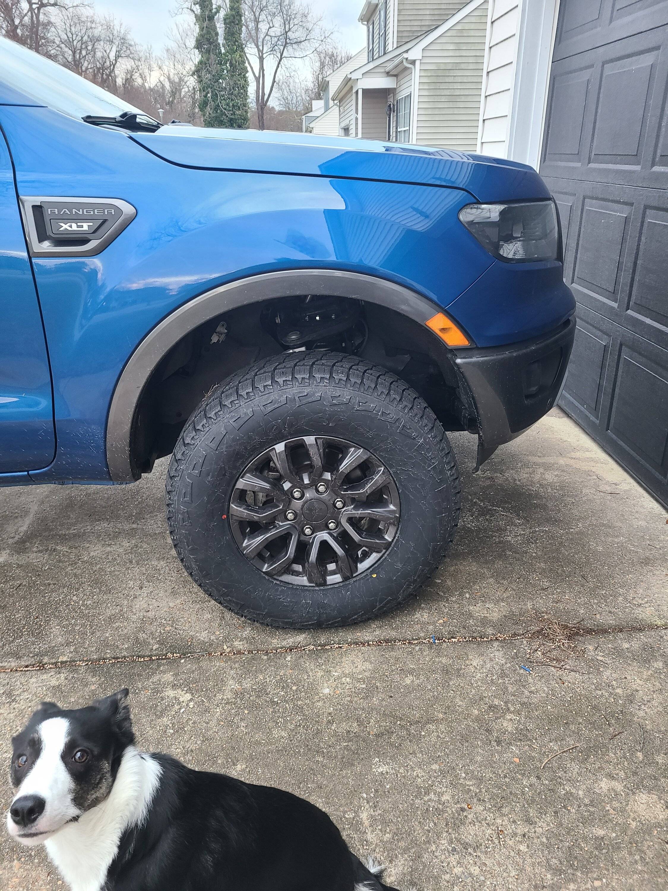

Threw on some 285's, didn't cut crash bars and have good static clearance (including full lock). Used 20mm spacers just on the front. Will cut the bars before going to the mtns again, cuz it's closer than you'd want on real trails. Used RC 2.5" leveling kit.

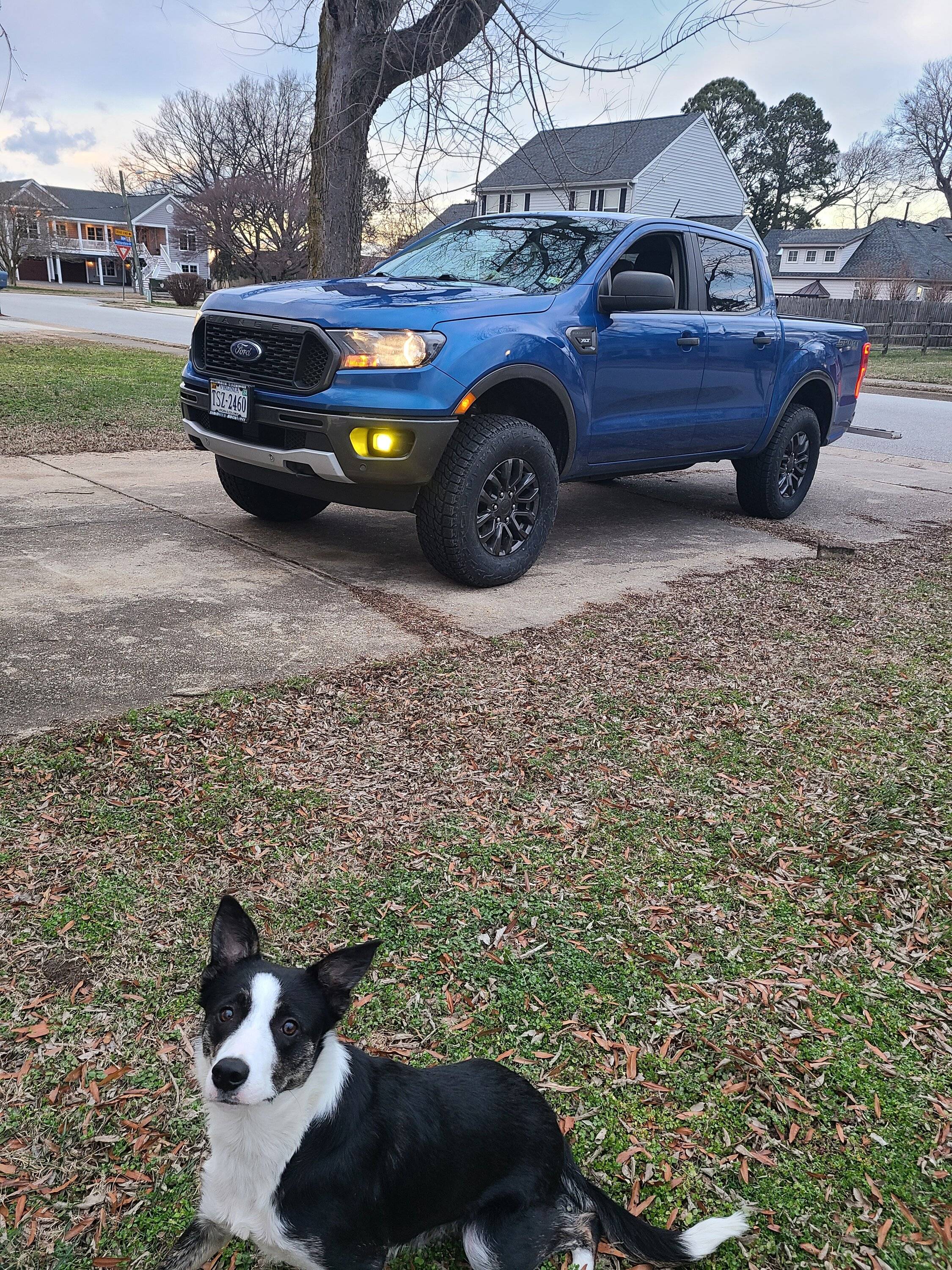

Sealight amber fogs are pretty good, not sure why I would want fogs the same color as my headlights in fog and snow...

I like those spacers, I would have gone that route had i seen them way back. I'm right there with you on the transmission shifts. Shocks all around made a huge difference. My second biggest complaint is the rear leaf springs.

looks like you have a lot of room with the 285s. i have 265 and the side wall is so close to the knuckle and crash bars...
