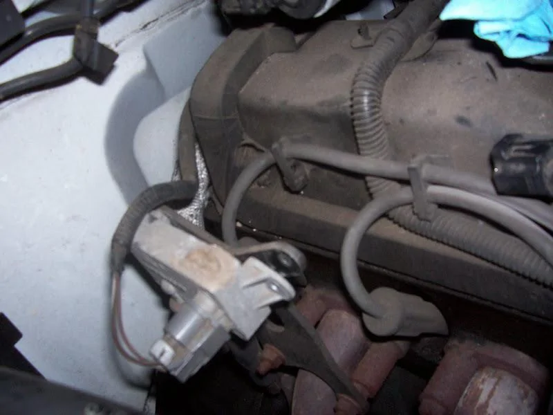

Hi Jsphlynch,
I am really foggy on 2003 Ranger 2.3L, as I was involved with the Firestone fiasco and did not support the 2003 launch...I believe the DPFE location remained the same as 2002, but not positive...see the pix...

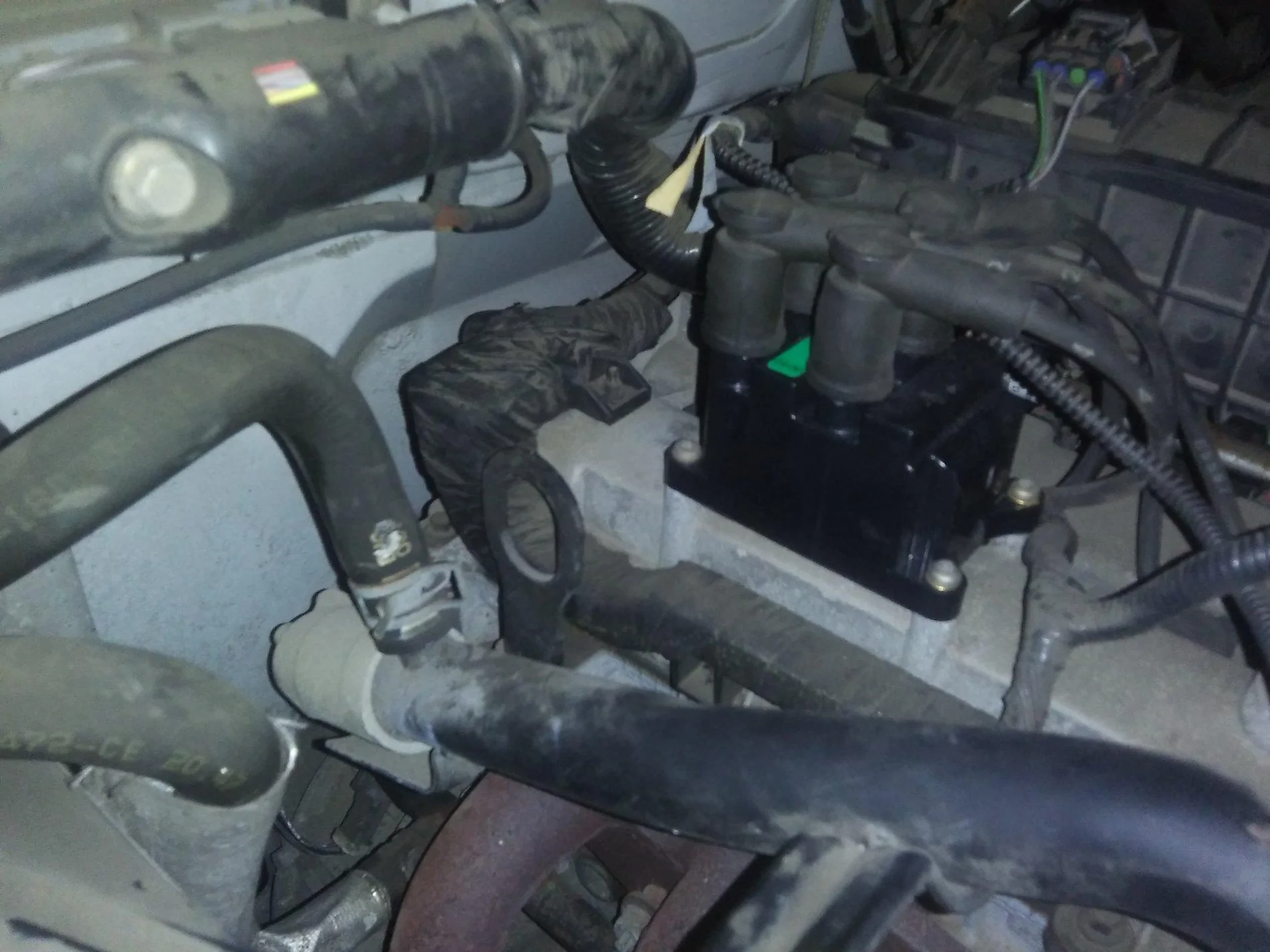

Thanks Phil, but it looks like they did move it. See my picture.
