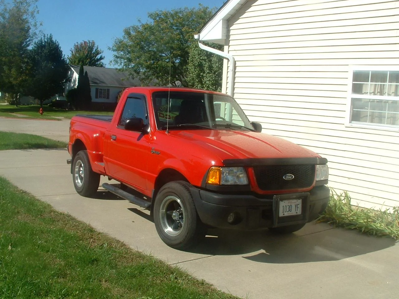

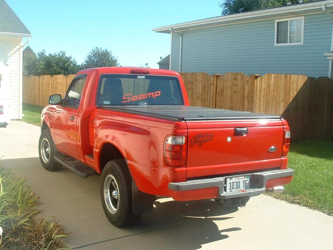

Here is a 2001 Ranger Edge...formerly known as Robert.(Red-Ford)
It was a package on the Ranger which had a 4WD chassis but it was 2WD with welded spindles in front..
Rubber floornats, roll up windows the graphics are custom 'cause I didn't like the Blue block letters which came on it.
It was 4.0L 5SPD manual with big brakes and an 8.8" rearend.
The picture is recent.

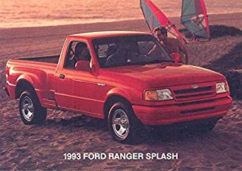

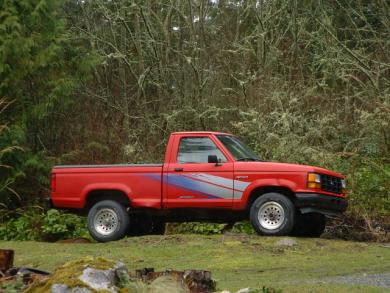

I bought a new Splash Ranger in 1992.
It was a pushrod 4.0L 6CYL 5SPD manual It had articulated bucket seats with separately adjustable thigh support.
GREAT truck, I ordered it with the Splash graphic deleted. Red truck with white and blue giant graphic sounds great but it looked like it had sideswiped a bridge or ran over some buckets of paint!:crackup:
When it came in without the graphic the dealer failed to call me at first 'cause he thought it was a base truck.
It looked something like the one below. The very next year was the new bodystyle and the splash was just a little too "cute"
141
7,012
36,167
When it came in without the graphic the dealer failed to call me at first 'cause he thought it was abase truck.
Hi Floyd,
Most of us in LTE Light Truck Engineering did not want the truck named a Splash. We thought it was the sound a turd makes wihen it hits the water....Oh well...Trite but True...water under the bridge...
