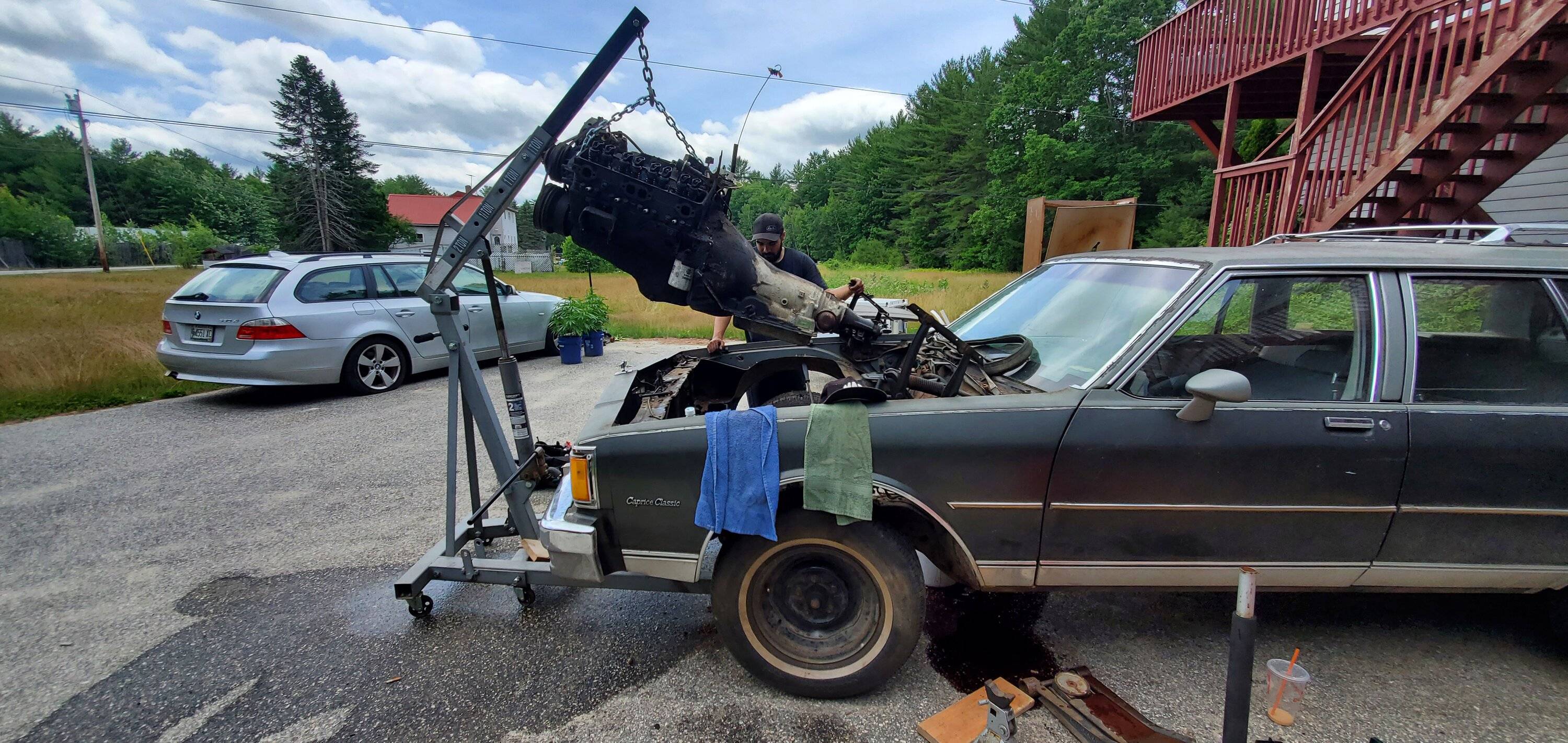

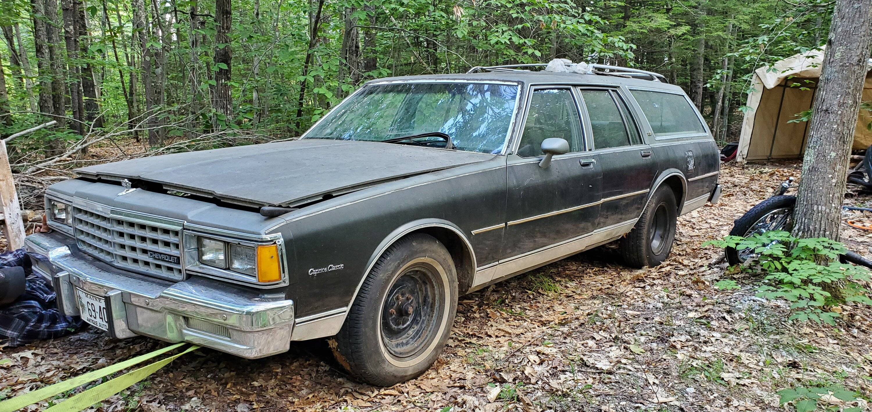

5 or 6 years ago I bought myself this bitchin' old ride for 900$. Forget what the ODO reads.. but from the amount of sludge under its valve covers... it's rolled over at least once lol.
It came with the wheezebag 305, a whiny 700r4, and 2.73 or 2.42 rear gears. Needless to say, it wouldn't dream of spinning a tire on dry tar. I DID get it to spin a tire ONCE... but it required wet sandy pavement.. turning right full-lock.. and all the throttle lol.
I drove it for 2 summers happy as a clam.. apart from needing to occasionally vacuum up acorns off the floor brought in by mice ?
At the end of the 2nd summer I decided it needed more power. The initial plan.. and what I started to do.. was put together a home-brew turbo setup for it. When the 305 blew up I was going to drop a mild built 350 in it and call it good. I ditched that idea and sold off all my turbo crap when I realized how much power an LS motor can hold in stock form... and how cheap LS swap parts had gotten in the past few years.
I've spent the last few years trying not to change my plan anymore and amassing a big expensive pile of parts.

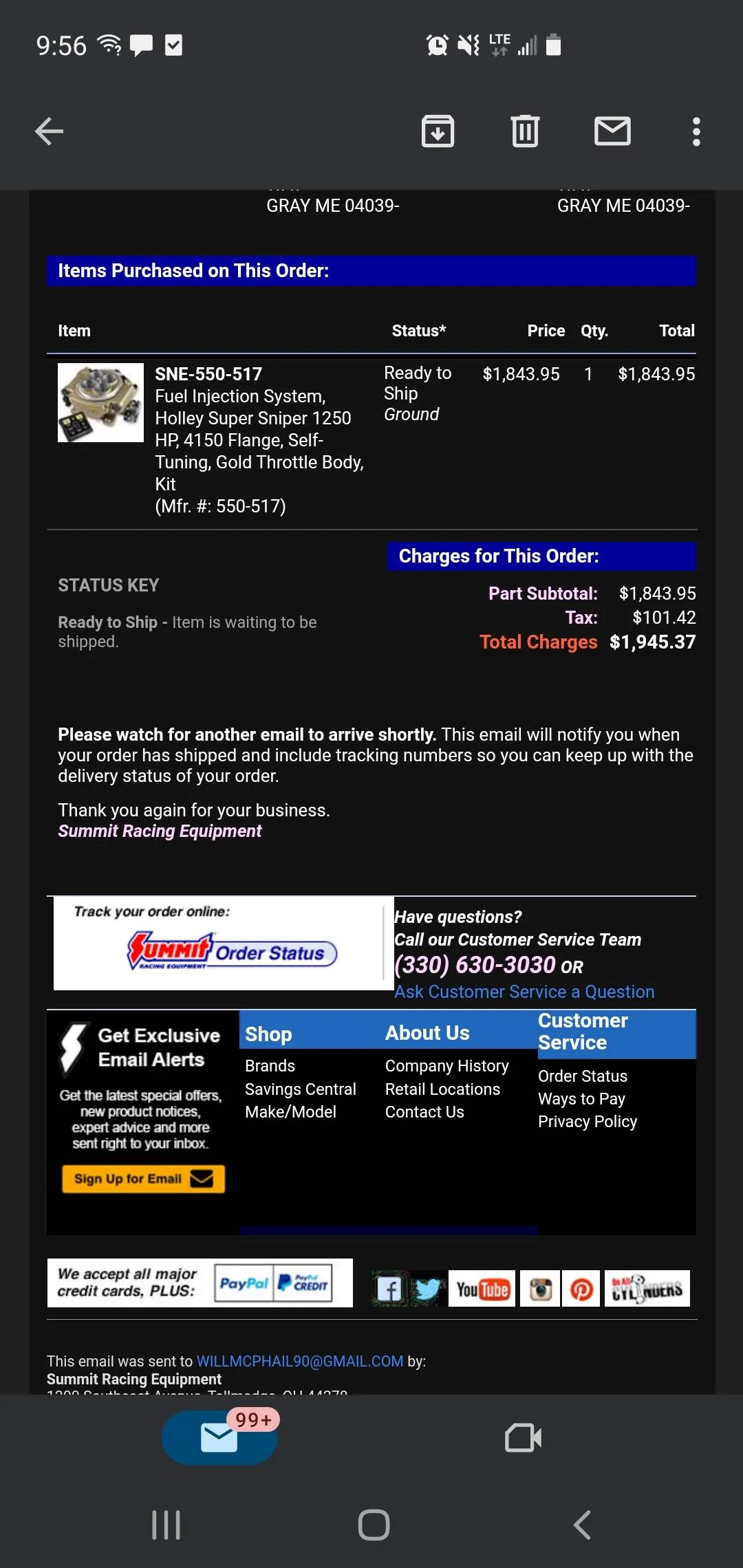

Probably more I'm forgetting. Some of the parts were bought when I was still gonna go with the 305 and now need to be sold & different parts bought... the FITech carb and converter mostly. I'm going to buy the 1200hp holley sniper carb setup and I'm thinking a converter In the 3800 range will do for now.
