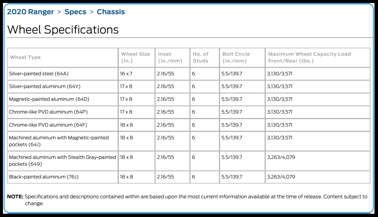

Is it 17x9 or 17x8? I was under the impression they were 17x9's. Looking for a "full size" spare I see only 17x8's and comments saying they only made 17x8's.

If you are talking about factory wheels they are 17x8 unless you are talking about the tremmor package. Thoes are 17x8.5.

I don't think I have any pkg.? Just a straight XLT Sport. So I guess they're 17x8's.
