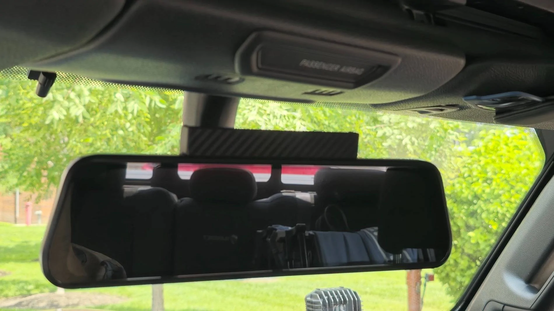

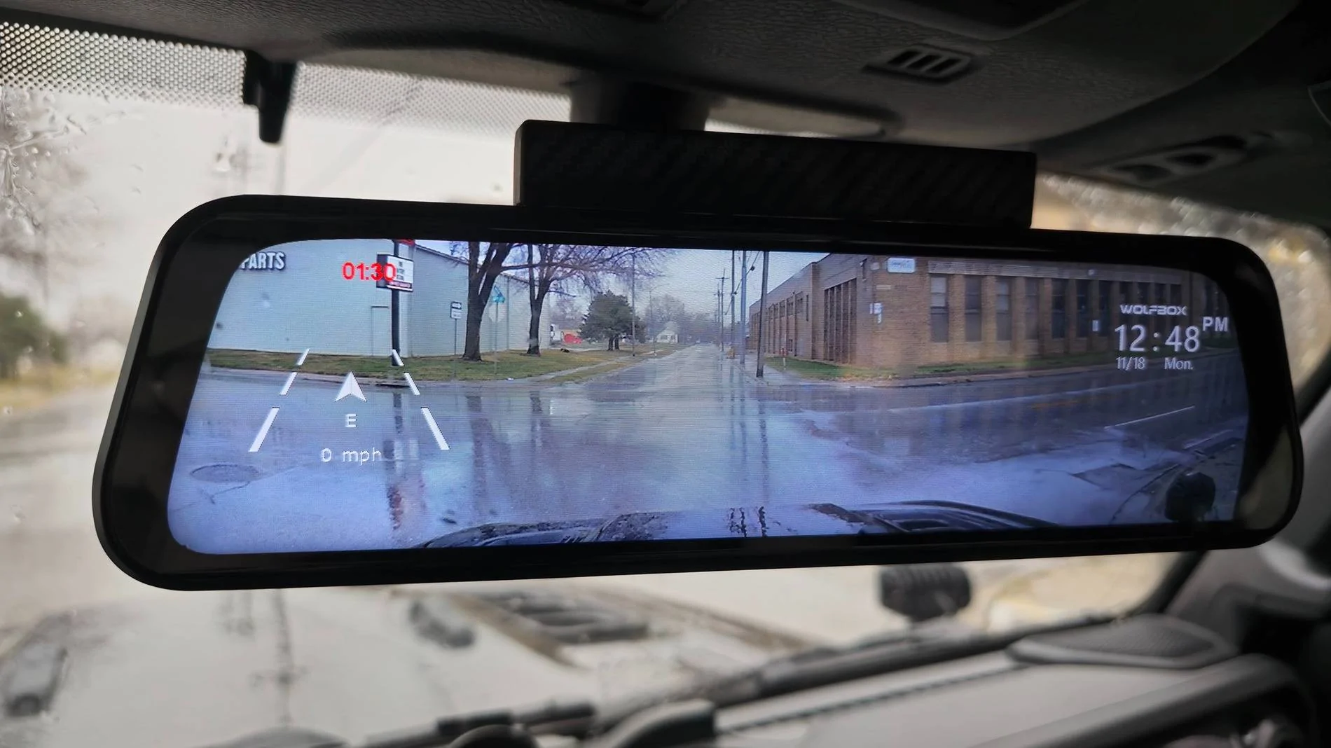

The member in our FB group installed a G930 dashcam system with a WDR upgraded rear camera in his vehicle, chosen for its 10” size matching the stock mirror. Mounted with the OEM mirror mount, he used a 33-foot cable for the rear camera and replaced the 32GB SD card with a 256GB card, allowing videos to last 6–7 weeks before overwriting. The rear camera is used solely for recording, as the OEM tailgate camera handles reversing.

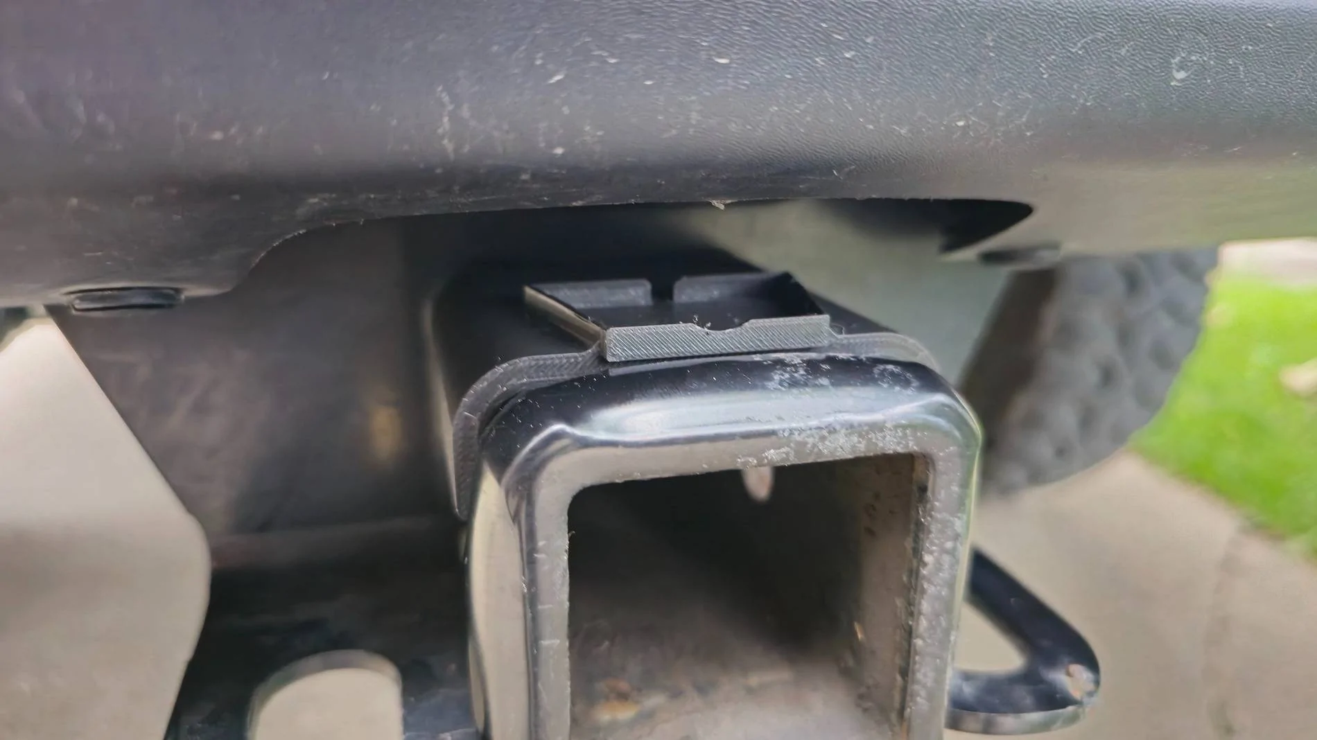

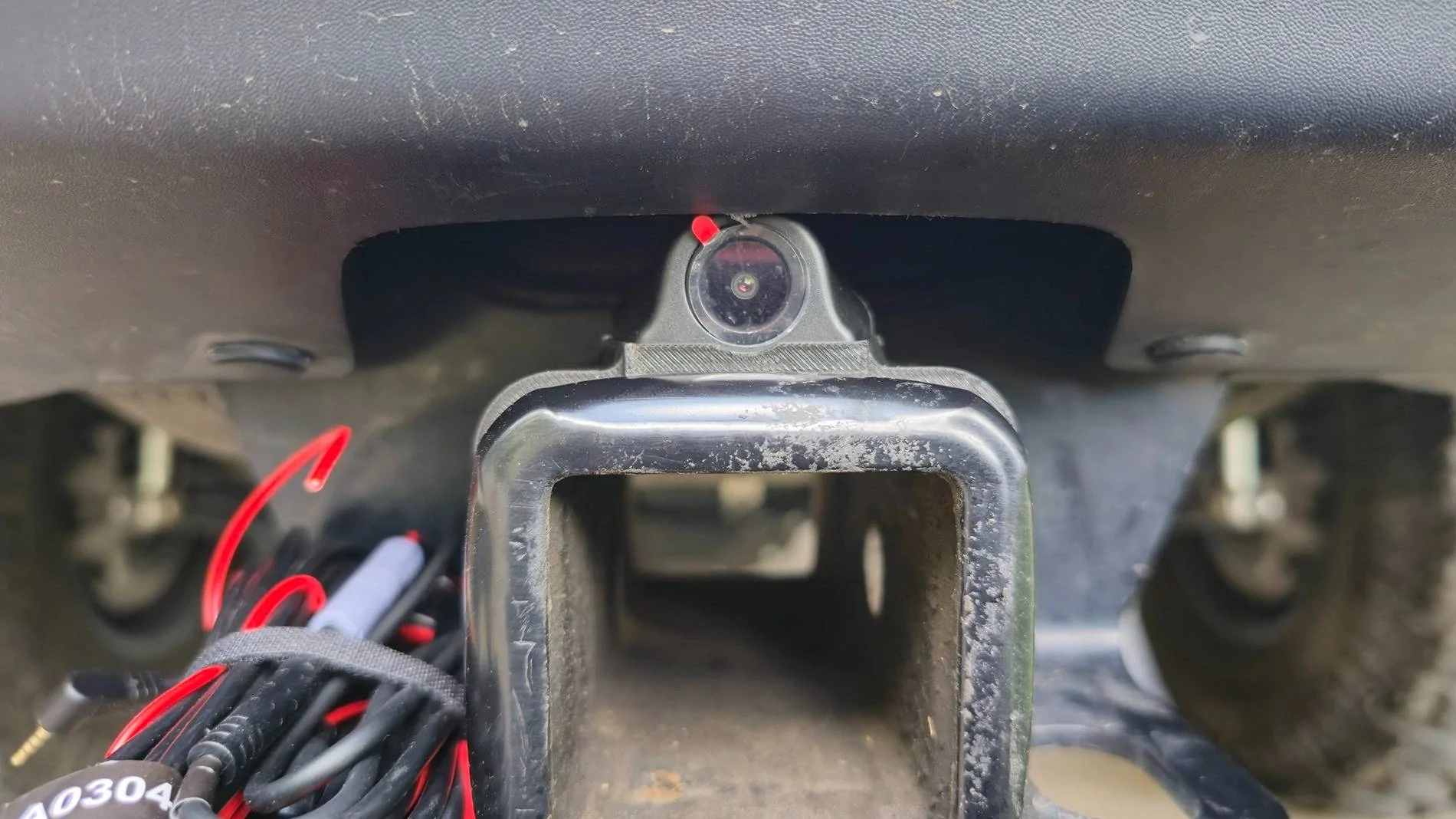

What's more, he 3D-printed a custom wire cover and rear camera mount, which function perfectly. Overall, the setup is clean, functional, and highly satisfactory. See the pics below.
