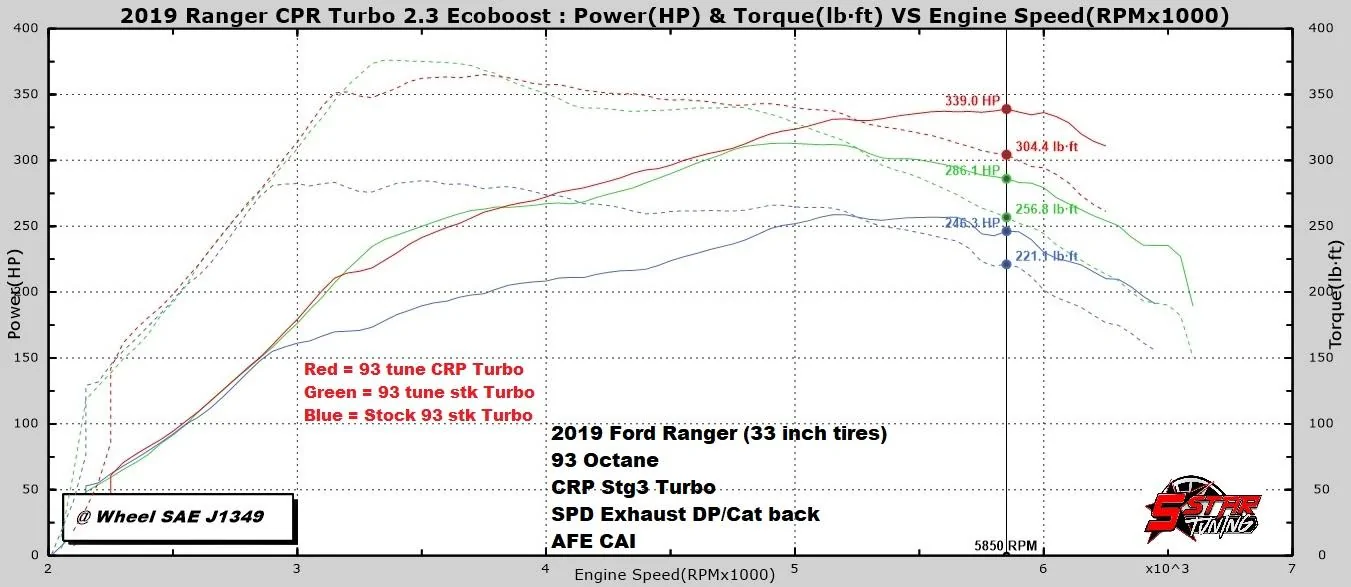

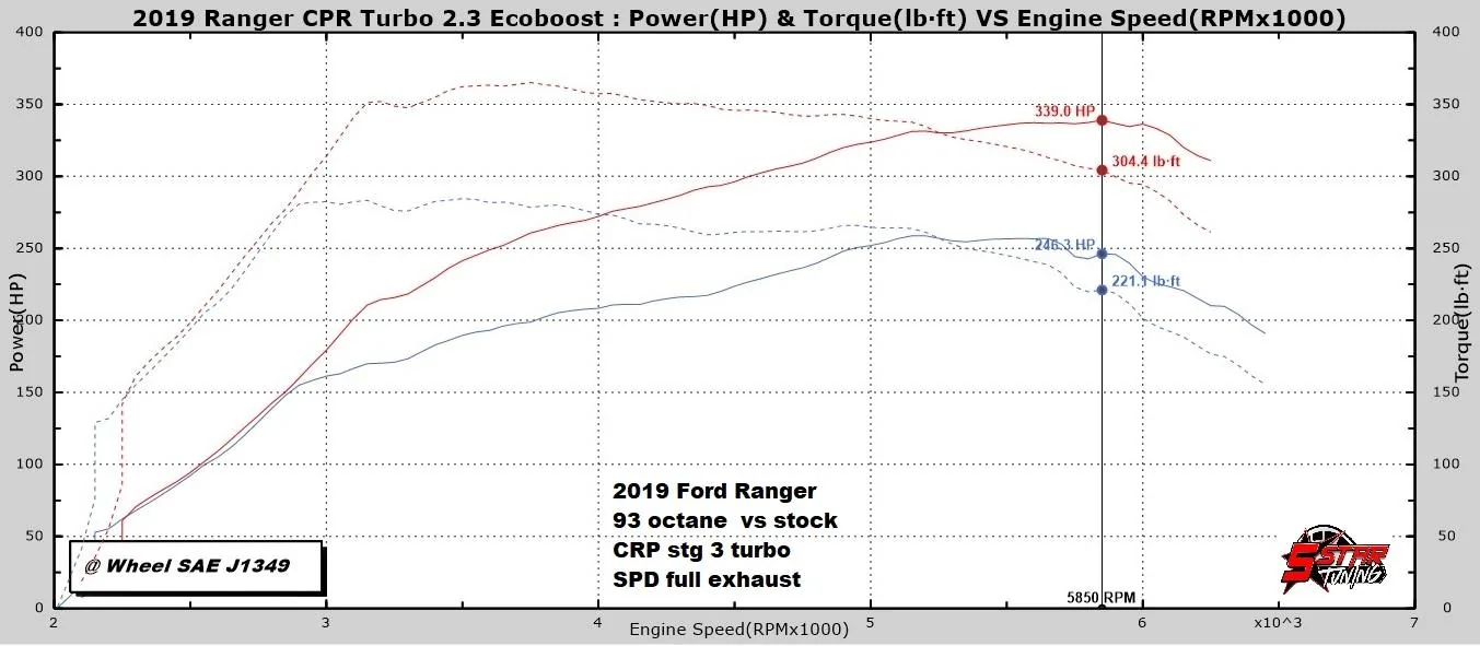

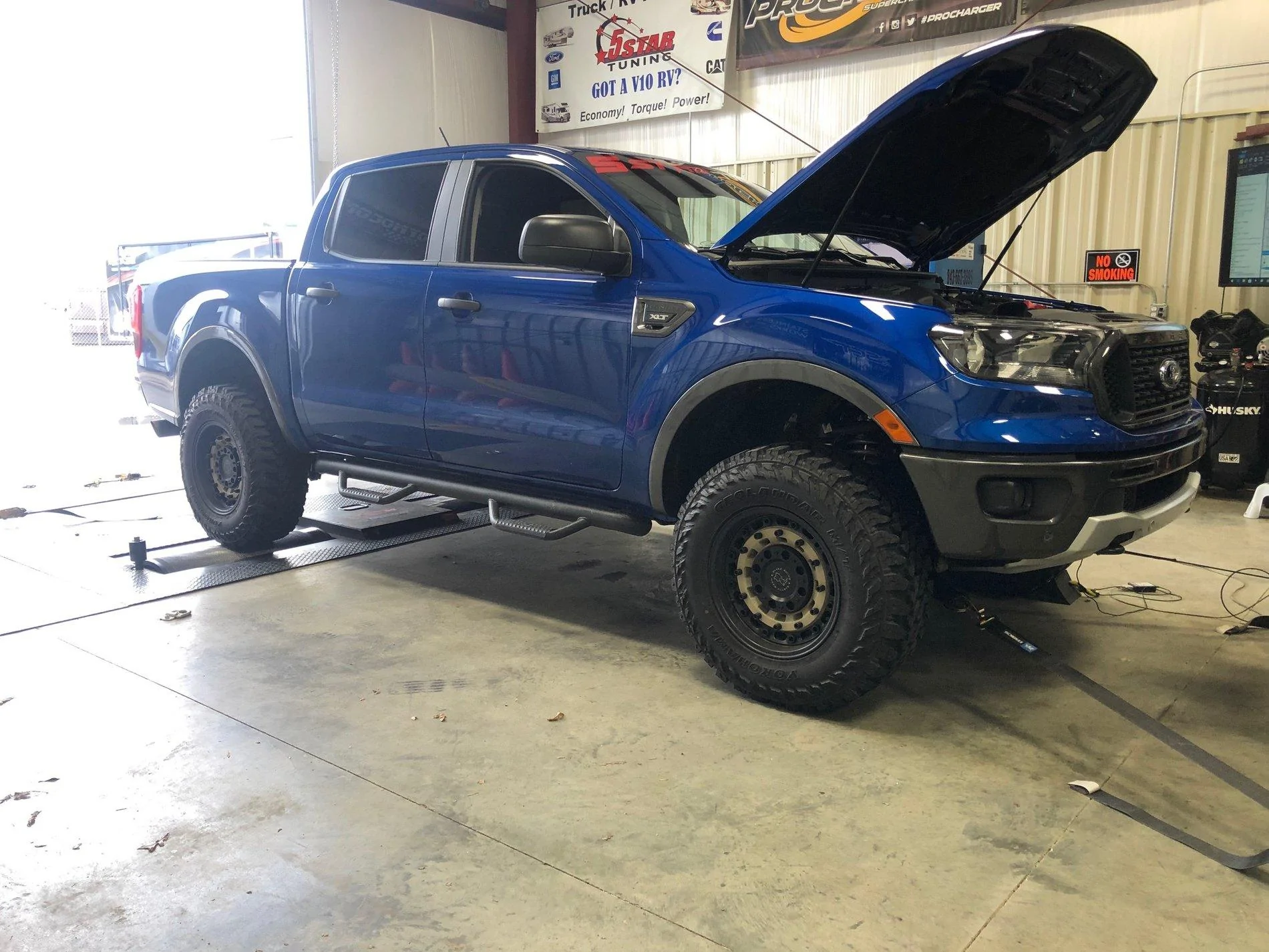

2019 Ford Ranger makes 339 HP on just 93 octane rolling 33 inch mud tires. CRP Performance Stg3 Turbos and complete SPD exhaust system! See the Torque curve carry and the HP carry to 5800 RPMs . Next up E30/E50 in a few weeks! Our goal is wheel 400 torque and 400 horsepower . Maybe ? Maybe Not ? should be close.
Stay Tuned! I have pictures attached of 2 dyno comparisons. The first is stock tune and stock turbo compared to upgraded turbo and a 93 performance tune. Second chart compares the differences from stock truck - to 93 tuned - to 93 tuned with upgraded turbo.
