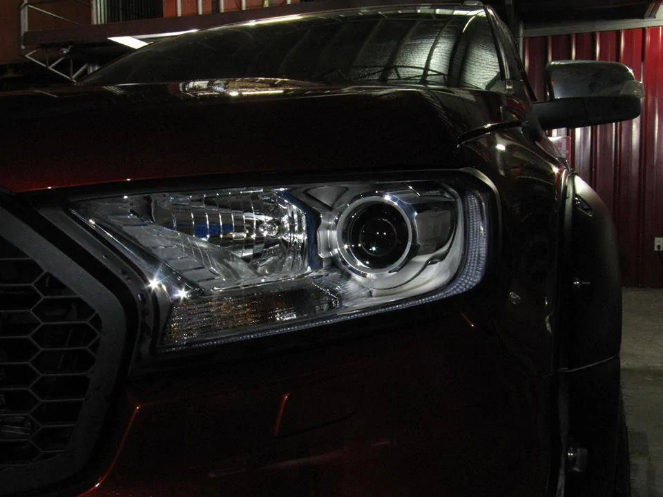

Wondering if any one has completed a HID projector retrofit on/with the stock halogen headlights?
I have seen a few post here and there but nothing really explaining the retrofit process. Any feedback would be awesome! (picture for attention/example)

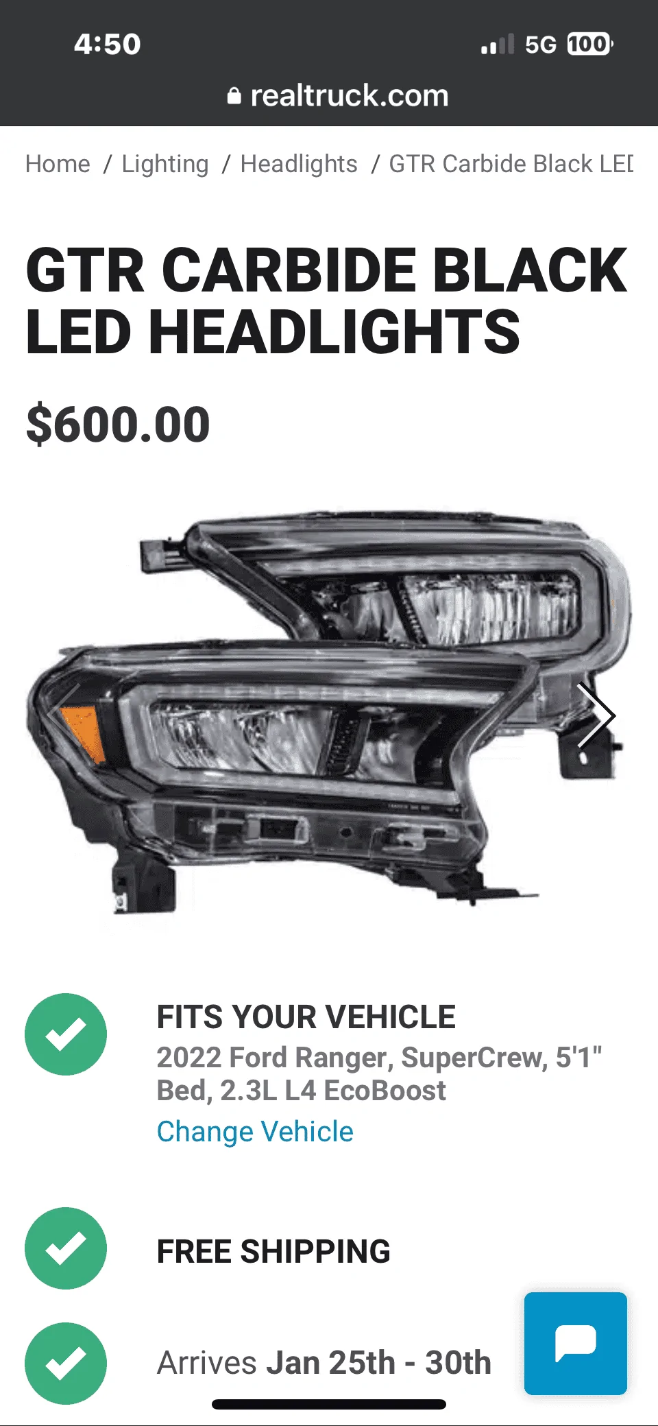

Nope I just bought LED lights I tried putting LED bulbs in but that wasn’t very bright these babies are beautiful

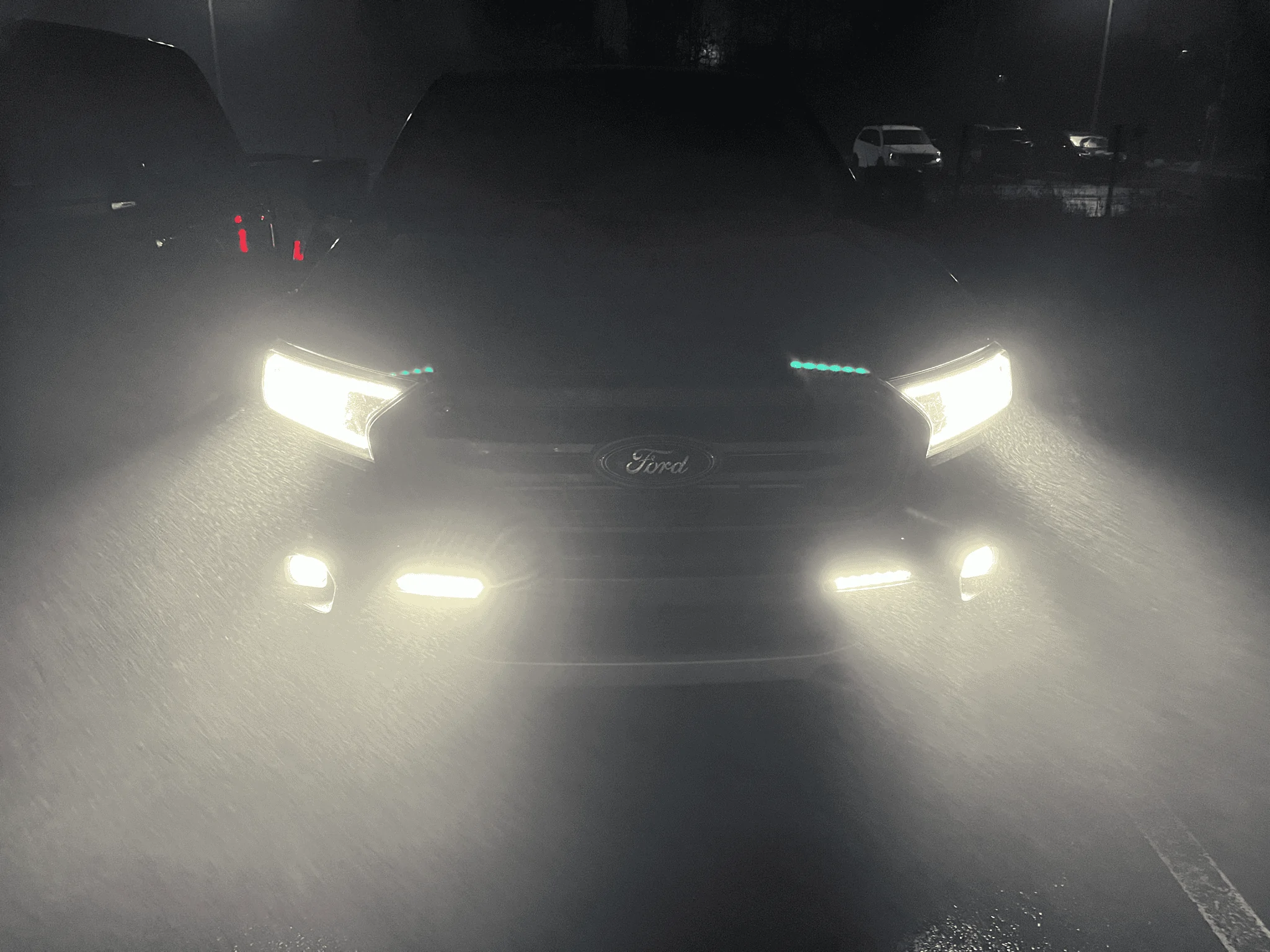

I had the LED delete from factory, Lariat. So, I made the truck as it was supposed to be and performed the swap myself, Halo's to Factory LED, Headlamps and Fog Lamps
HUGE difference over the Halo's
