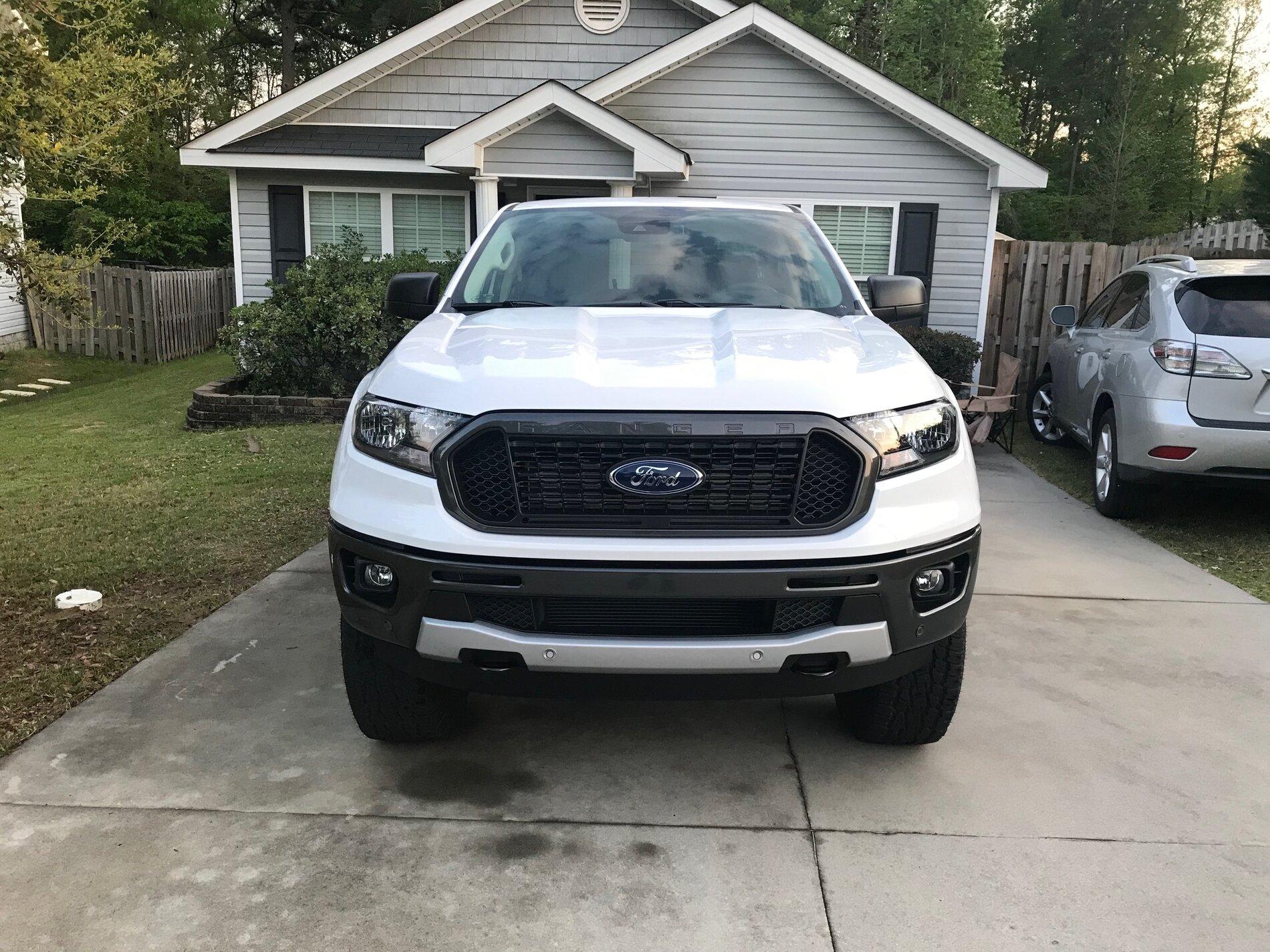

Some 33" tires will fit 17" factory wheels with a 2"+ lift with crash bars still on.
Some 33" tires will not.
Just saying "33 inch tires" doesn't amount to much, because the fact of the matter most people with 33" tires are either rounding up in the high 32's or rounding down in the low 33's. Each manufacturer has varying sizes.
I have Toyo Open Country AT2, 285/70/17 which I refer to as 33" tires. The truth of the matter is they are 32.7" tires.

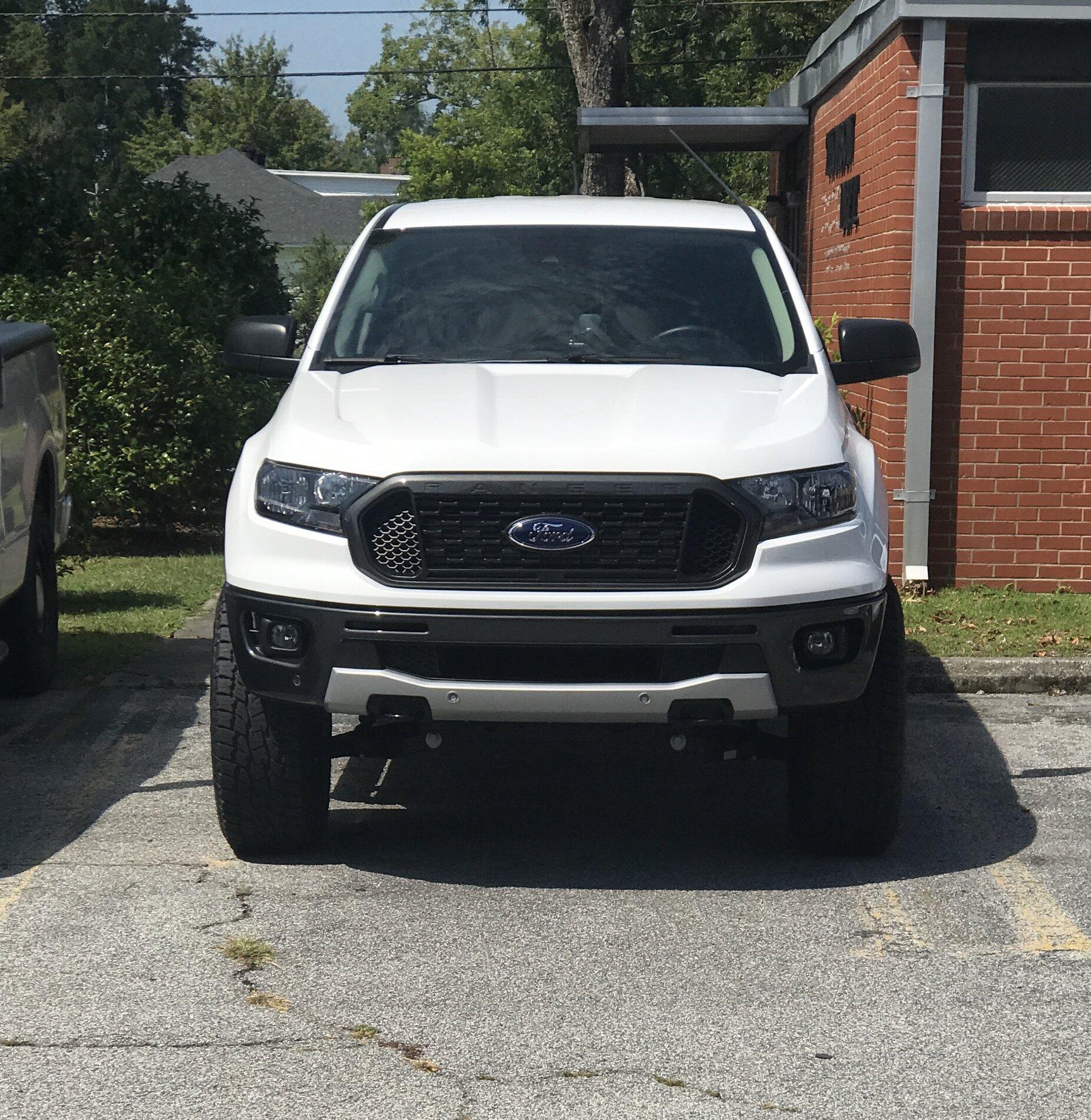

I can tell you my brand of tire will fit with 2"+ lift without having to to touch the crash bars with the factory 55+ offset. However your clearance is paper thin. Any move towards negative offset will require modification or removal of the bars.
When I added 2" wheel spacers it changed my offset to roughly 5+ and the bars had to be removed.
My truck from last year when I brought it home from the dealer (55+ offset), then after 2" spacers (+5 offset):
