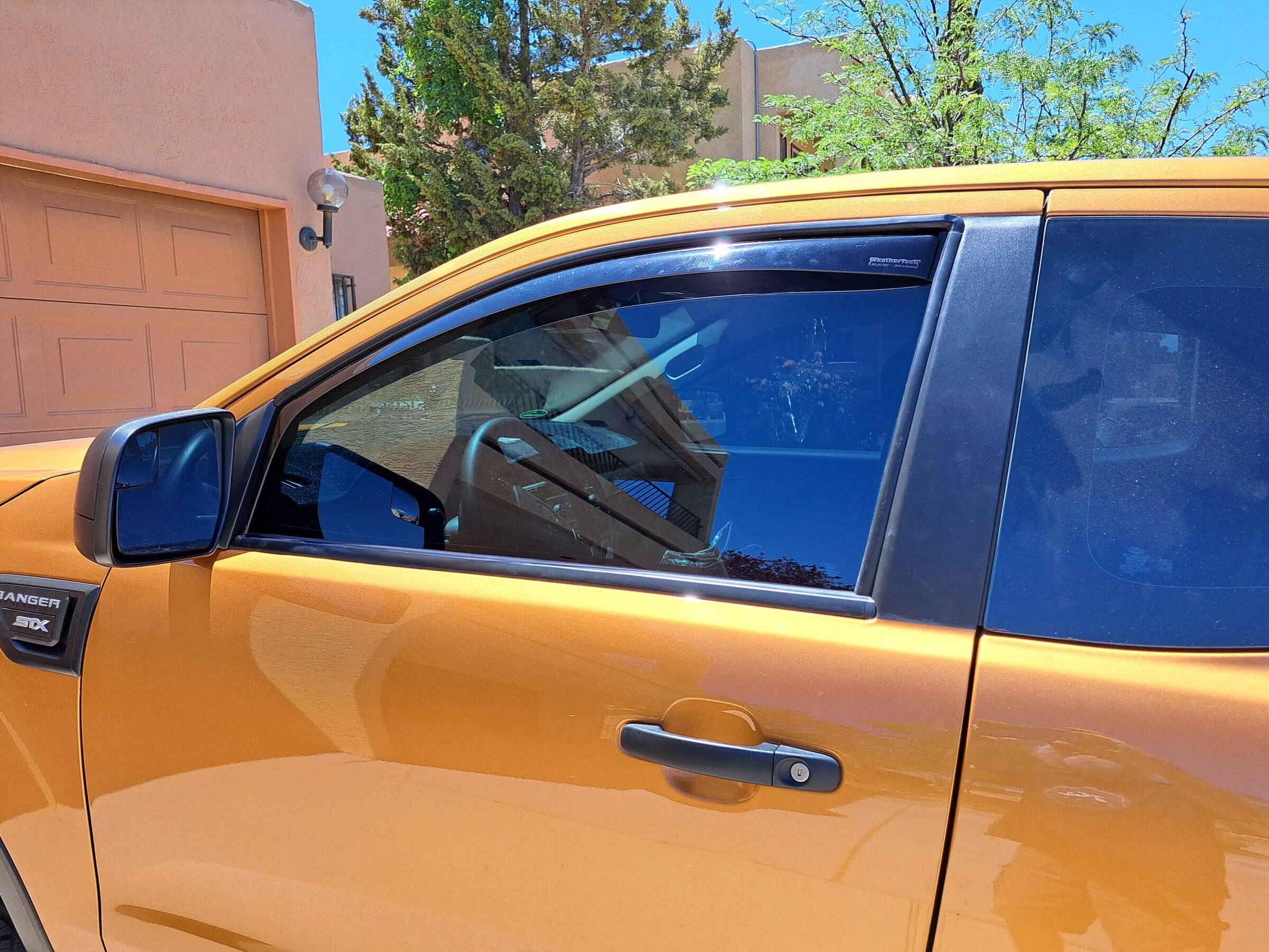

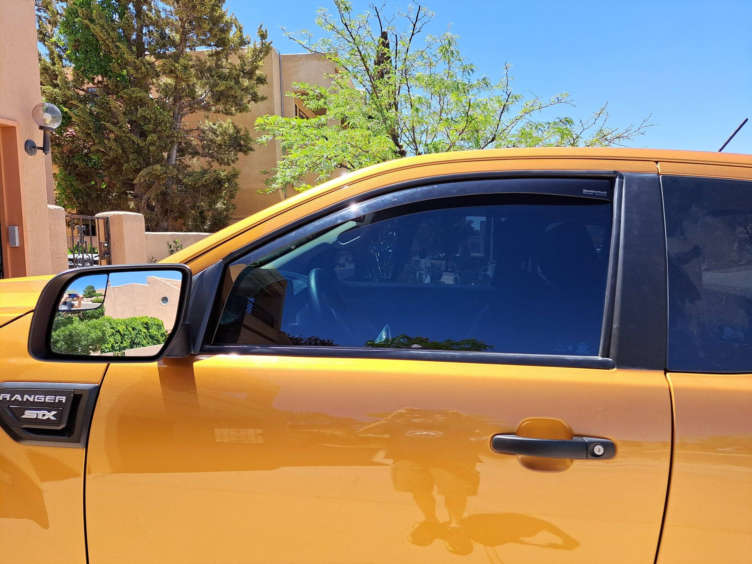

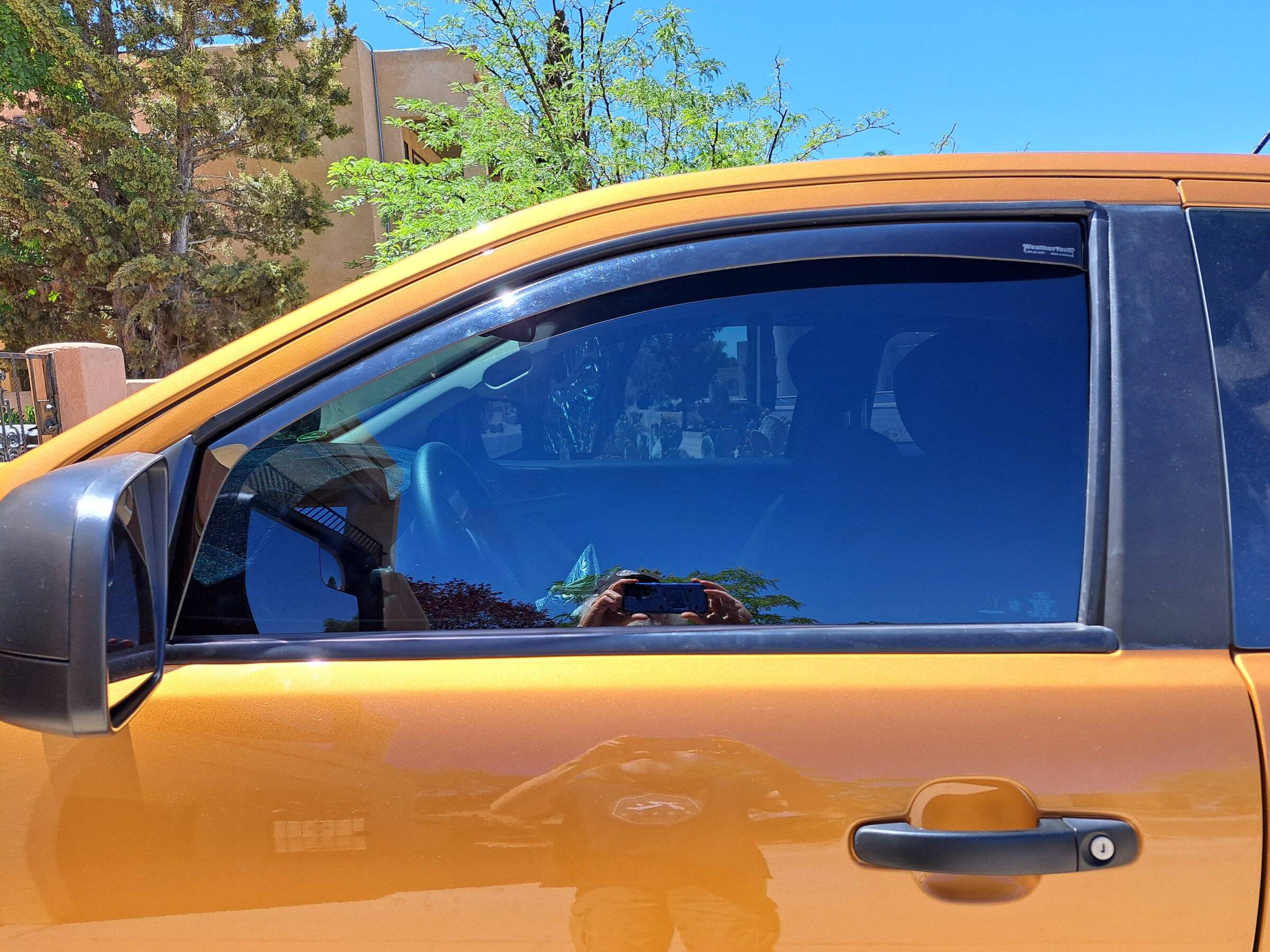

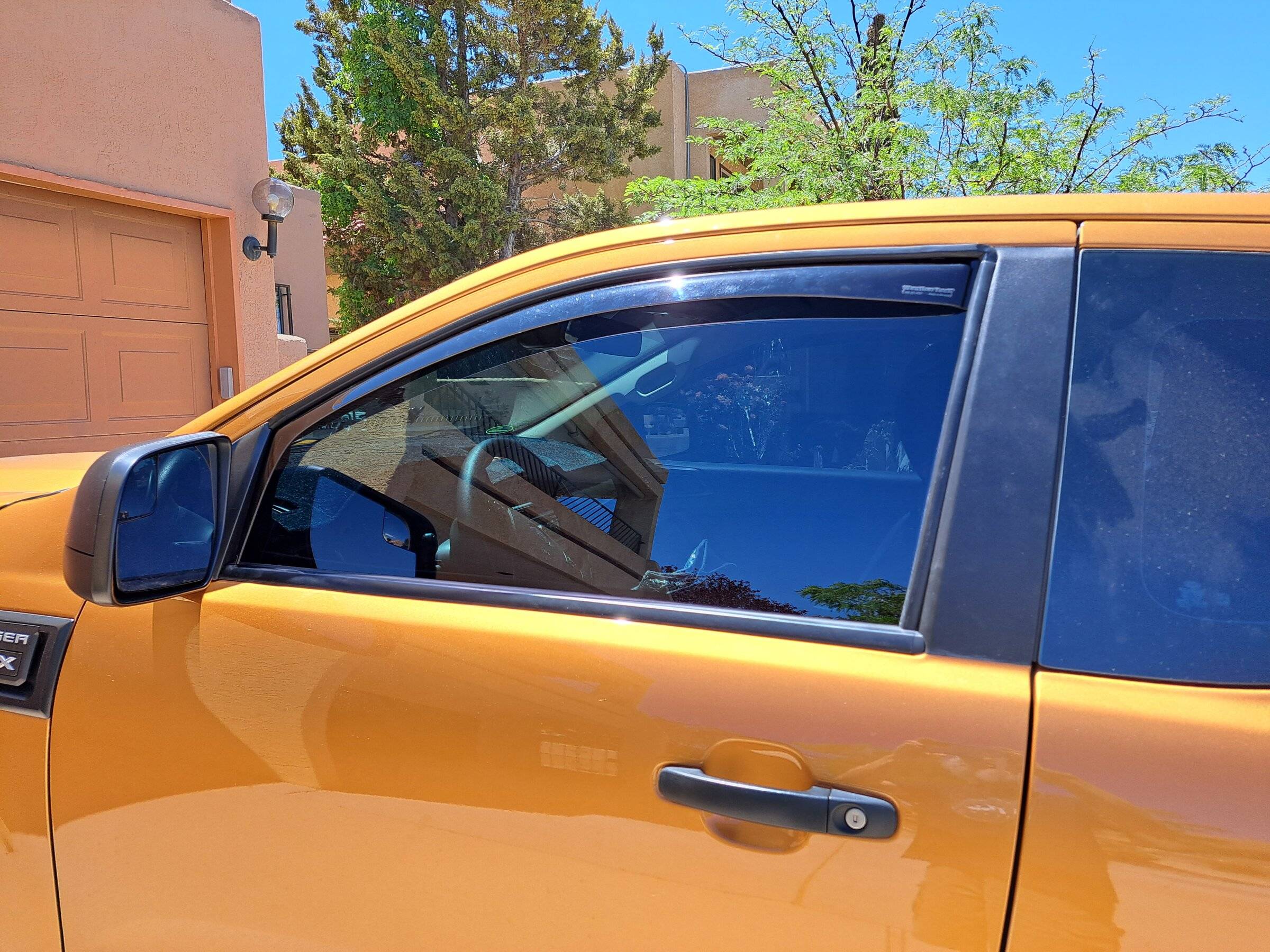

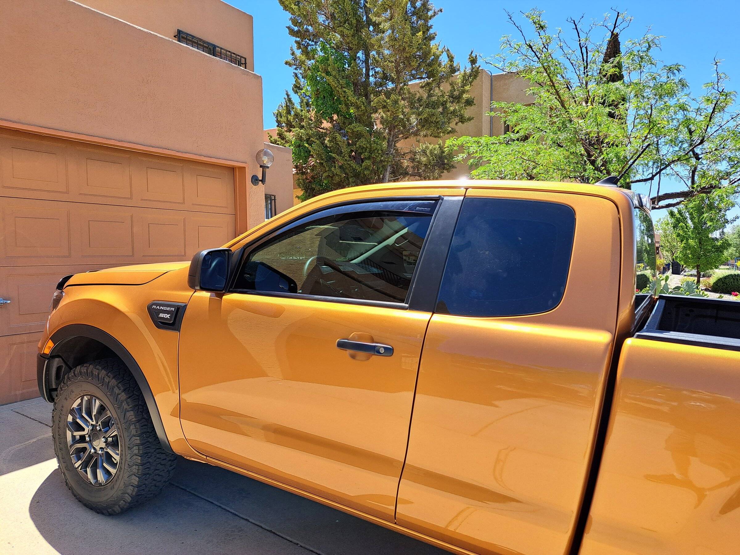

BettaRanga
Mar 25, 2022
633
1,812
NC
2021 Screw 4x4 Lariat 501a Blk App Carbonized Gray
Thanks Steve,
Thats what I suspected about the window operation.
Got the broken driver's side deflector replacement and it installed OK. WeatherTech said it was not unusual for the bounce-back feature to engage right after installation so after resetting the drivers window according to their instructions its working perfectly. I really like these deflectors (their looks, quality and firm secure mounting) and am looking forward to testing them for wind noise improvement, etc. :)
Let us know! I love the look but not sure about usefulness/worth.

Those look great. We had WeatherTechs on our '94 ZJ. Leaving the window cracked open while parked reduces internal temps.
Looking forward to your report on noise.
Our SCab Lariat passenger window is only manual up/down.
Will let you know the results :)

They look good!
