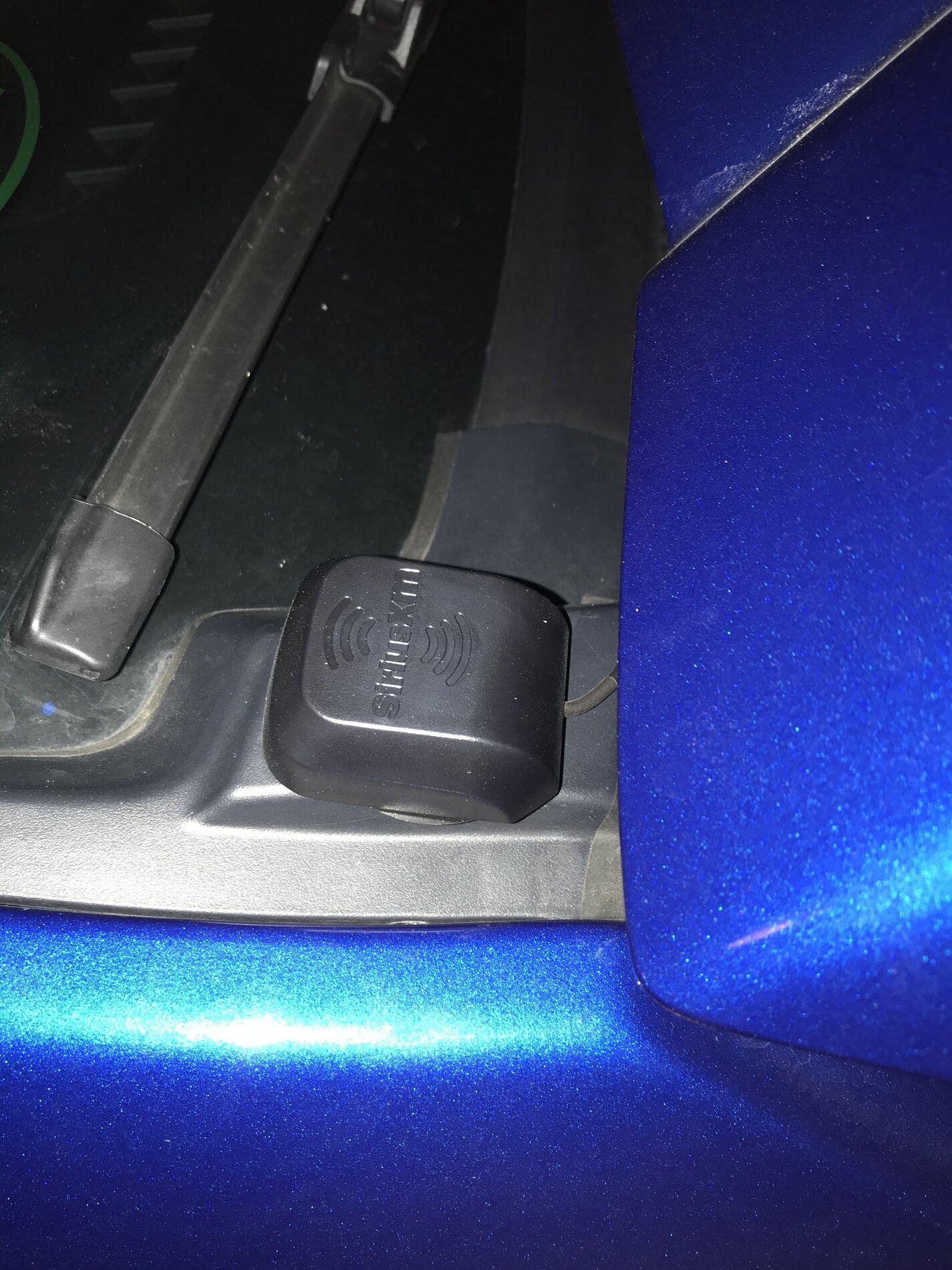

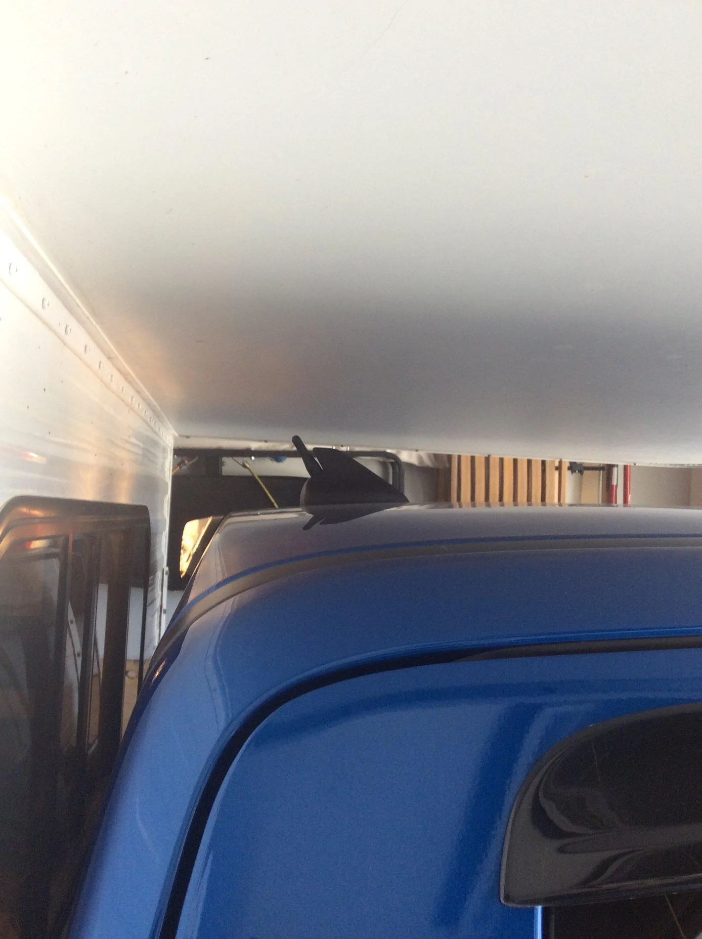

Pure Sirius reception with camper mounted, thoughts on improvement
Rich
Rich
Feb 20, 2019
61
ABQ NM
Buel, Moto Guzzi, Z3, '19 Ranger xlt super cab blue

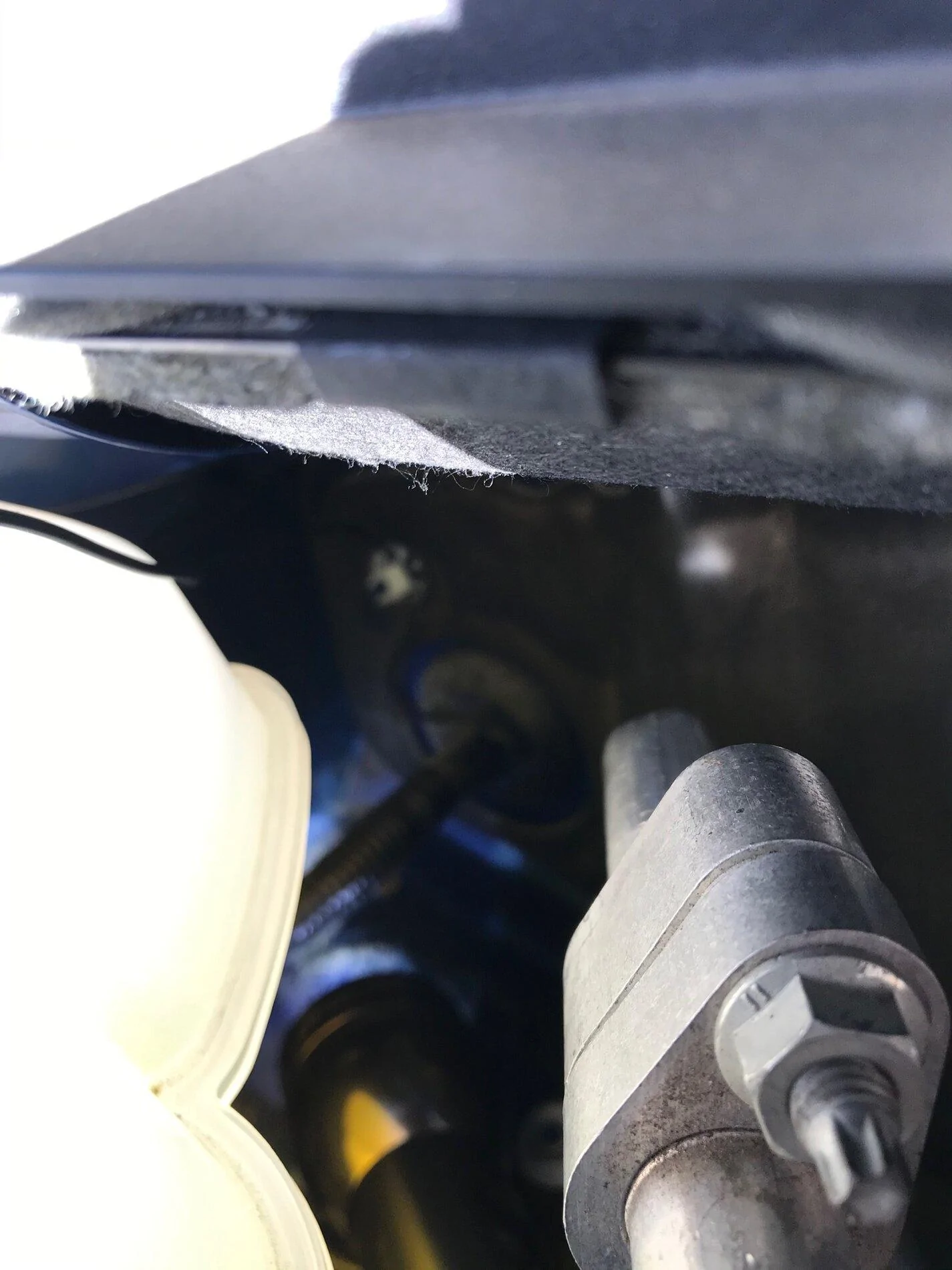

I thought maybe moving to the front as it is down under, this way it I only have to deal with head liner and drill new hole and plus the rear one.
Another way is to get to the back of the radio unplug the stock unit, mount a after market unto replace it.
Is there a booster of some kind that would be a plug and play.

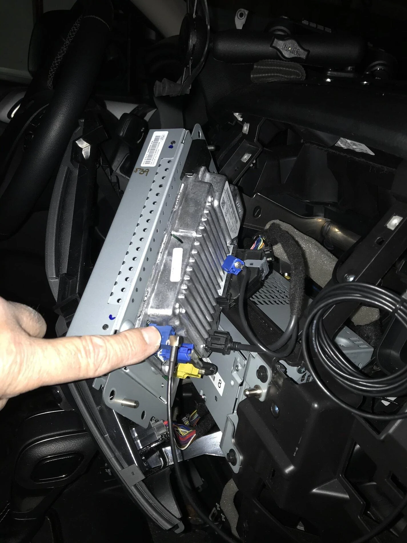

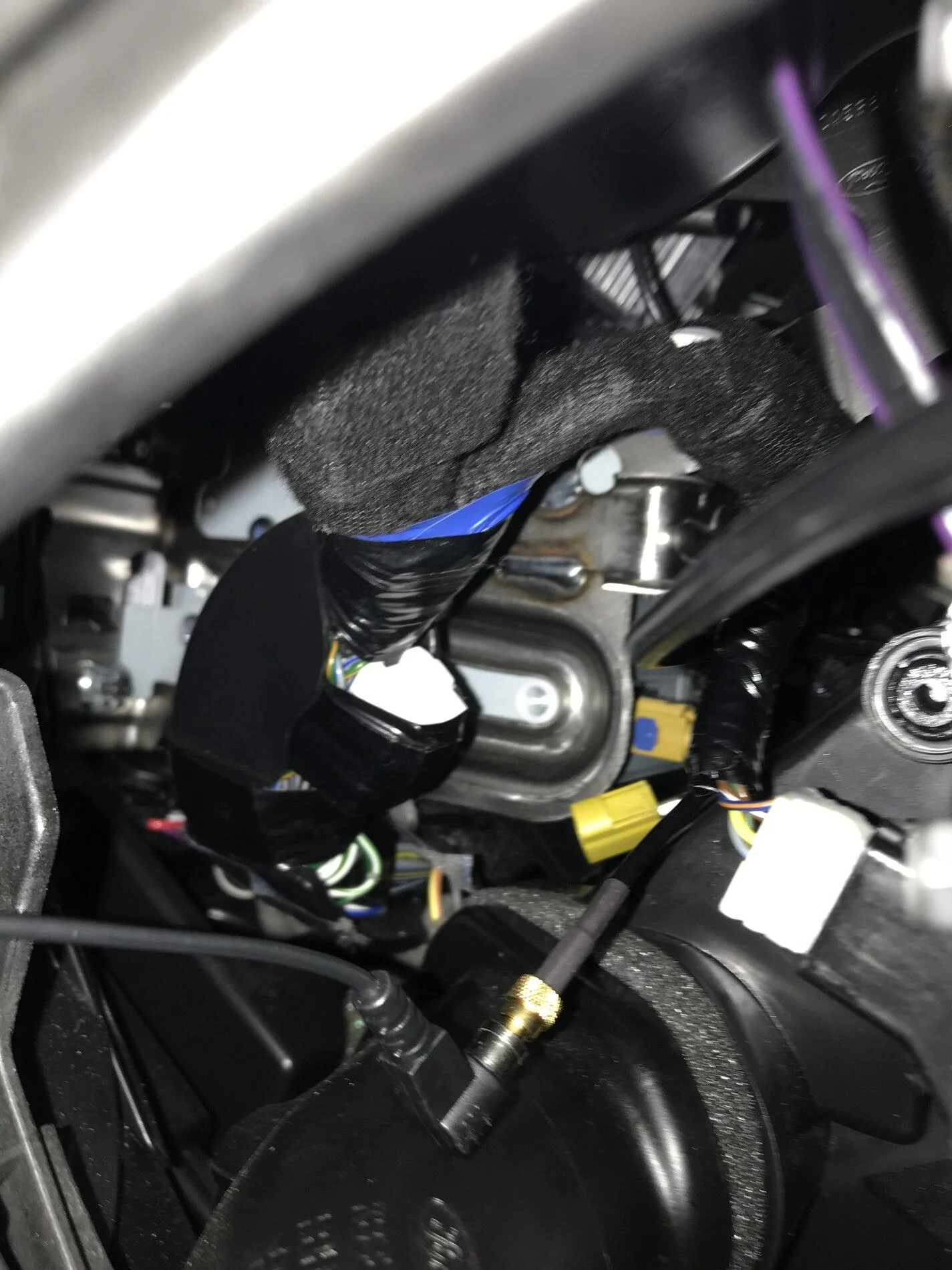

might not be that easy I just had a look at the service manual for the infotainment section because i was curious to how its wired and it might be more involved than that, here the thread for the manuals take a look yourself.
https://www.ranger5g.com/forum/threads/2019-ranger-technical-shop-manuals.1548/

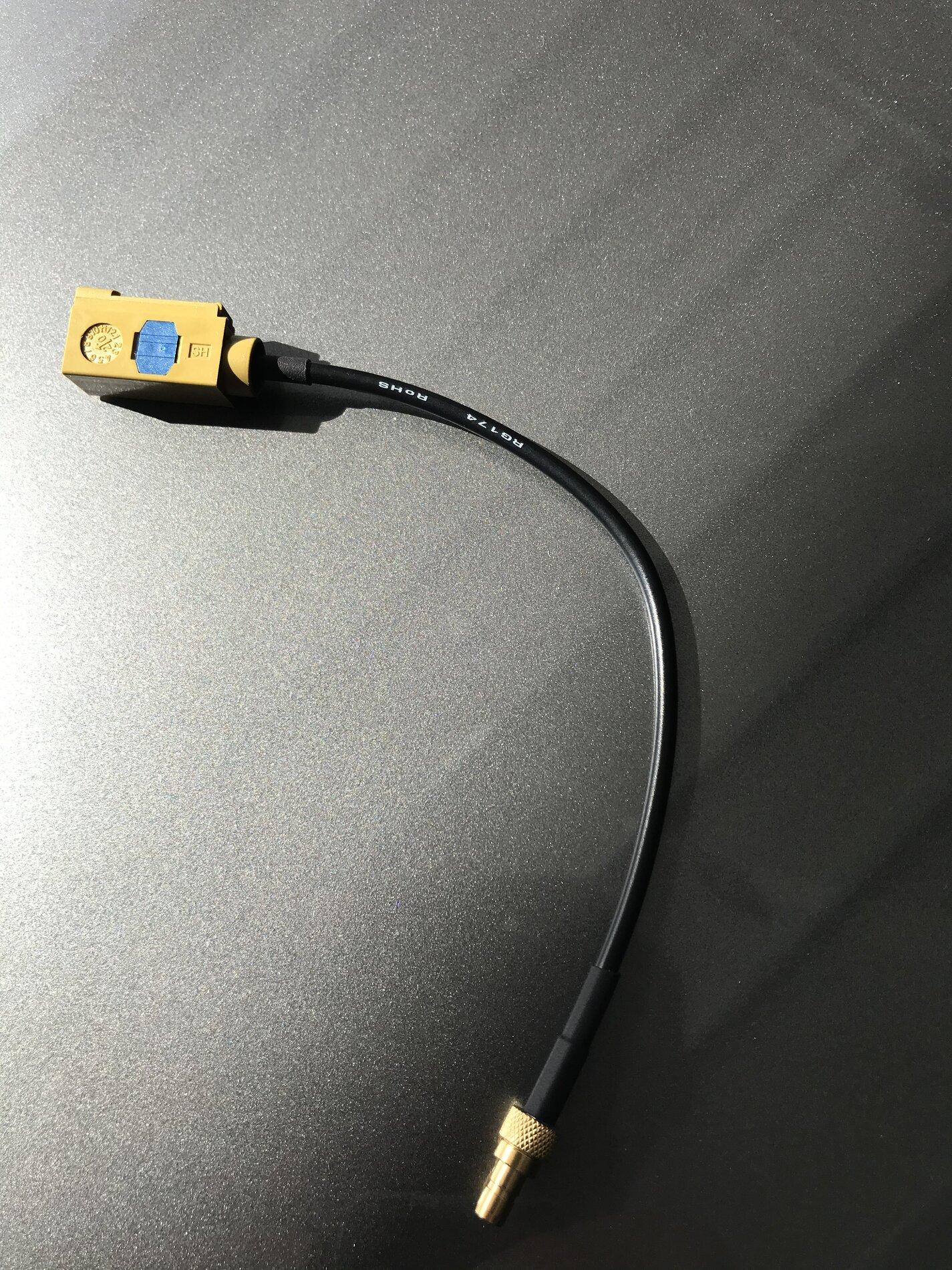

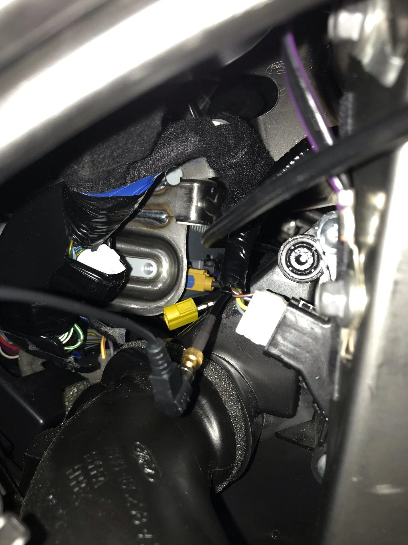

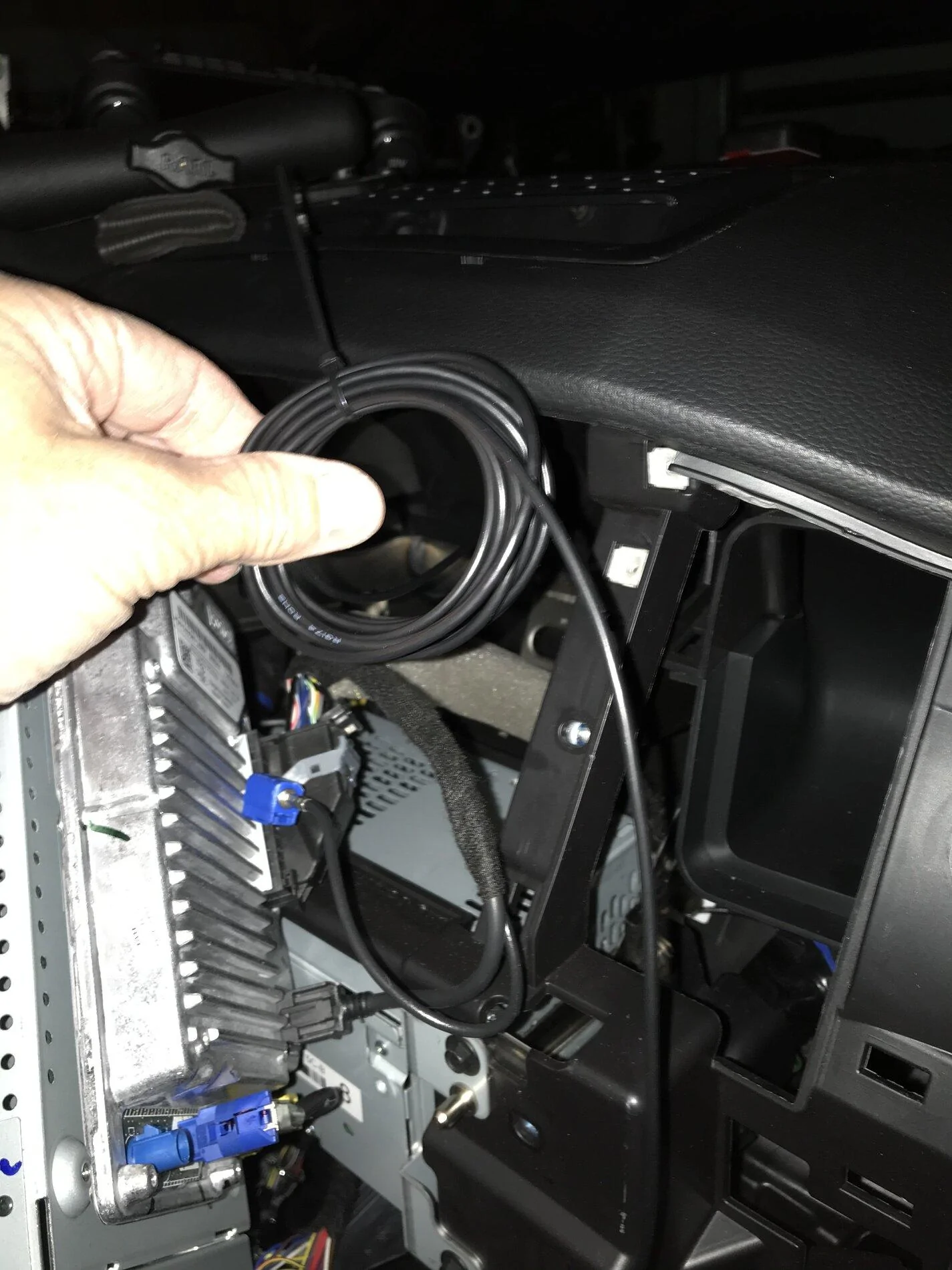

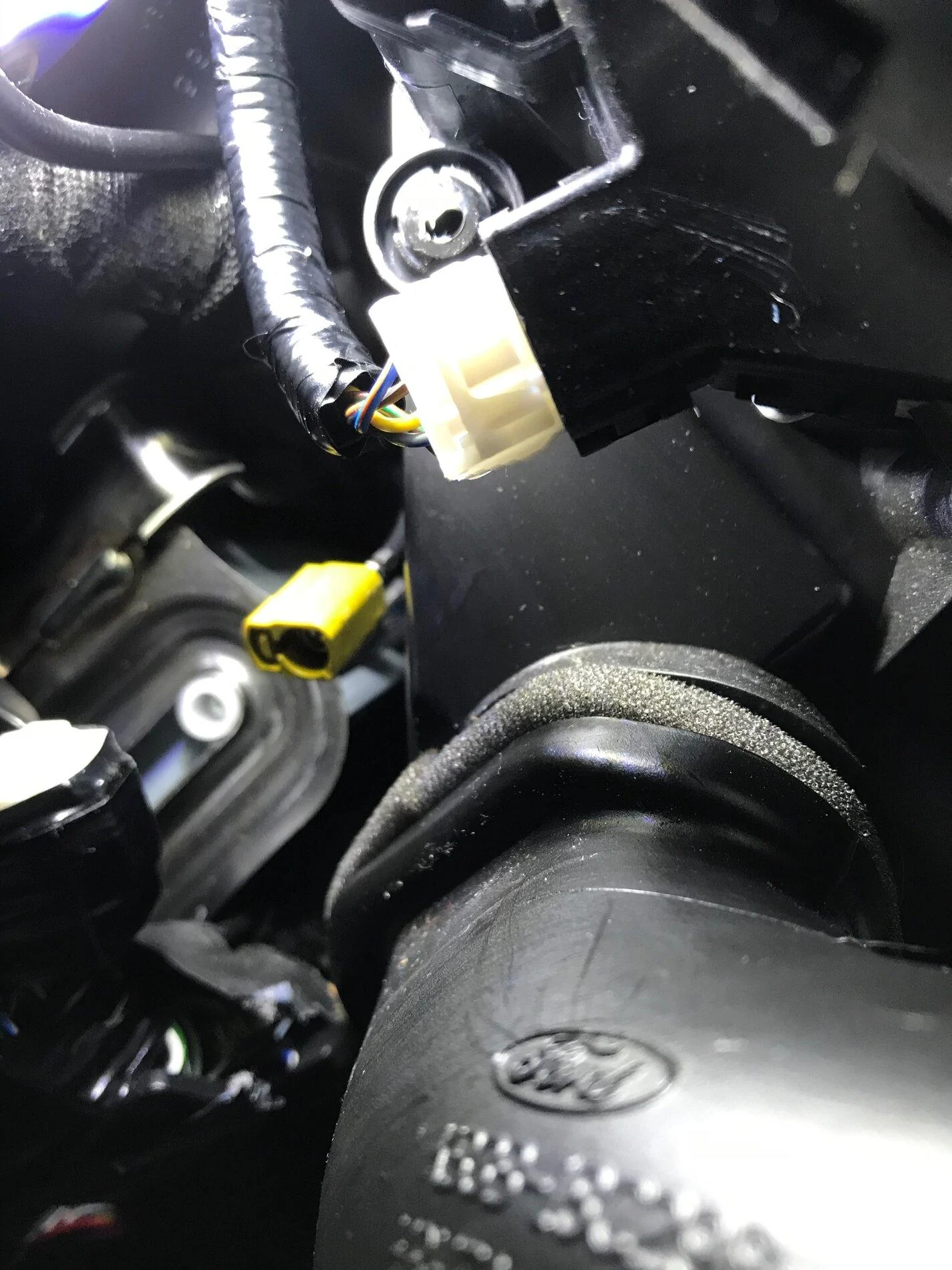

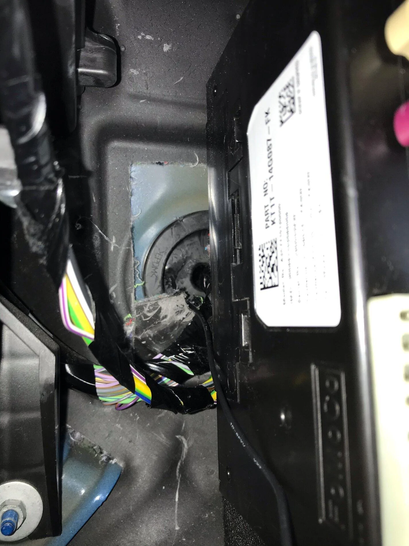

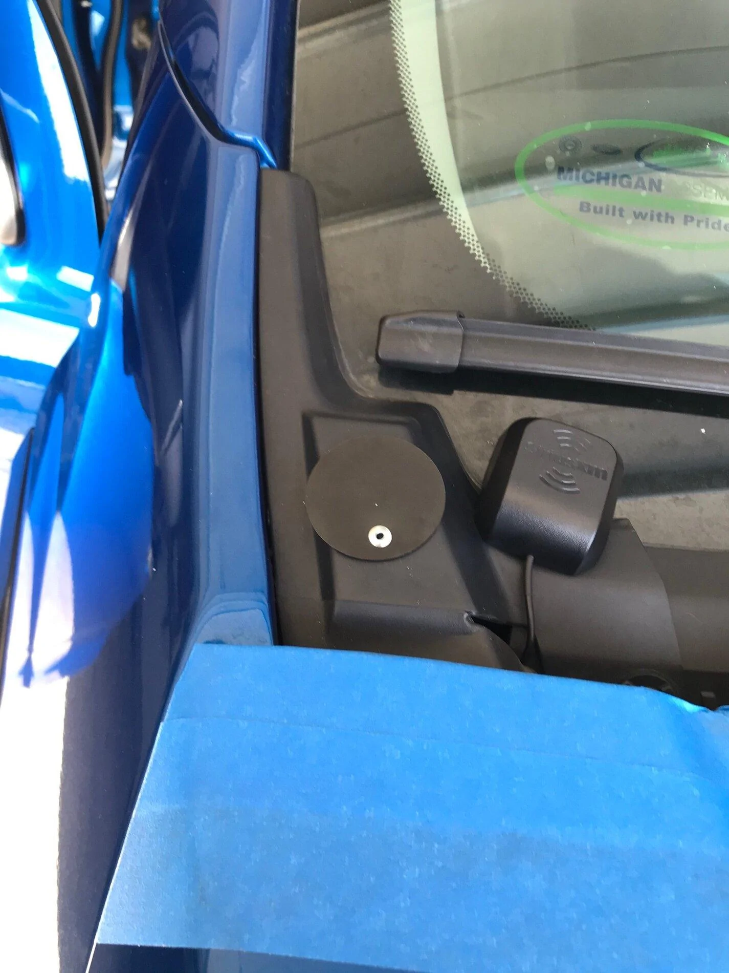

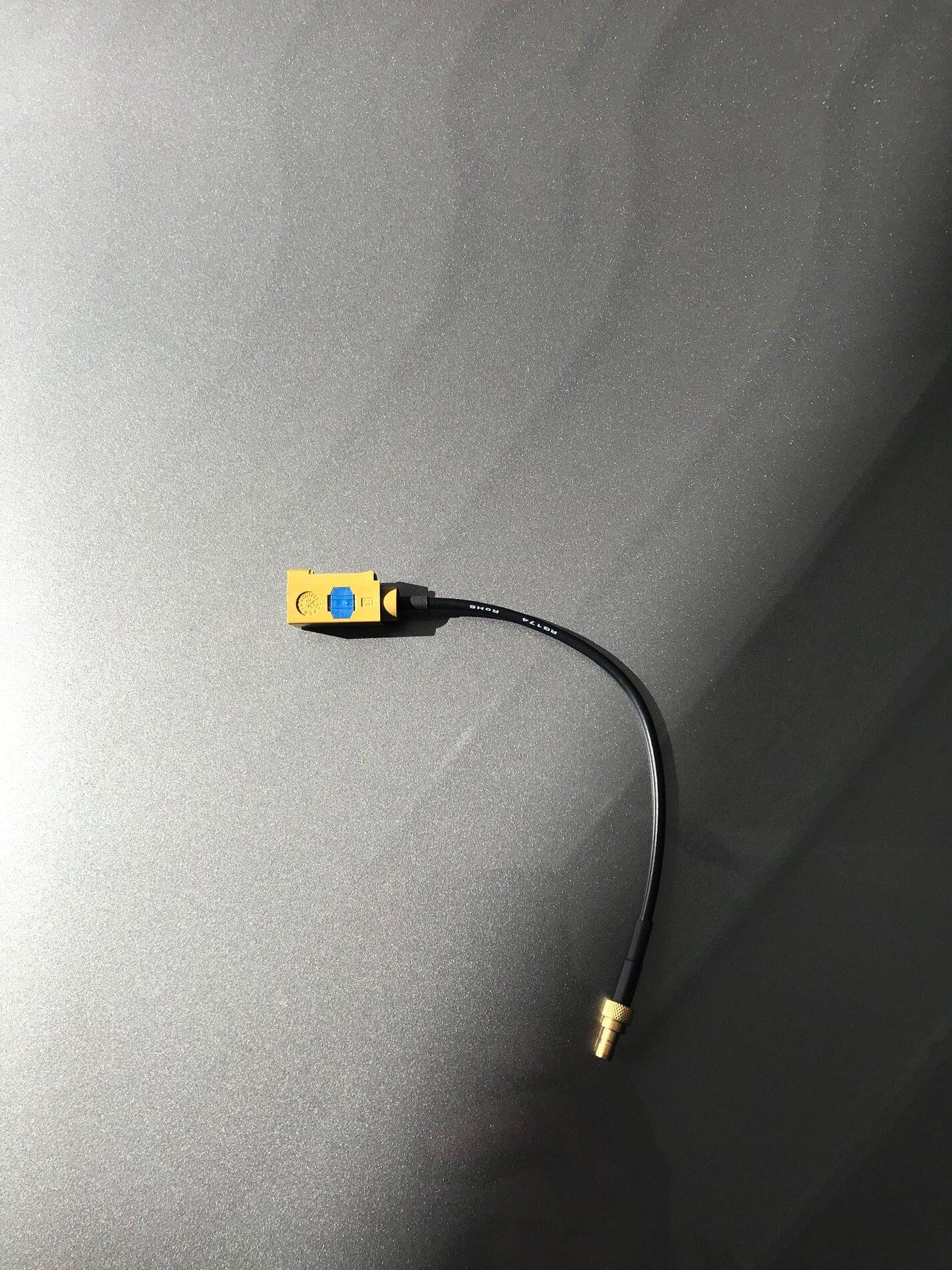

Those manuals were helpful. The antenna is part of the trucks harness but the Sirius unplugs separates from the back of the info center with access from the glove box. Replaced with a two piece kit from Amazon $30. Happy with my results. Thanks

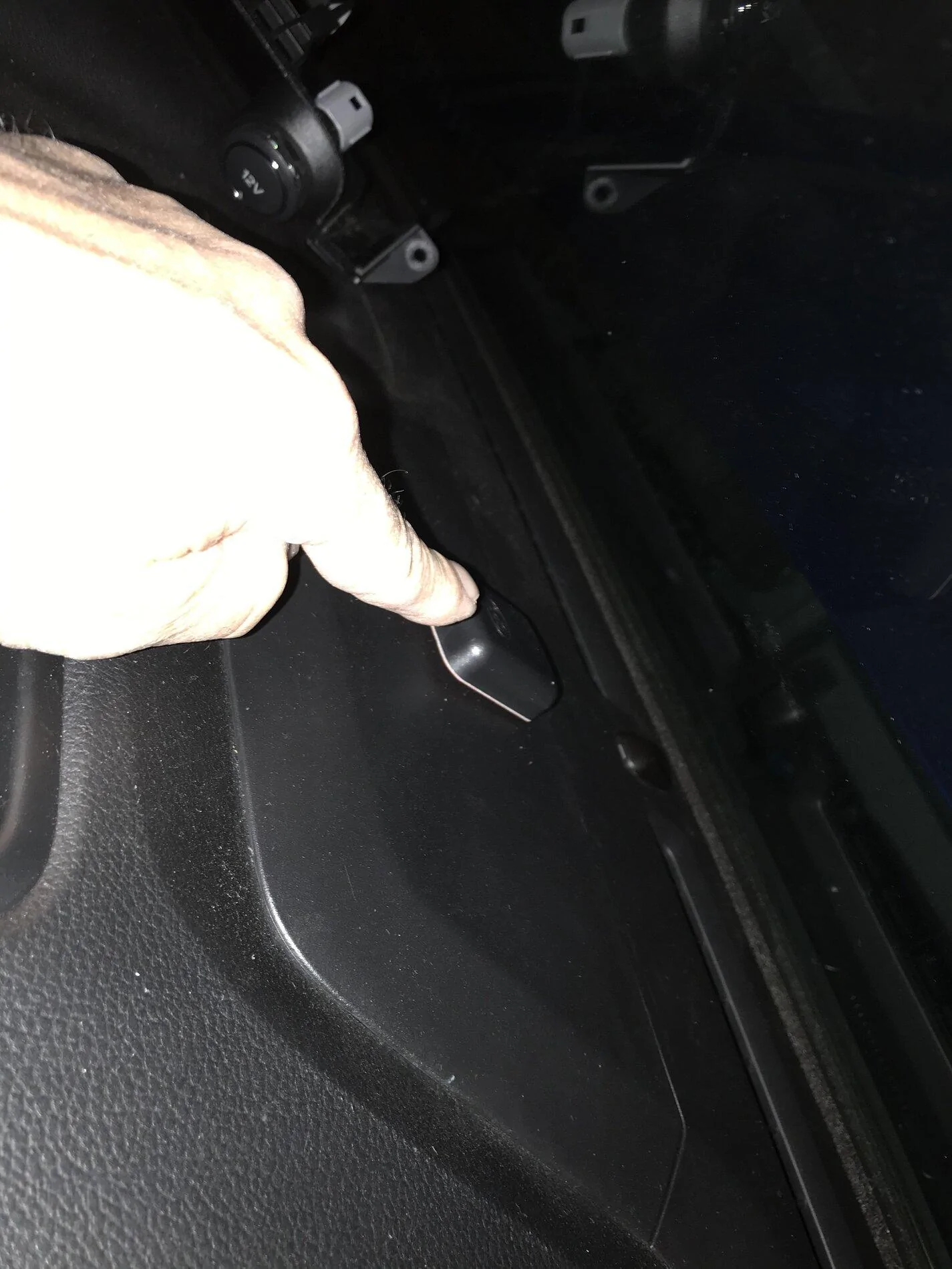

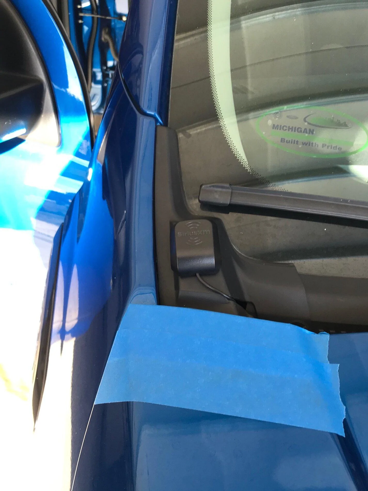

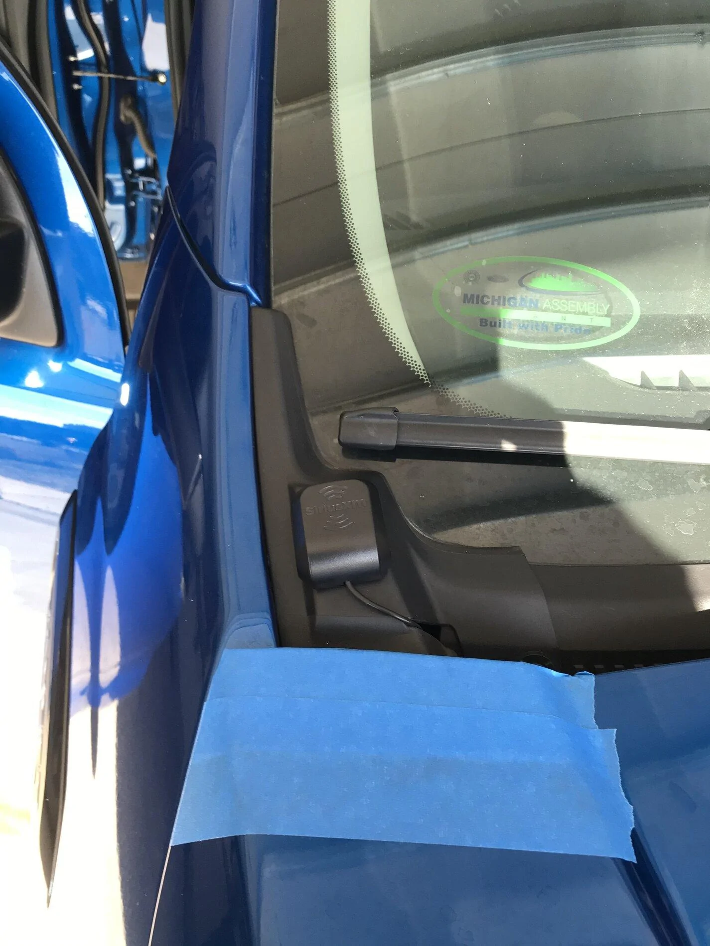

Took awhile to build the courage tote at into the dash of my new truck. Bought two antennas one for GPS one for Sirius radio. All’s well, no sparks or broken clips.
