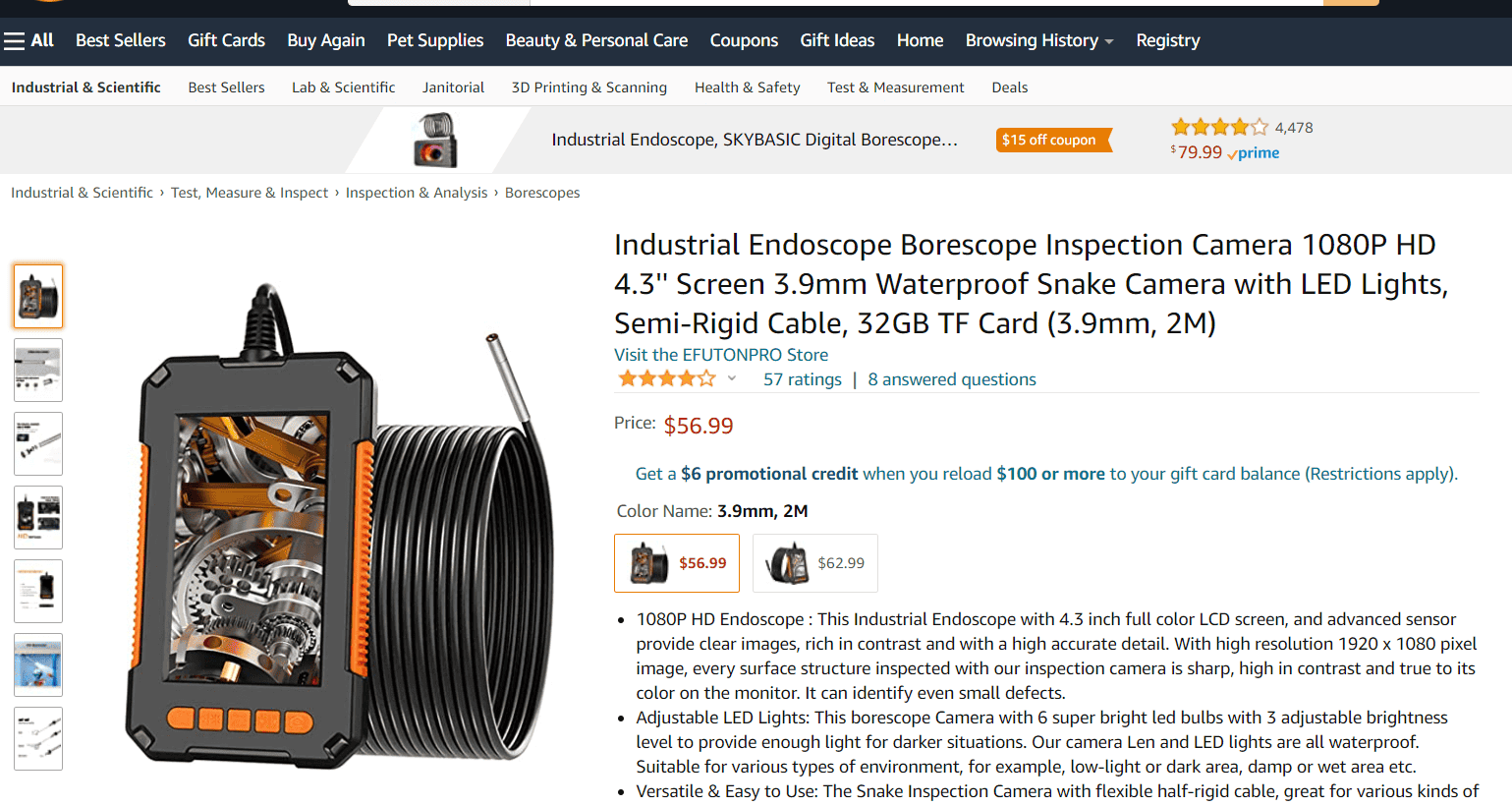

borescopes are pretty cheap these days.
buy one as well and probe the vents to see whats up.
afterwards, you're not a doctor, but you'll have a look anyways. work for beer money and save lives. perfect combo.

This is actually a good idea. I would gladly invest in borescope to help identify the problem. With the potential other uses … I have canceled my doctors appointment and ordered the borescope:oops:. Had no idea these could be purchased this cheap.
Thanks for the recommendation.
