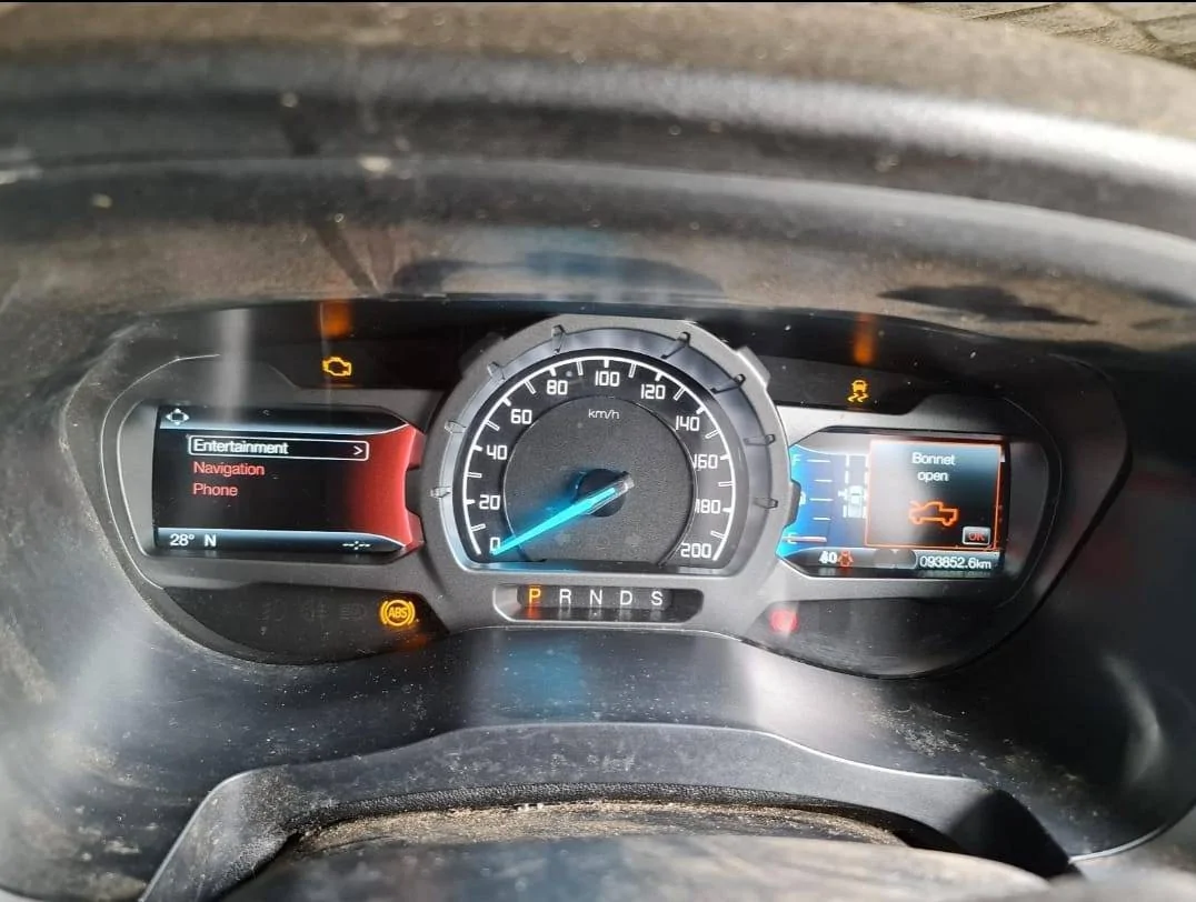

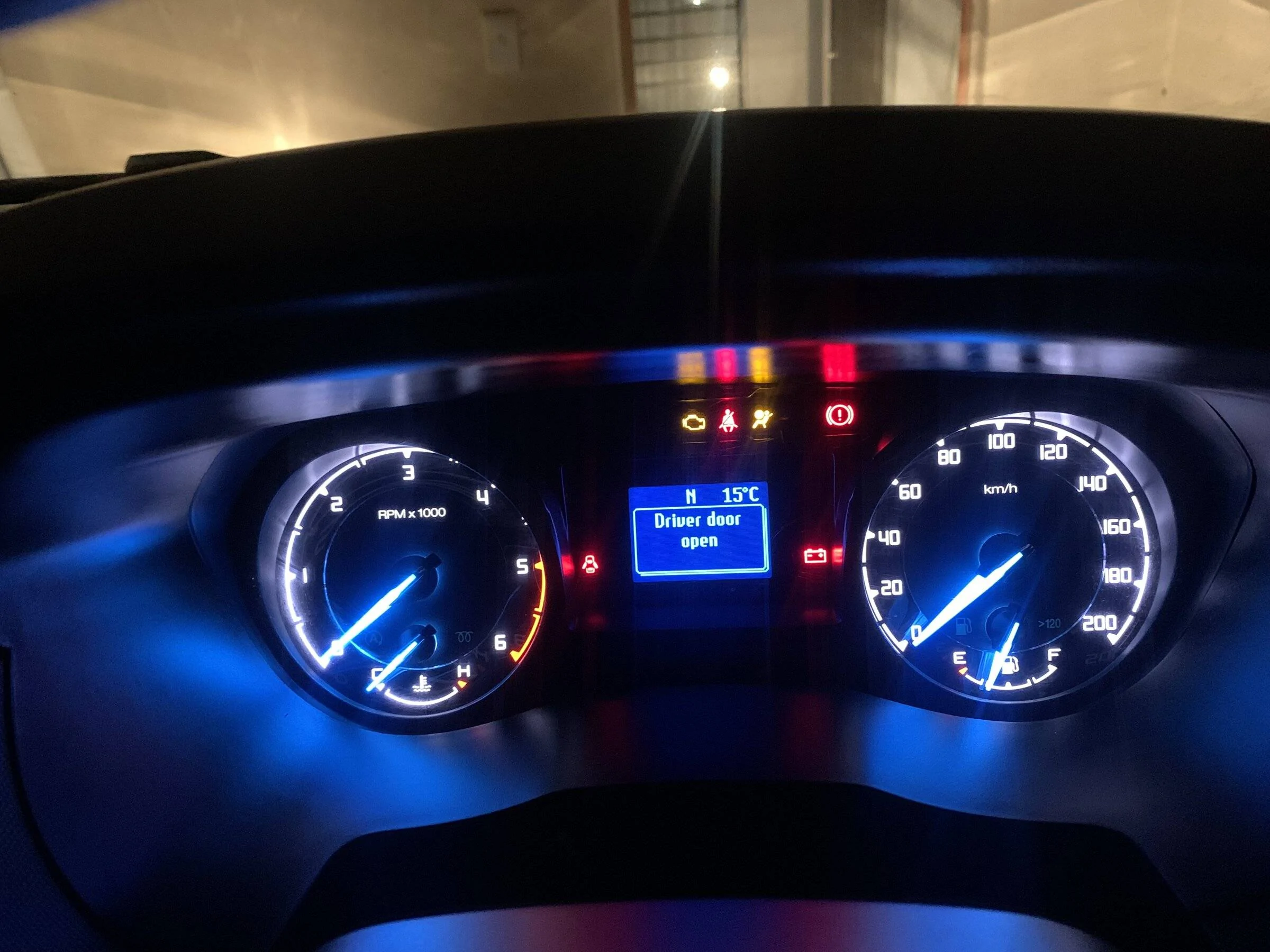

I would like to change my instrument cluster on my Ford Rang er XL 2.2 Manual to either an XLT or Wildtrak So I would like to know if it’s fine to fit the one from an automatic vehicle, will it work with no issues? I saw a few from Australia and I would ship them to South Africa. I have attached the pictures from my vehicle and the other from the Internet of the example of what I would like to change it to. Please advise!

It should work fine but you will need a laptop with Forscan on it and a OBDII plug. I had the same cluster as you and swapped it out for an XLT. Before pulling my old cluster I saved it's settings with Forscan. After the swap I loaded the settings into the new cluster.
There is a setting to switch between auto and manual transmission. So the auto cluster would probably work in a manual but you would still have non-working gear indicator at the bottom.
