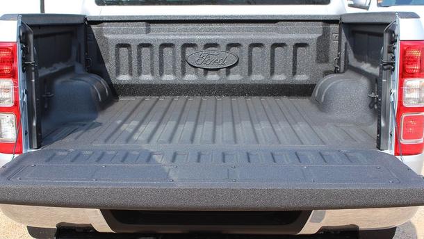

FORD Bed logo under the bedliner

I used to spray bed liners for a local Ford dealership here in Knoxville. From what I remember, those things were next to impossible to get ahold of. For us anyway. Of course, that’s been 15 years ago. I ended up making one-off logo for my own truck at the time. Although it wasn’t real practical to sell it as an option for us to spray. Plus, with what we used, it would only work on the bed’s floor. We scuffed up the area, used a vinyl decal, traced It with a sharpie, removed the decal, then filled in the traced area using Fusor body seam filler, let it harden and sanded it smooth.
