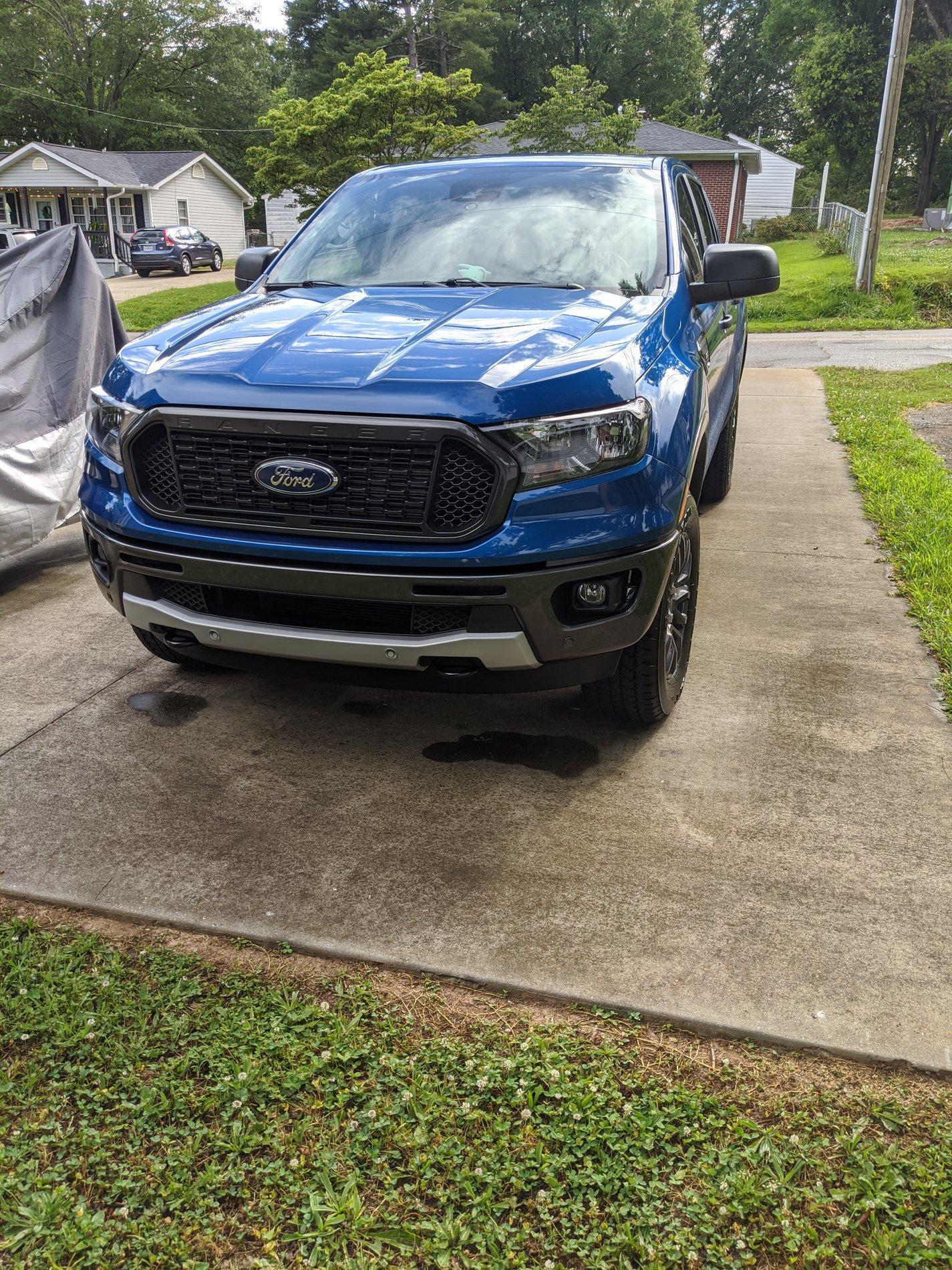

I've seen some threads on plasti dipping and others on custom bumpers etc. But what is the best option to get the silver part of the stock bumper to match the rest?

Rustolium's graphite Flexidip is a great match for the magnetic trim, and while never a hard gloss, a glosser top coating will add a sheen and help make cleaning easier.

Paint it. I've painted the grille and fender vents with color-matched paint (Blue Lightning code N6) from R&E Paint Supply online and used their 2K clear (with hardener) with great results. The paint code for Magnetic is J7.
