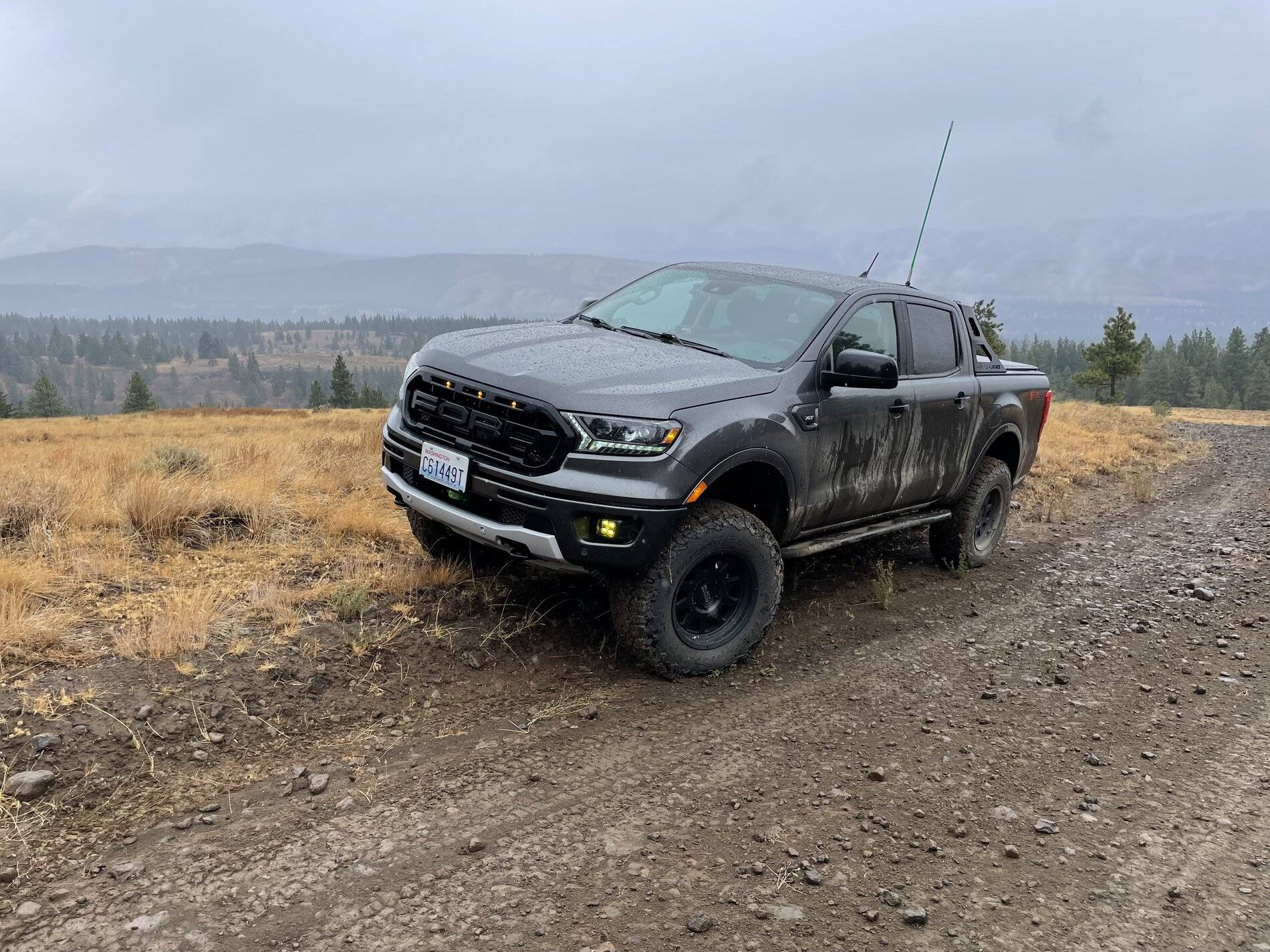

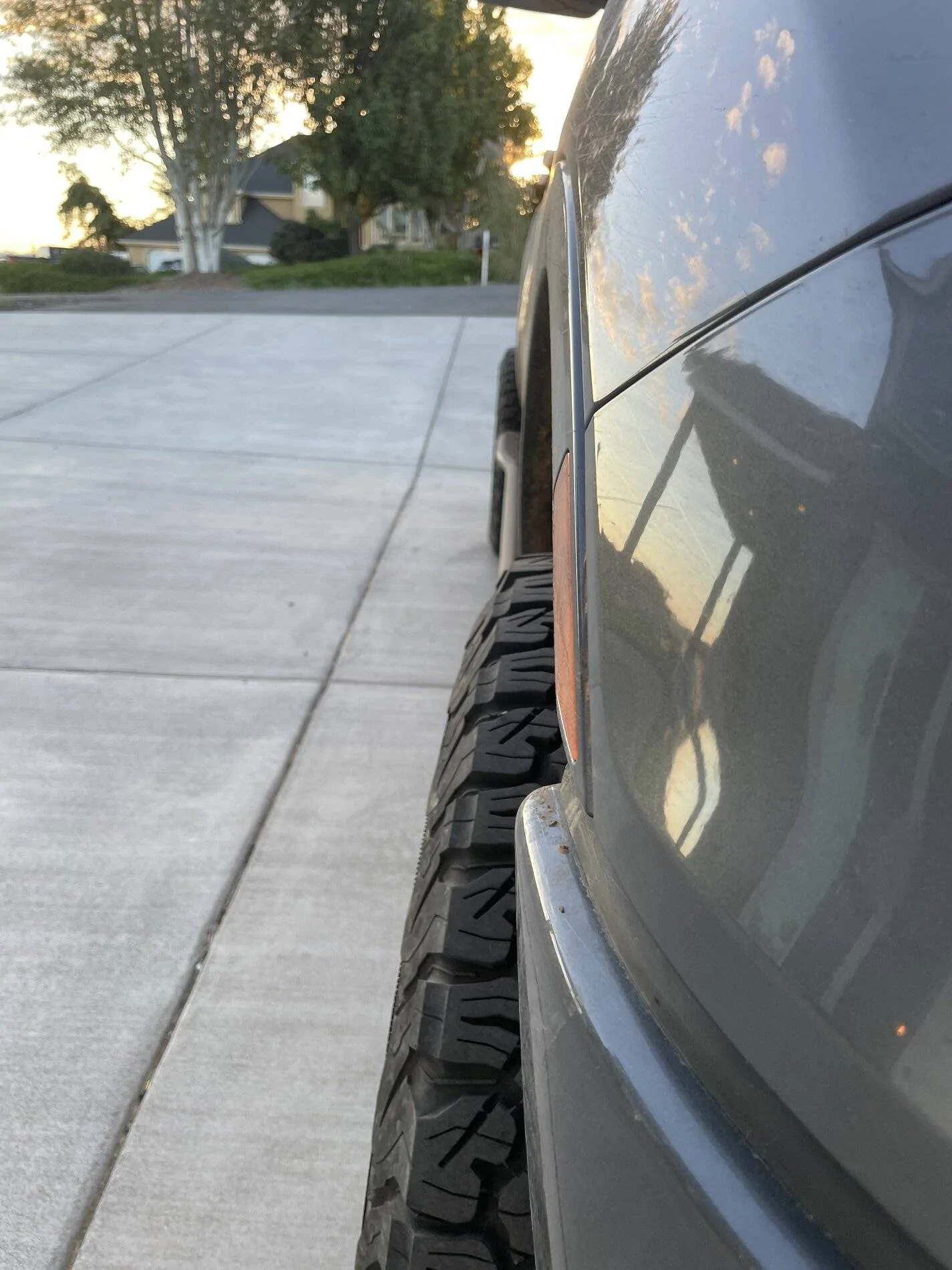

I have the Black Rhino Stadiums +12mm offset with 285/70R17 KO2s. I run them without additional fender flares, but there's a little bit of poke. Here are some photos. I can take some that try to show the amount of poke better tomorrow :)
If possible, a pic from then front down the sides and a full side pic would definitely help. Any clearance issues with crashbars? Im assuming theres a lot of room for the spindles when offroading?

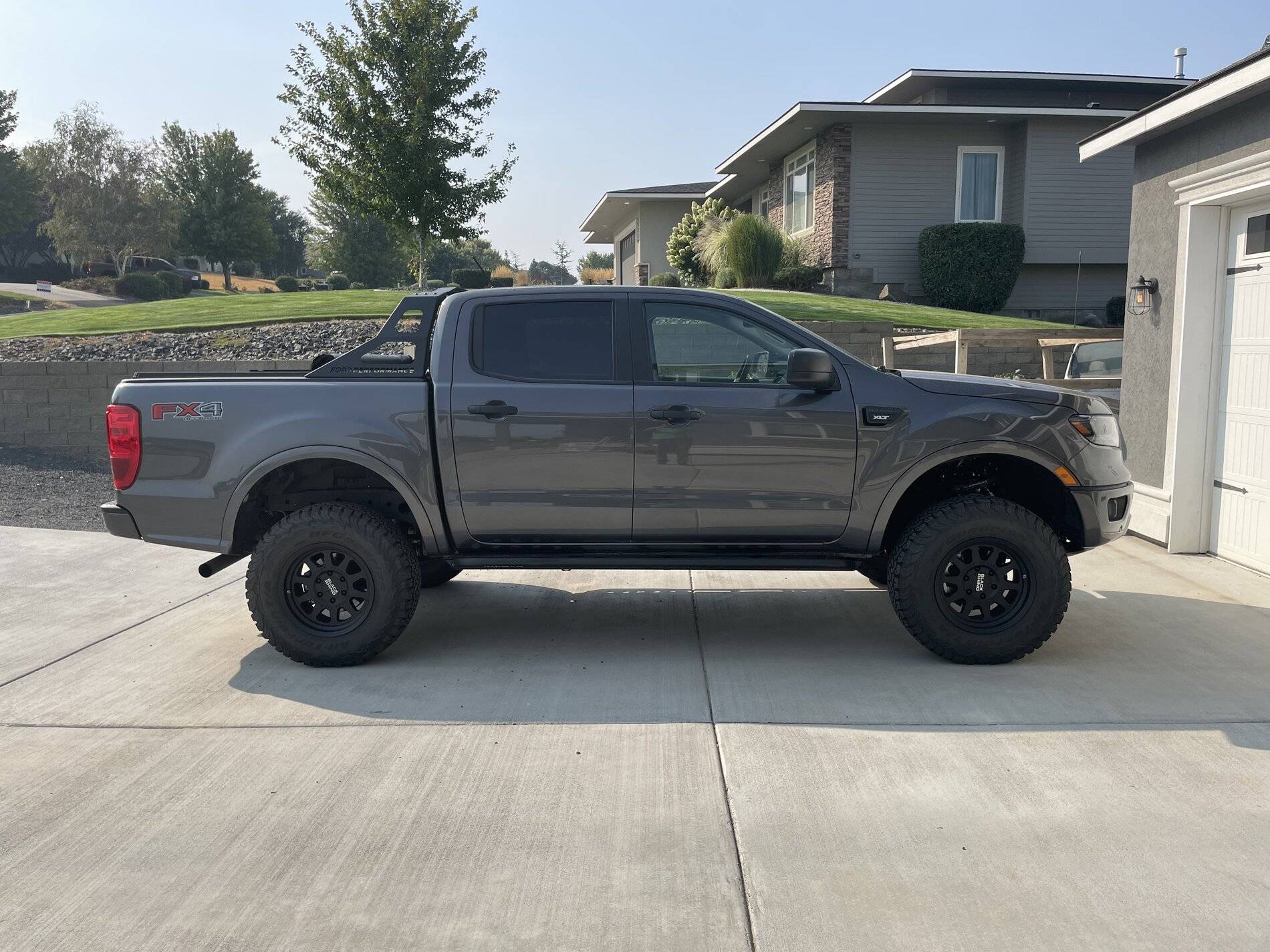

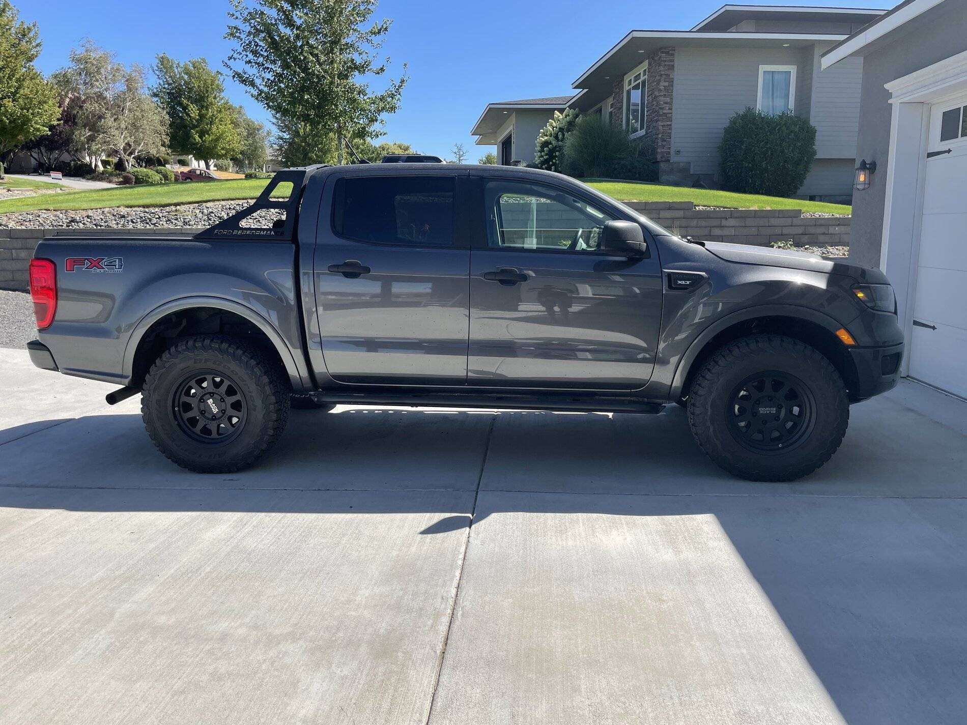

Looks awesome btw! Really like those wheels!
Here's a full side picture (before and after the lift). I have the ReadyLift intrusion beams and without a lift there was some rubbing at full lock with the 285s, but only on the felt on the back side. With the lift no issues what-so-ever even while offroading.
I'll get the front facing trying to show how much they stick out tomorrow when it's light out.
Before Lift:
After lift but before it settled:

Here’s from the front. It’s hard to get a picture that shows it adequately.

Oh thats not bad at all, and since im using 275’s it will be less. I can live with that, awesome! Appreciate your help man!
