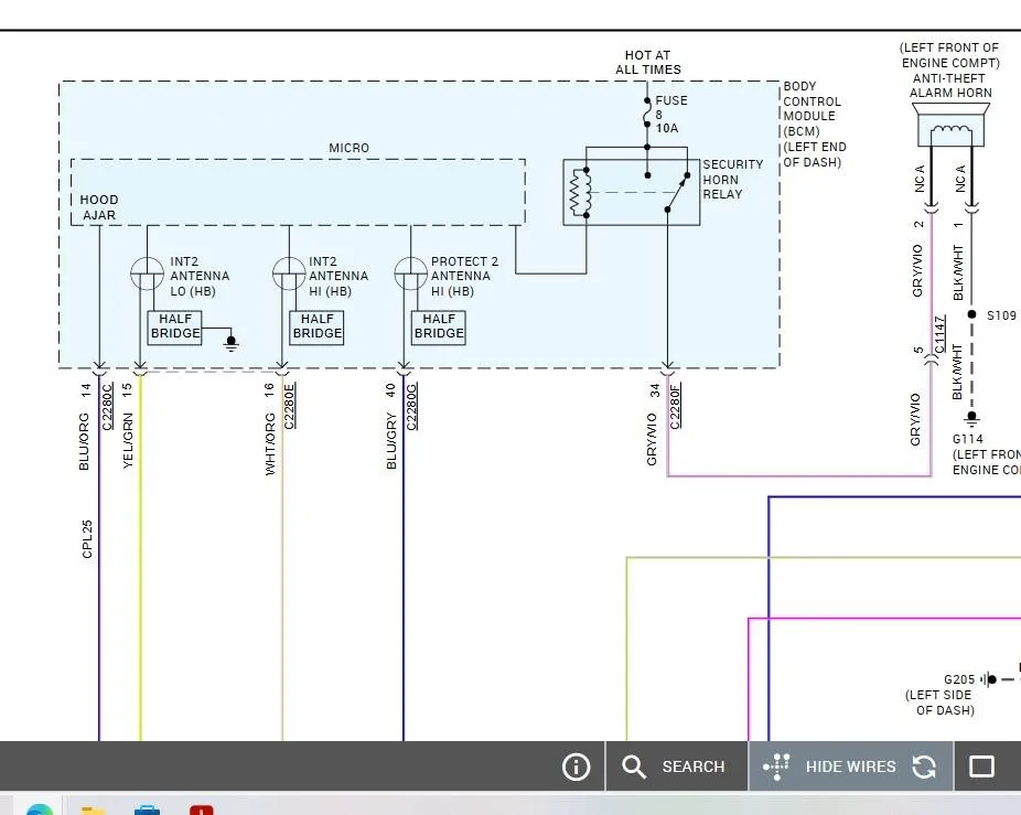

So, a clarification on this: Since we have confirmed its the Waste Gate Actuator triggering a power cycle.
Does it only do it with the Hood Opened and Batt Minder (On)?
and is this the only thing powering up (Waste Gate Actuator)?
I am looking for anything else that powers up when you open the door, like the IPC and Sync Screen (Boot Screen) and any Interior Lights or Parking Lights (Flash)
If no other items are powering, then this possibly eliminates the Door Ajar switches but not ruled out.
I have a hunch the Hood Ajar switch is sticking and not seeing a full contact of open or close (Partial) and resorts to thinking it's being actuated.
The same goes for the Door Ajar switches.
For the Waste Gate actuator to power, the PCM Power Relay needs to close and in order for it to close it needs a Ground Signal on the coil from the PCM which is sent to the relay from the Wake Circuit (power input) it receives from the BCM
So, you may try pulling the PCM Power Relay - (BJB) Under the Hood, this should stop the Waste Gate from getting power, now it is possible this relay may be sticking and cycling, but you are not reporting any start or shutdown issues, so I am thinking the relay is good, just its being controlled via the Wake Circuit to get power.
If you pull the relay and it still does it, then you have a wiring issue
With the constant mention of the Hood Being Open, I would look deeper at that switch, and if the truck is Running or in Accy, are you getting the Hood Open message when opened and when you close the hood does it go away.
I would disconnect the Hood Switch connector and see if that makes a difference,
Something on the wake circuit is the issue, be it a door ajar, hood ajar, brake pedal, or TCU.
or a sticking microcontroller in the BCM sending the wake signal to the PCM or the PCM internally cycling the ground to the PCM Power Relay.
Another possible is the Ignition Switch itself or the PATS Transceiver - Moreso the Key in Ignition signal transmission between the (2), so this is a highly probable area, the Key in Ignition will also trigger the Wake Circuit.
A quick test of this theory, pull the Interior Fuse Box (BCM) fuse #18, this will drop power from the Ignition Switch, and see if that stops the power cycle.
If pulling the TCU fuse or disconnecting the connector on the TCU has no results, then I would focus on disconnecting the Hood Ajar switch as the next most likely fault point.
You might also try a BCM and PCM - Self Test, one this will force a reset and also hopefully pull some codes.
Unfortunately, this one needs a Indepth Live Data monitor to hopefully show something or disconnect everything in the system (1) at a time to isolate what is actually triggering the power up.

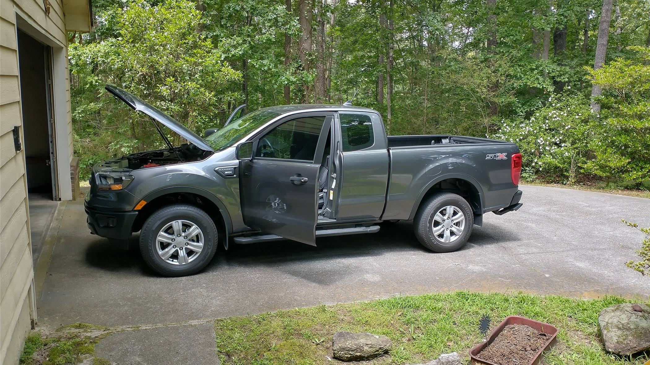

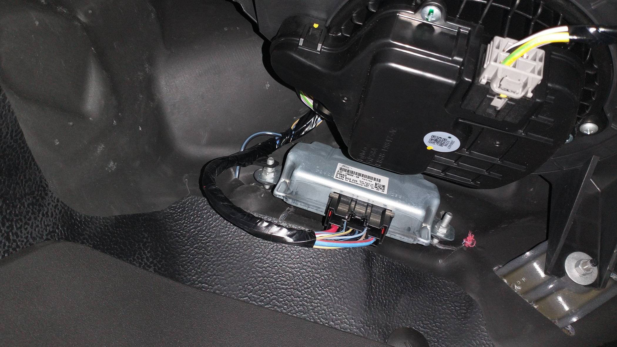

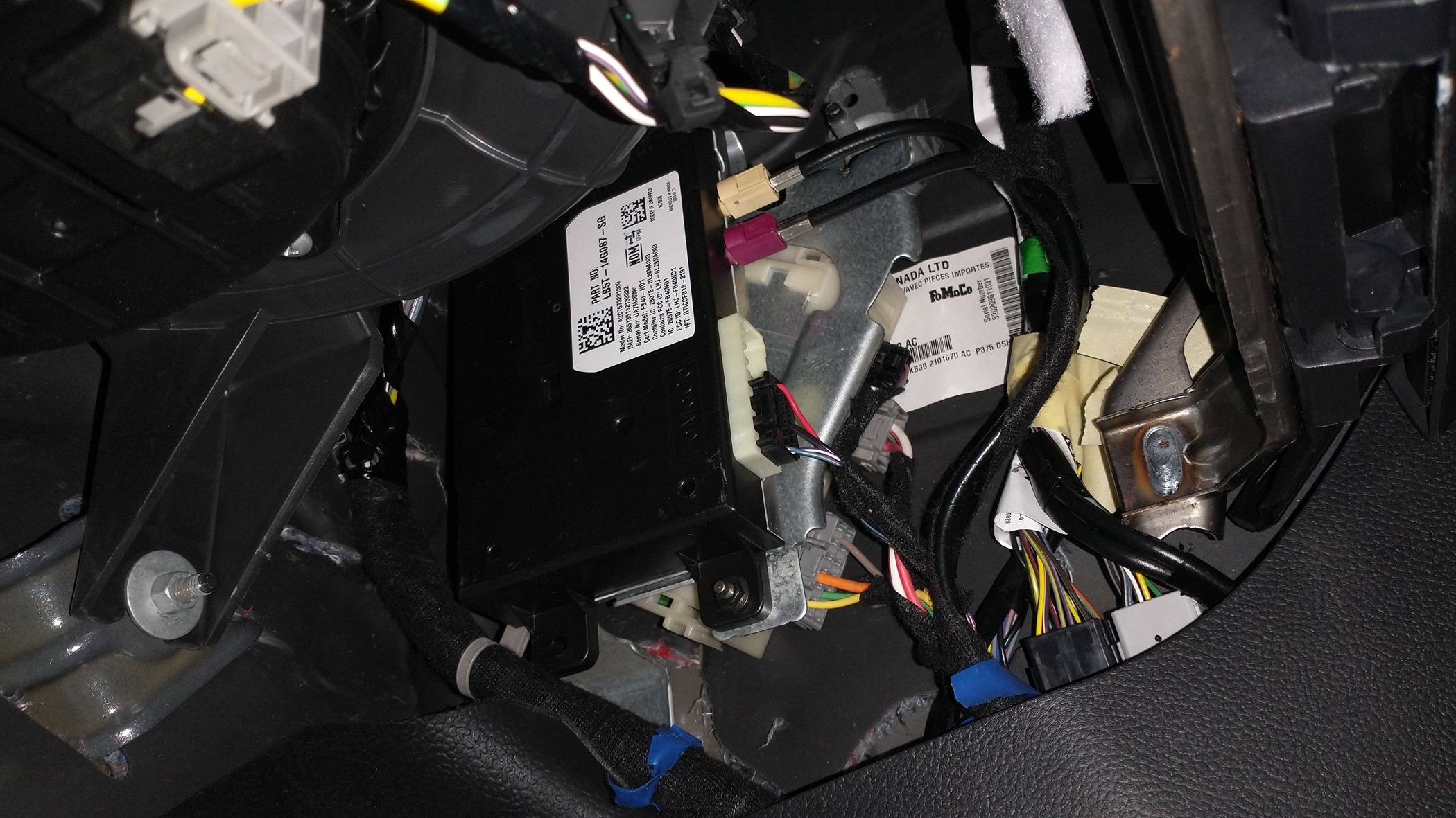

Update. I double checked the Nationwide Smartmiles module. I pulled it out again and the truck still moves the actuator every 45 seconds or so.
I put it back, pulled the battery cable off, pulled the wire loom off of the modem. I put the battery cable back on and let it sit there with the doors open and the hood open. After a couple minutes of nothing happening, I closed the doors. When I close the driver's door, the actuator did it's thing and hasn't since. That was roughly 15 minutes ago. Maybe I'm getting somewhere.
Edit: I opened the driver's door and the actuator did it's thing, of course, and I started the truck up. I'm going to shut it off, pull the battery cable off and plug the modem back up, put the battery cable back on and see if it goes back to doing the "every 45 Seconds" nonsense again.
Edit II: Sure enough, the actuator started doing it every 45 seconds. I closed the hood and it hasn't done anything for the past 10 minutes or so, but I saw it start doing it 2 weeks ago when I opened the tailgate and shook the truck, getting the hot water heater out of the bed of the truck. :| It was off, doors and hood closed when that happened.
Edit III: I opened the tailgate, hopped up in the back and shook the truck around and no actuator movement. Maybe it's the hood latch sensor?
The thing is, it has sat out here in the garage with the hood open and the battery minder on it for months and months. It just started doing this actuator thing every 45 seconds just recently. I'm in the garage enough to hear the truck, if you know what I mean.
Edit IV: I left the hood closed, put it back in the garage, shut it off and after a few minutes it started doing it every 45 seconds again. I pulled the cable off and put the battery minder on it. I'm done with it for today.
Maybe it's the modem.
