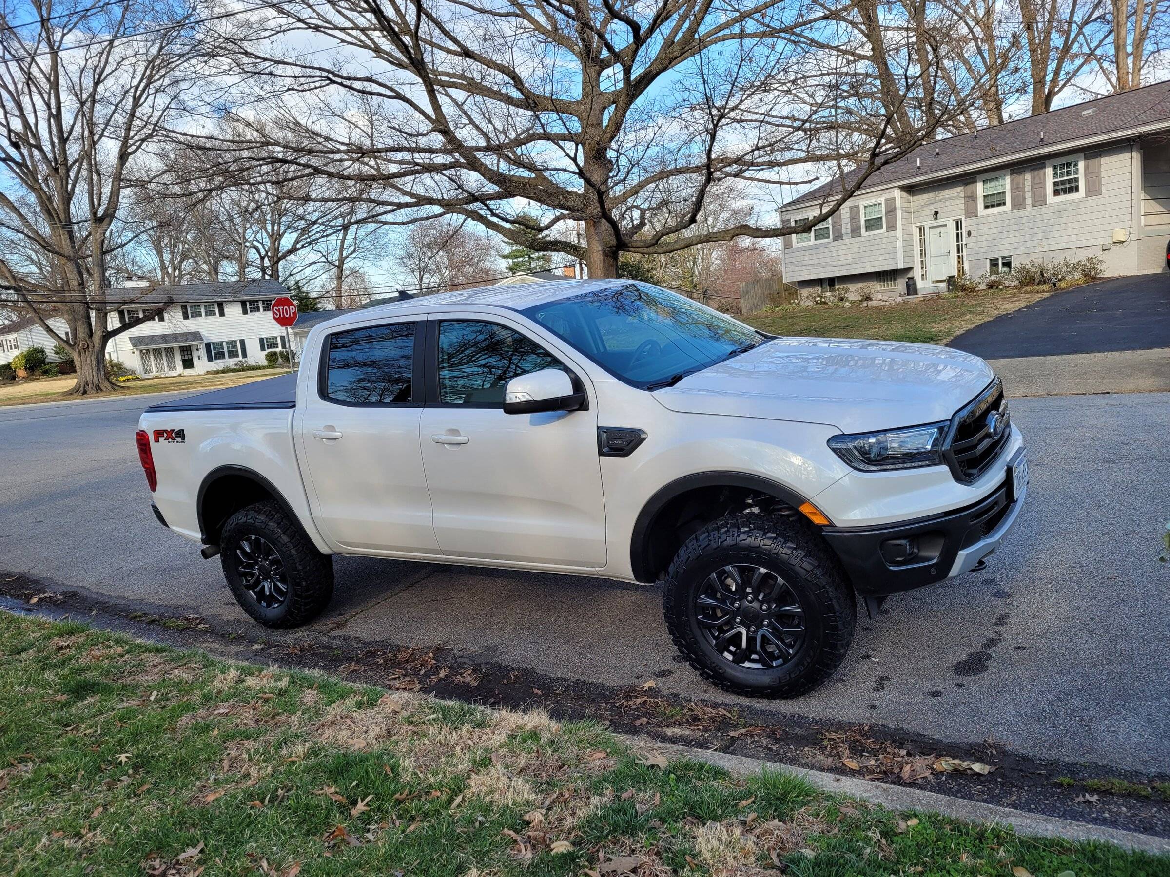

Just do what I did (black package too) and go with a 265/65/18. Looks fantastic.
