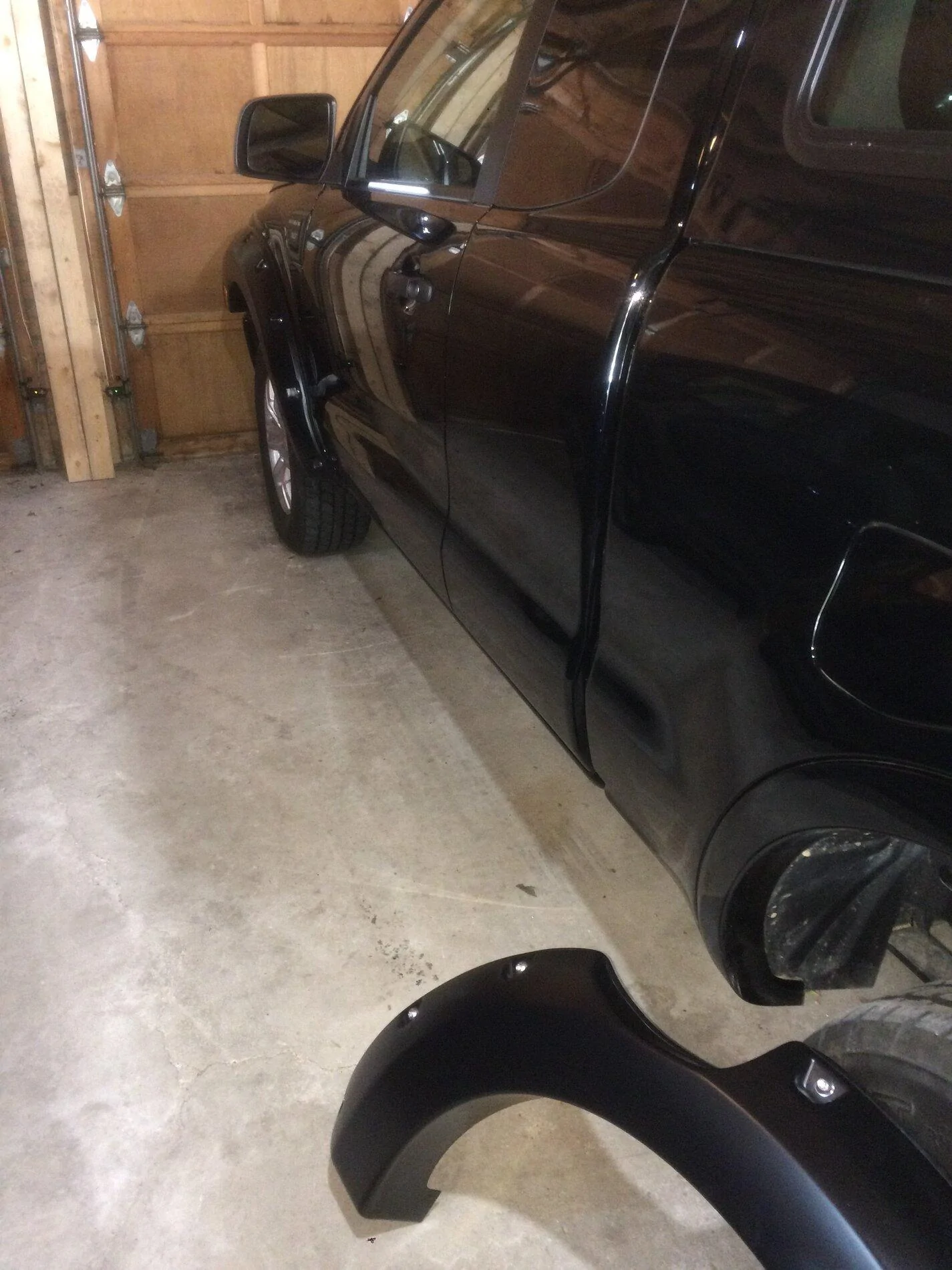

gonna need more than a +5 to fill up those flares!
Yep, it will look a bit goofy without pushing them out with spacers or a proper offset. I remember how funny my truck looked when I mounted my flares right before I installed my lift/wheels/tires. It was the same day, so no one saw it. ?
