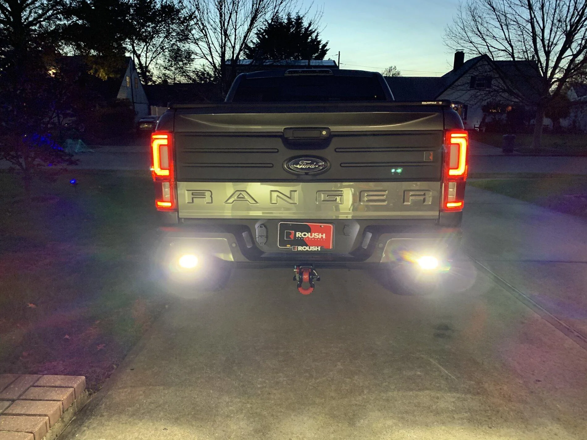

Update: 11/12/2020

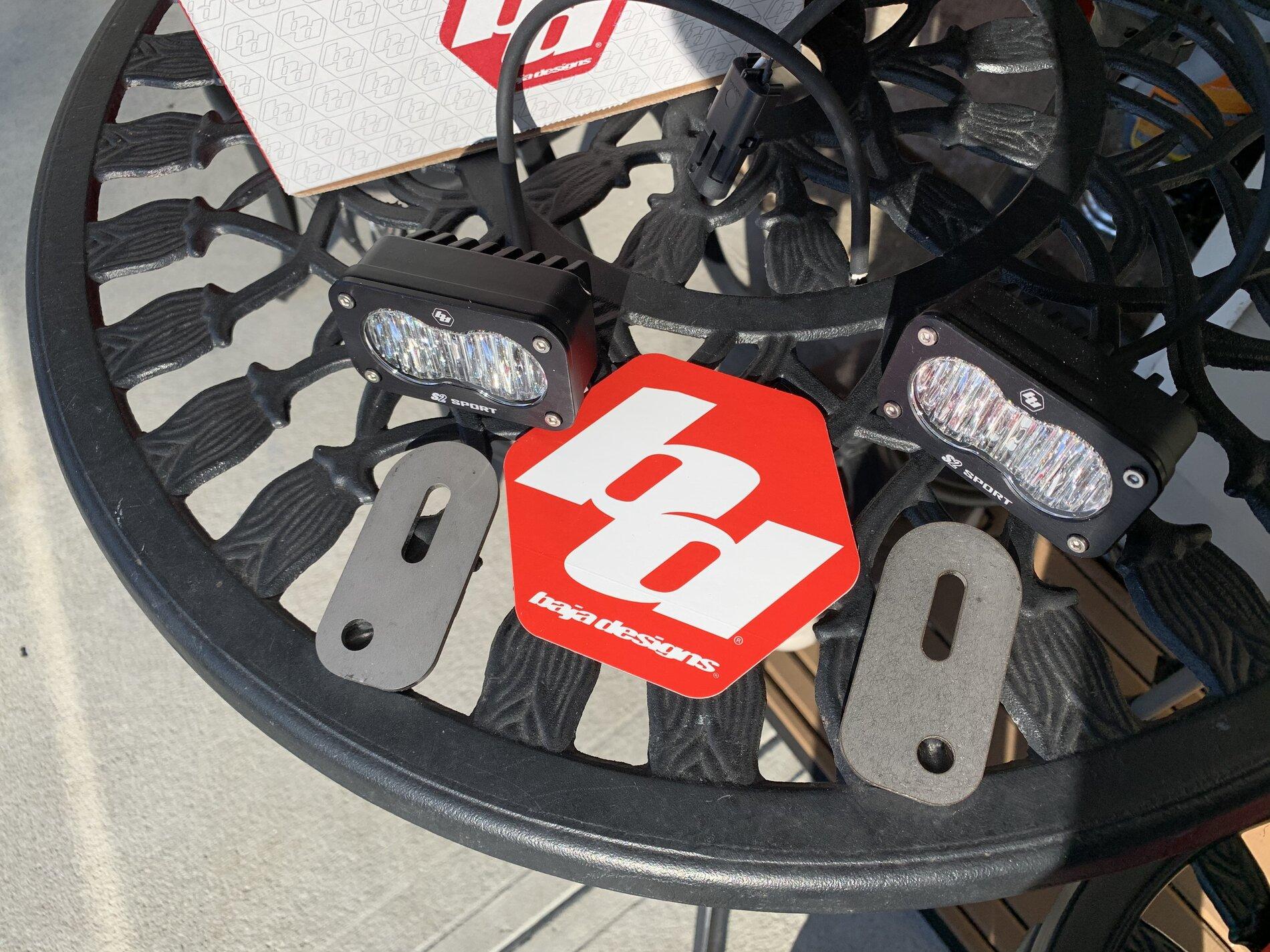

Added pics of the Baja Designs Ranger S2 Reverse kit.
(see below)

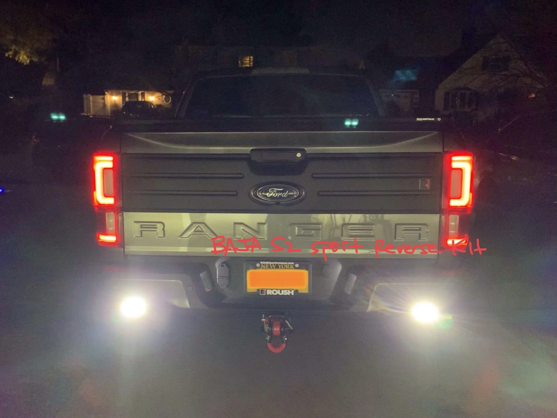

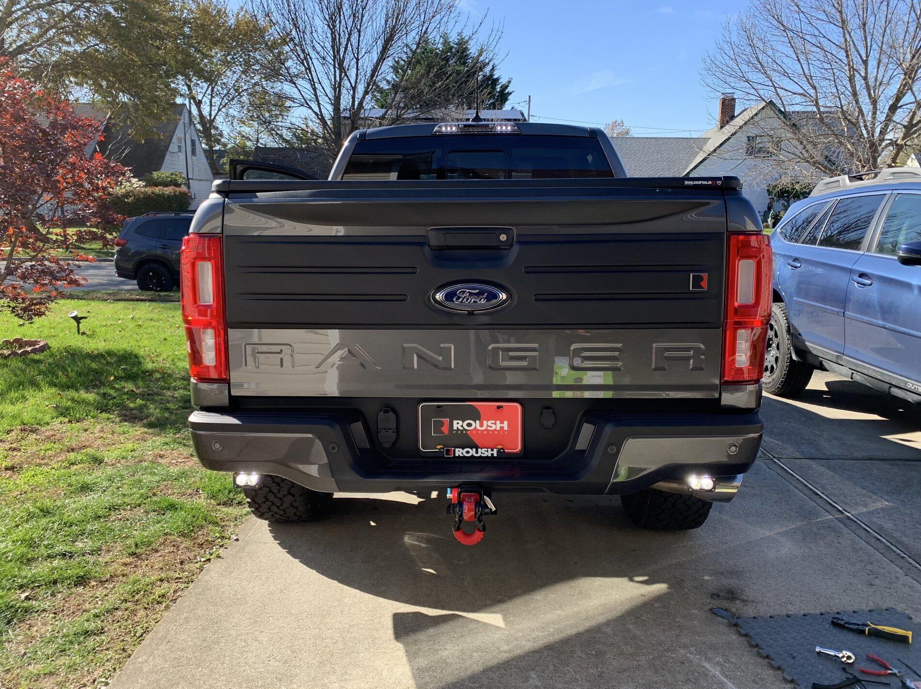

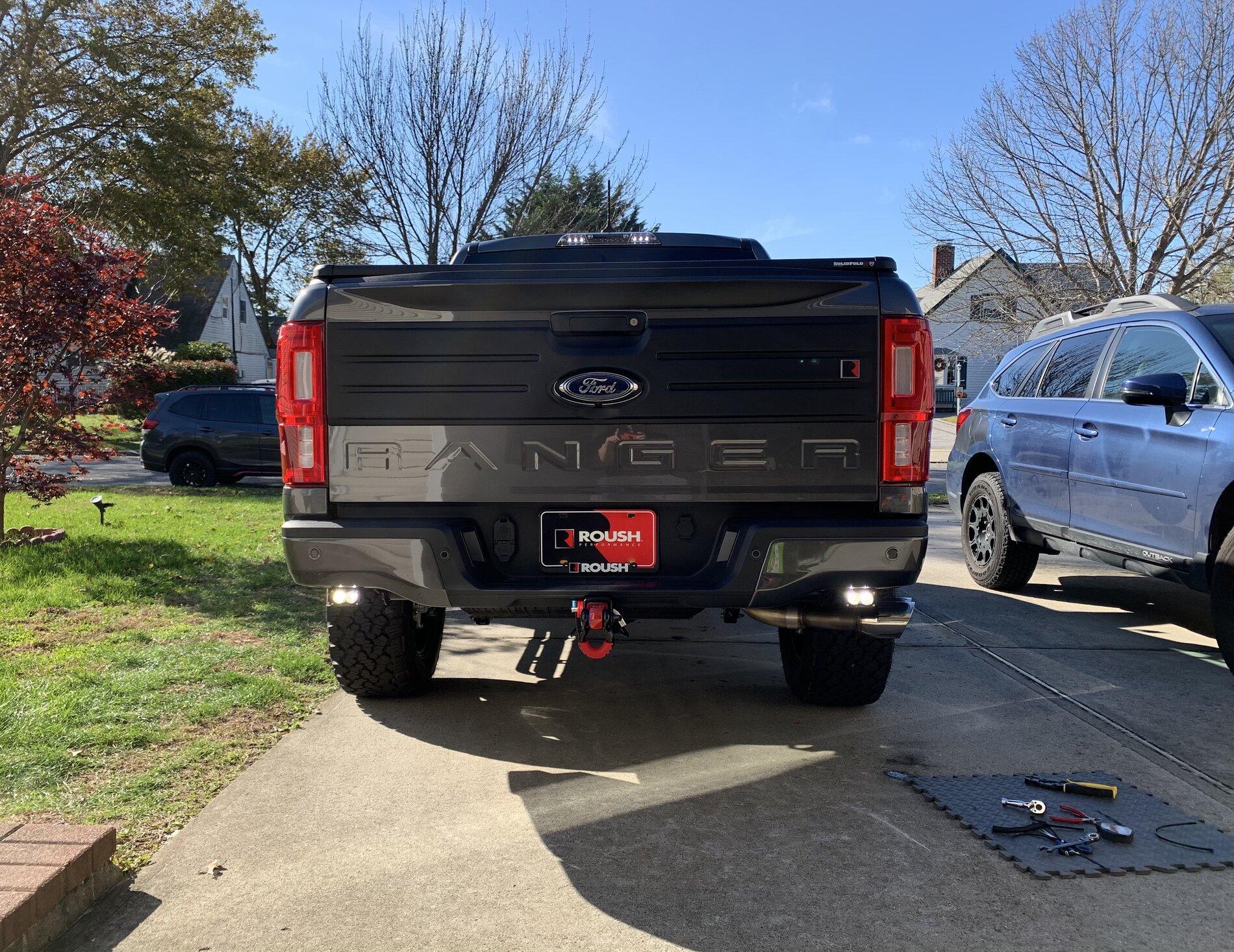

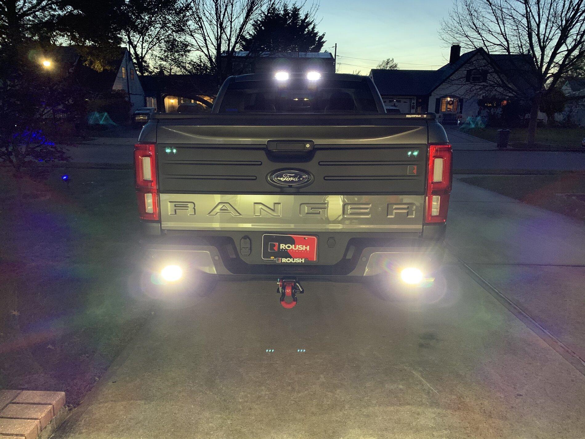

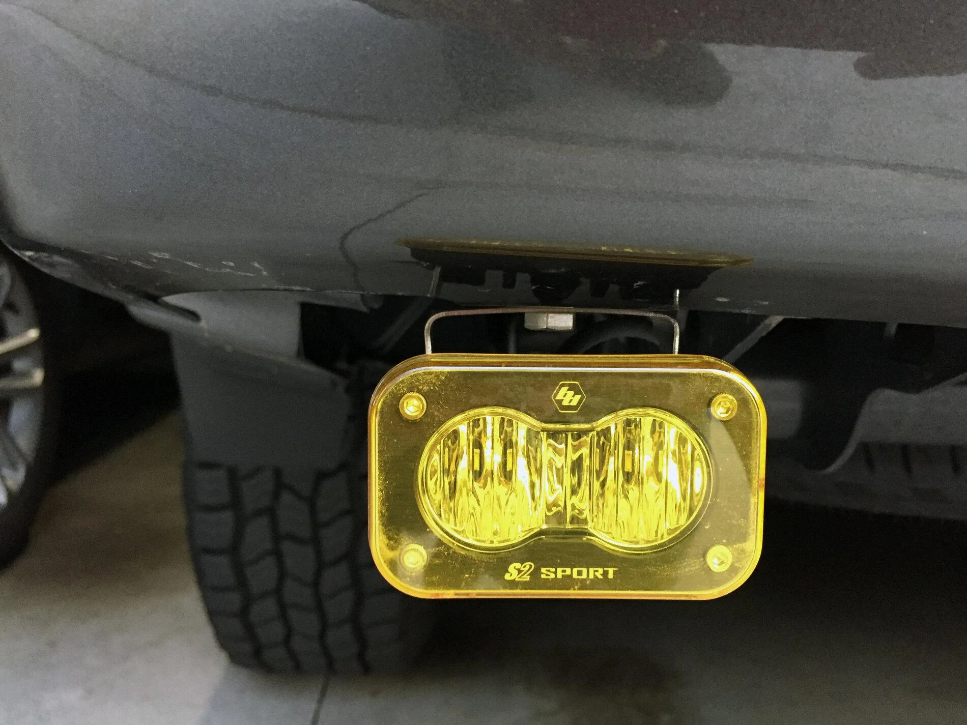

Baja Designs S2 for rear/ reverse aid lights.
(this is not their reverse kit, mine was ordered, still pending)

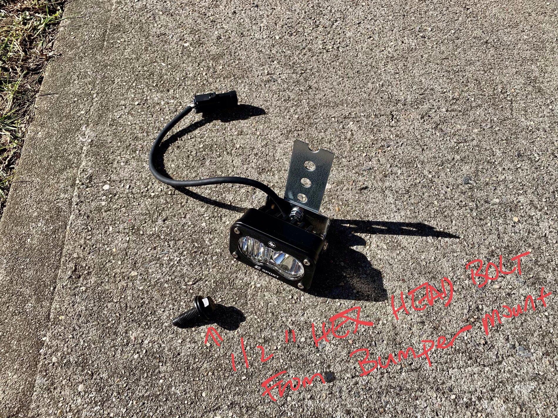

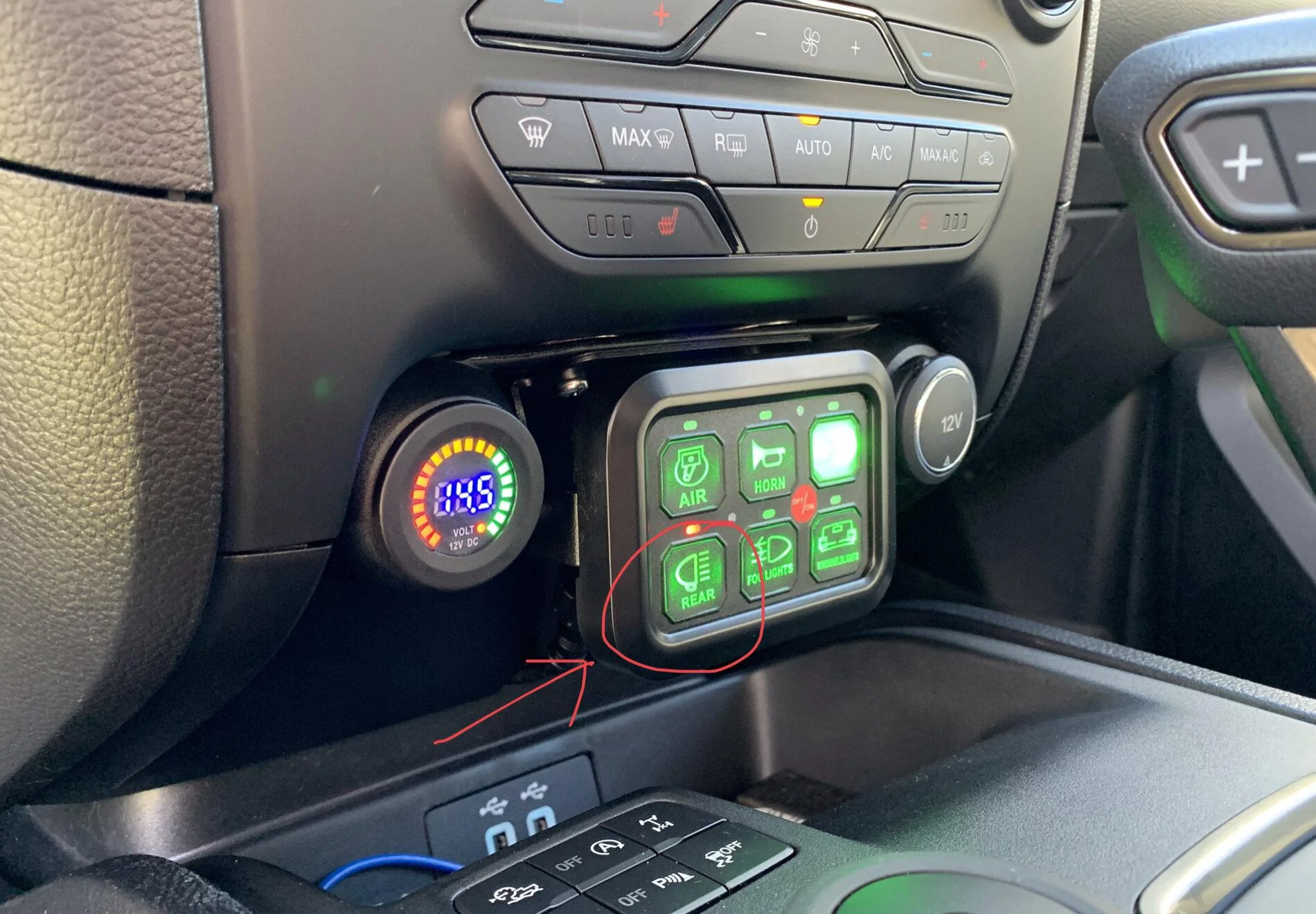

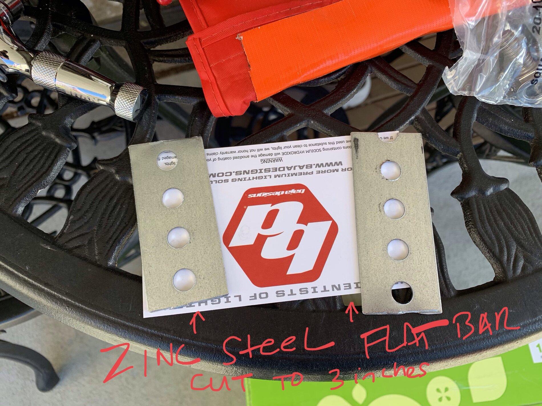

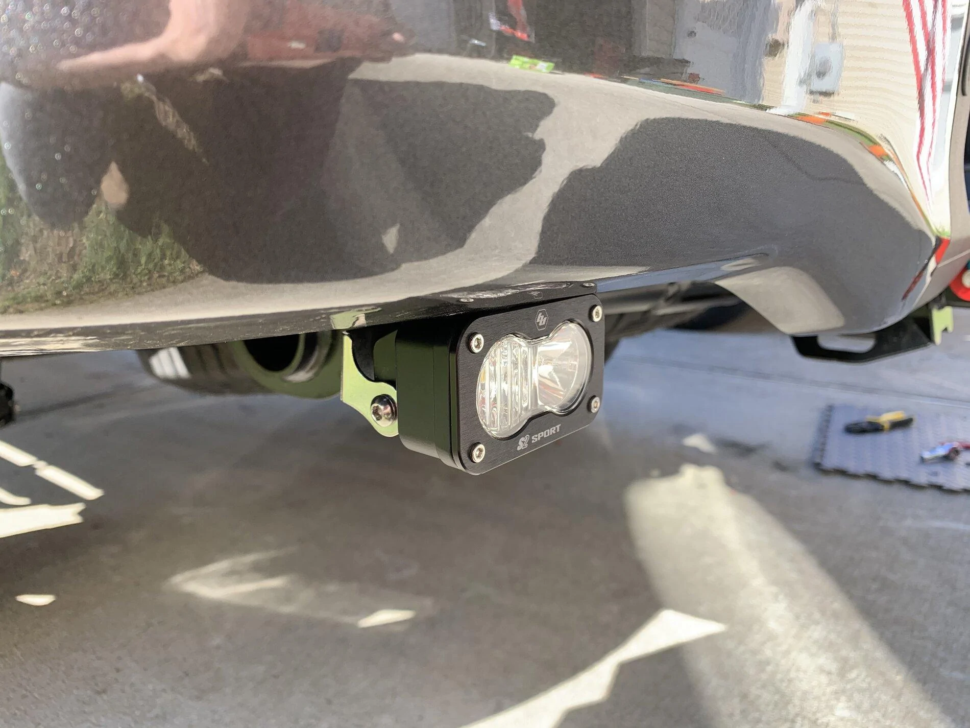

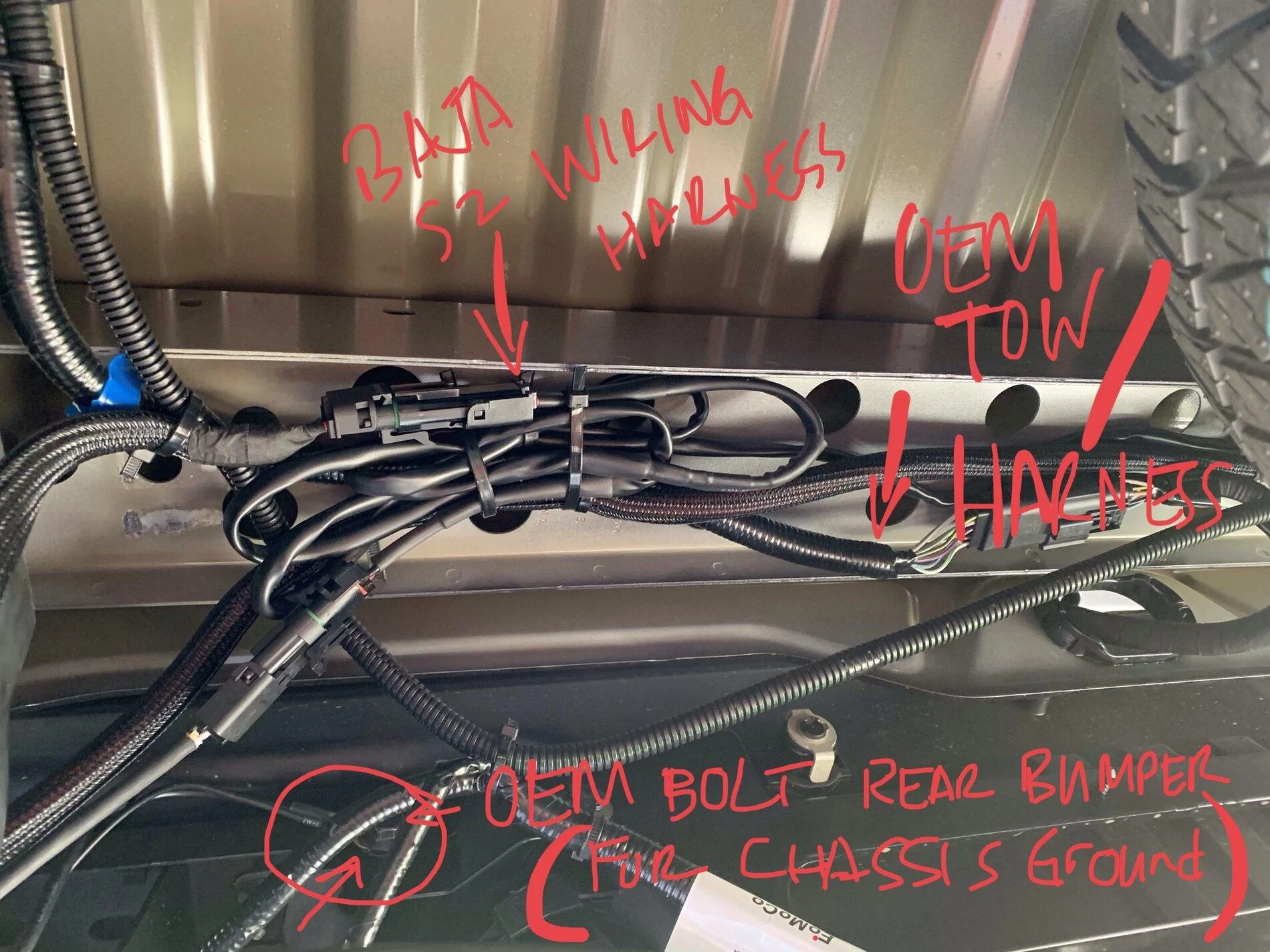

I had an extra set of S2 sport, so since I already did my wiring...
(from my aux power box)

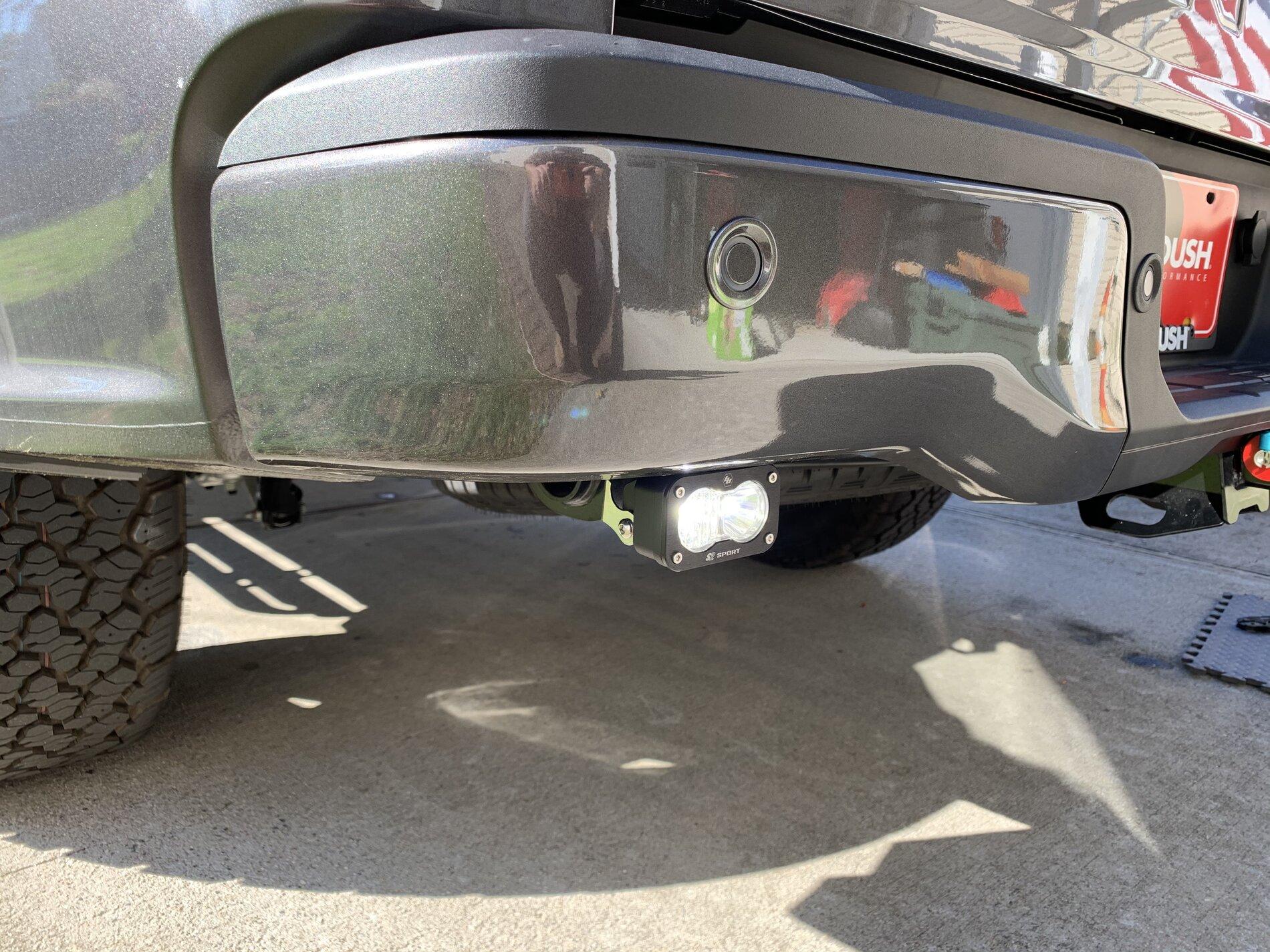

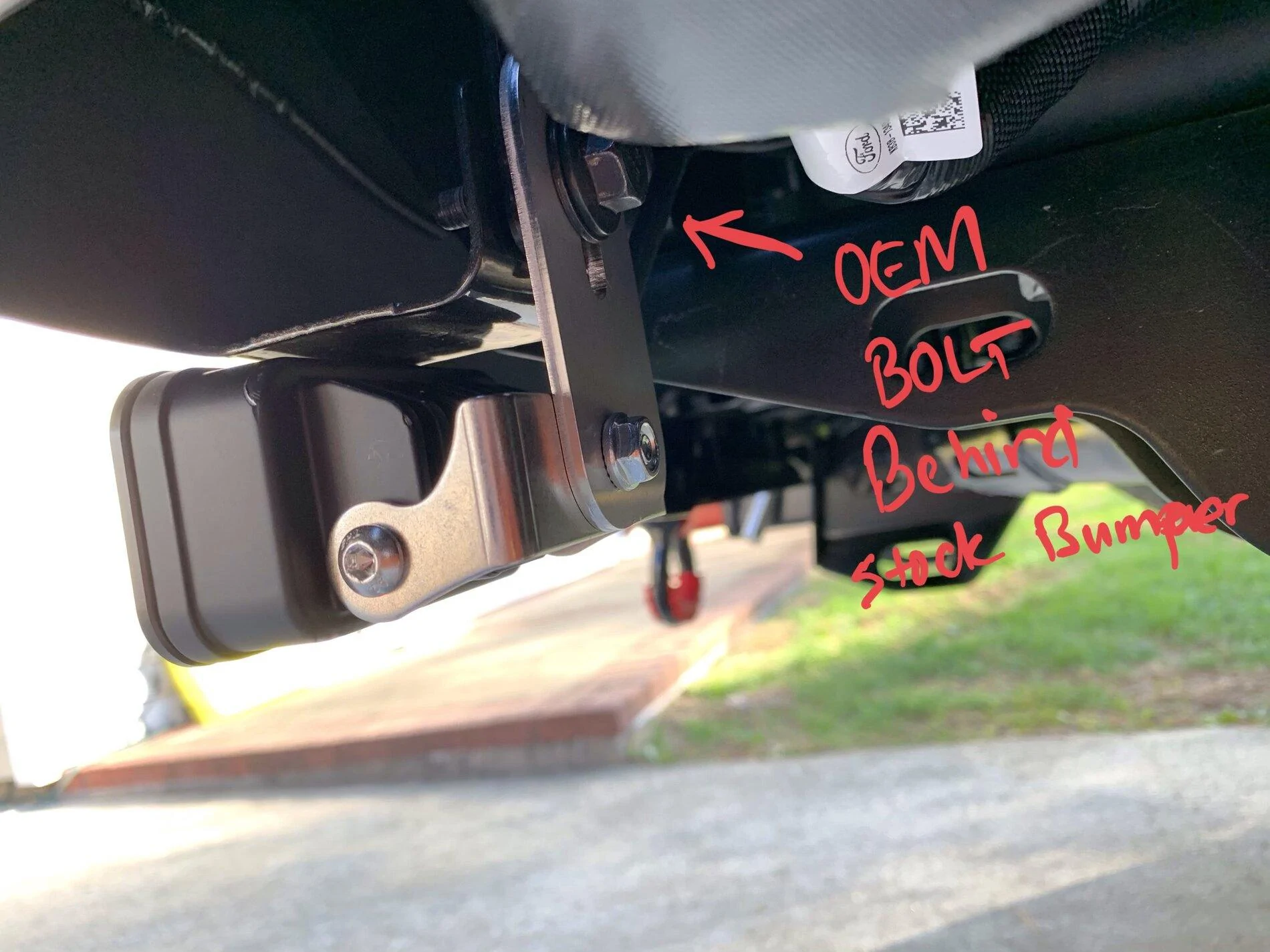

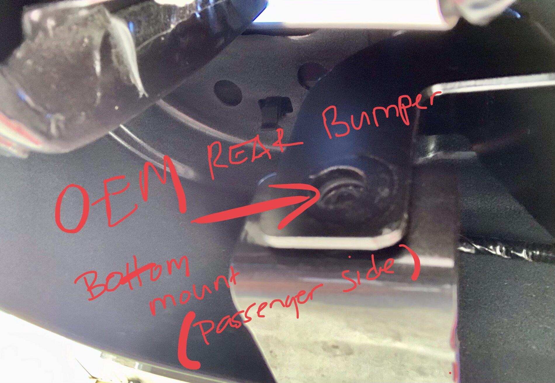

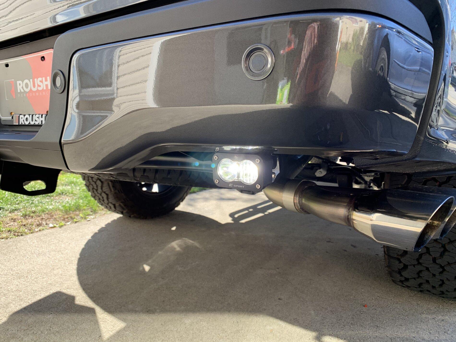

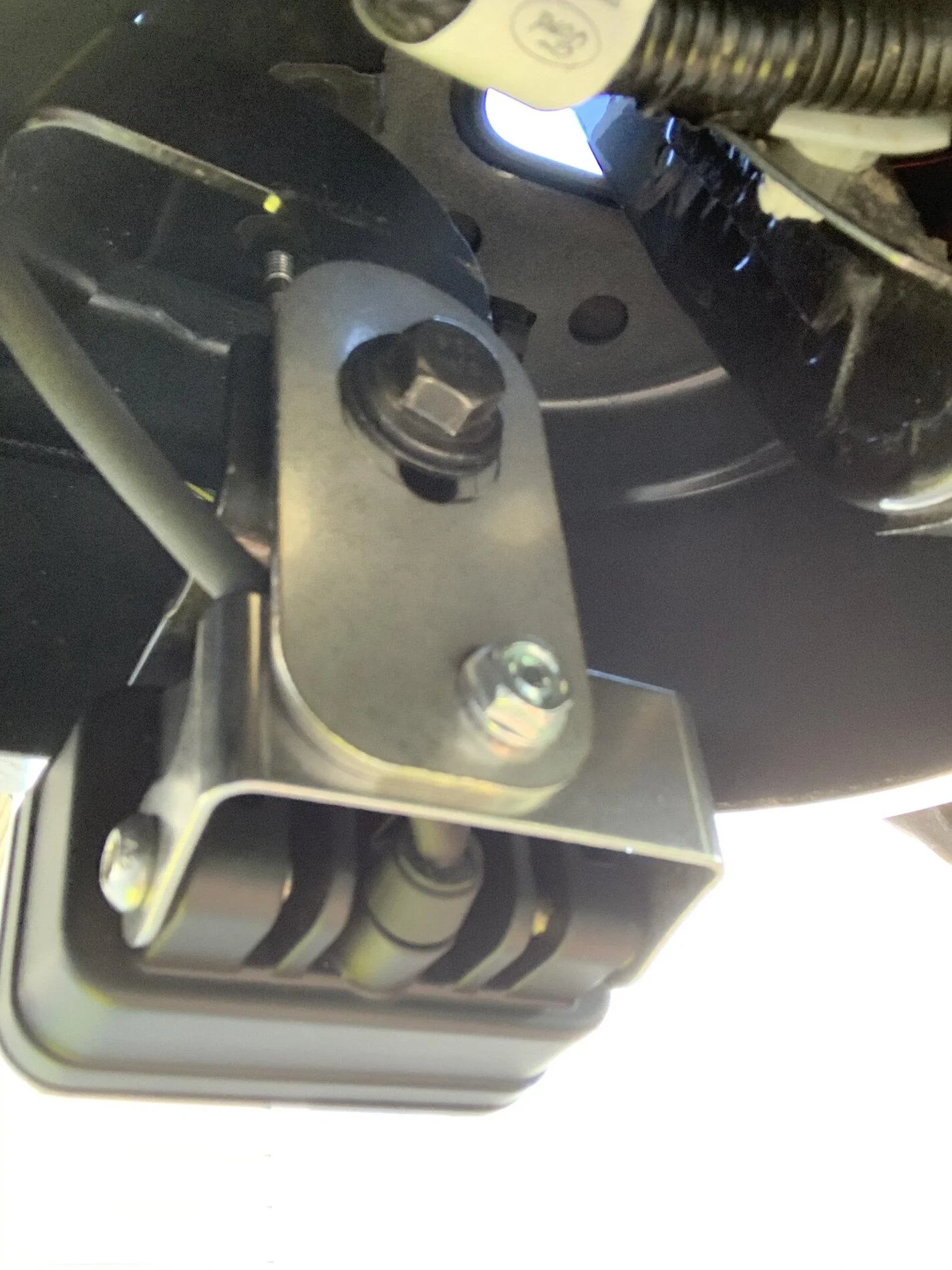

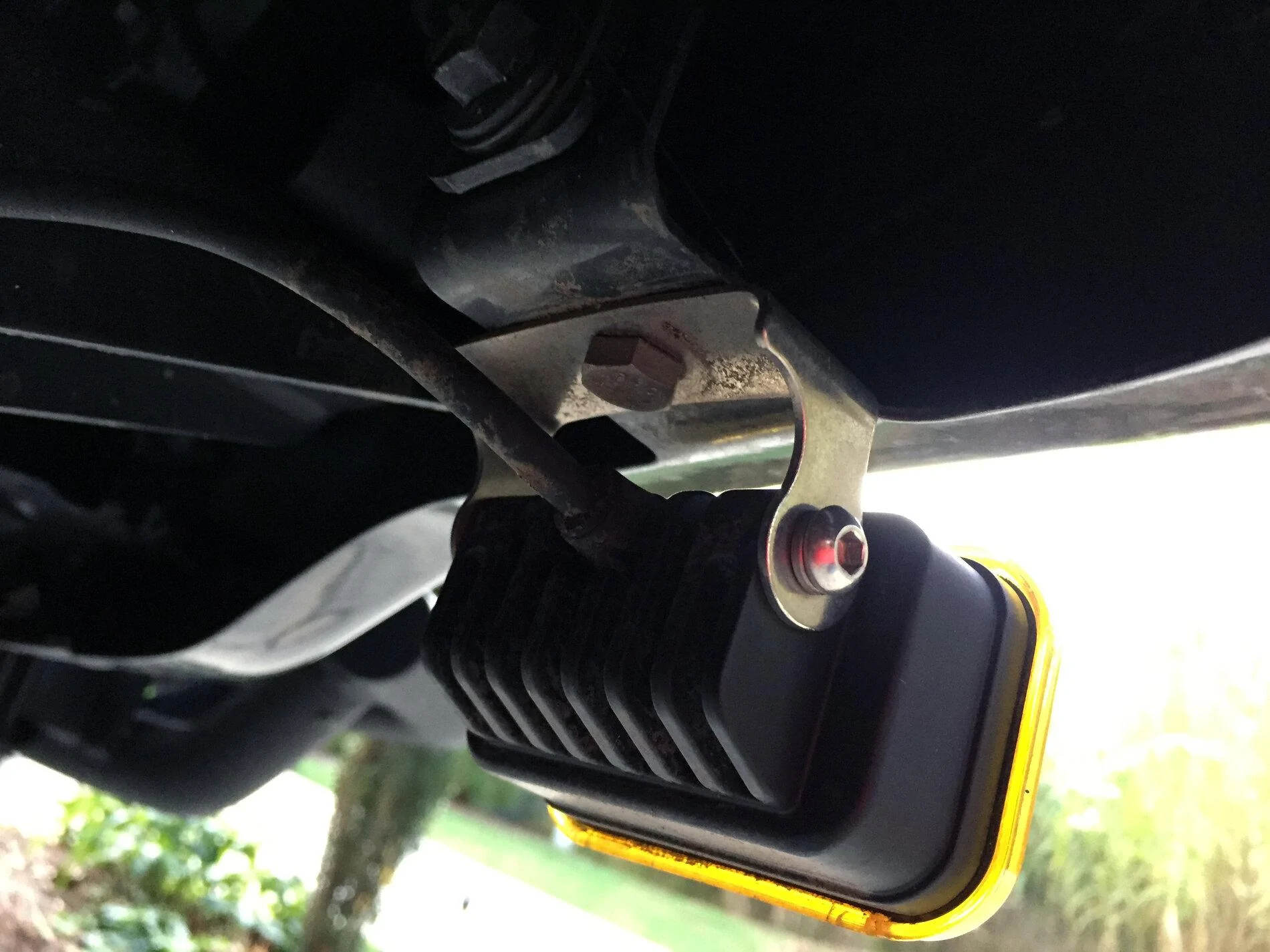

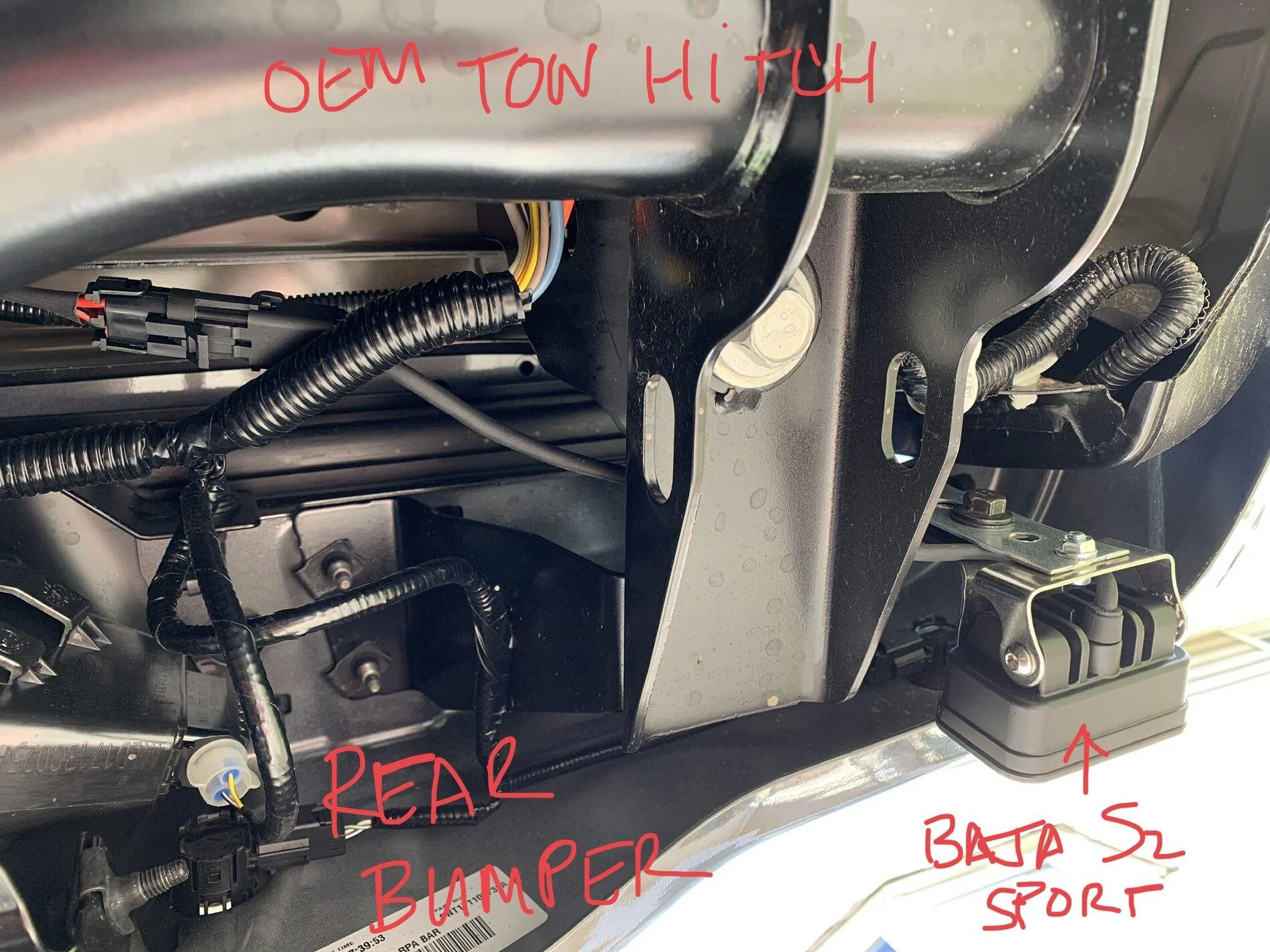

I decided to install these using 3” zinc steel flat bar pieces.
I just used the 2 oem bottom rear bumper mounts.
Note: These will be place holders, until my actual kit comes. :D

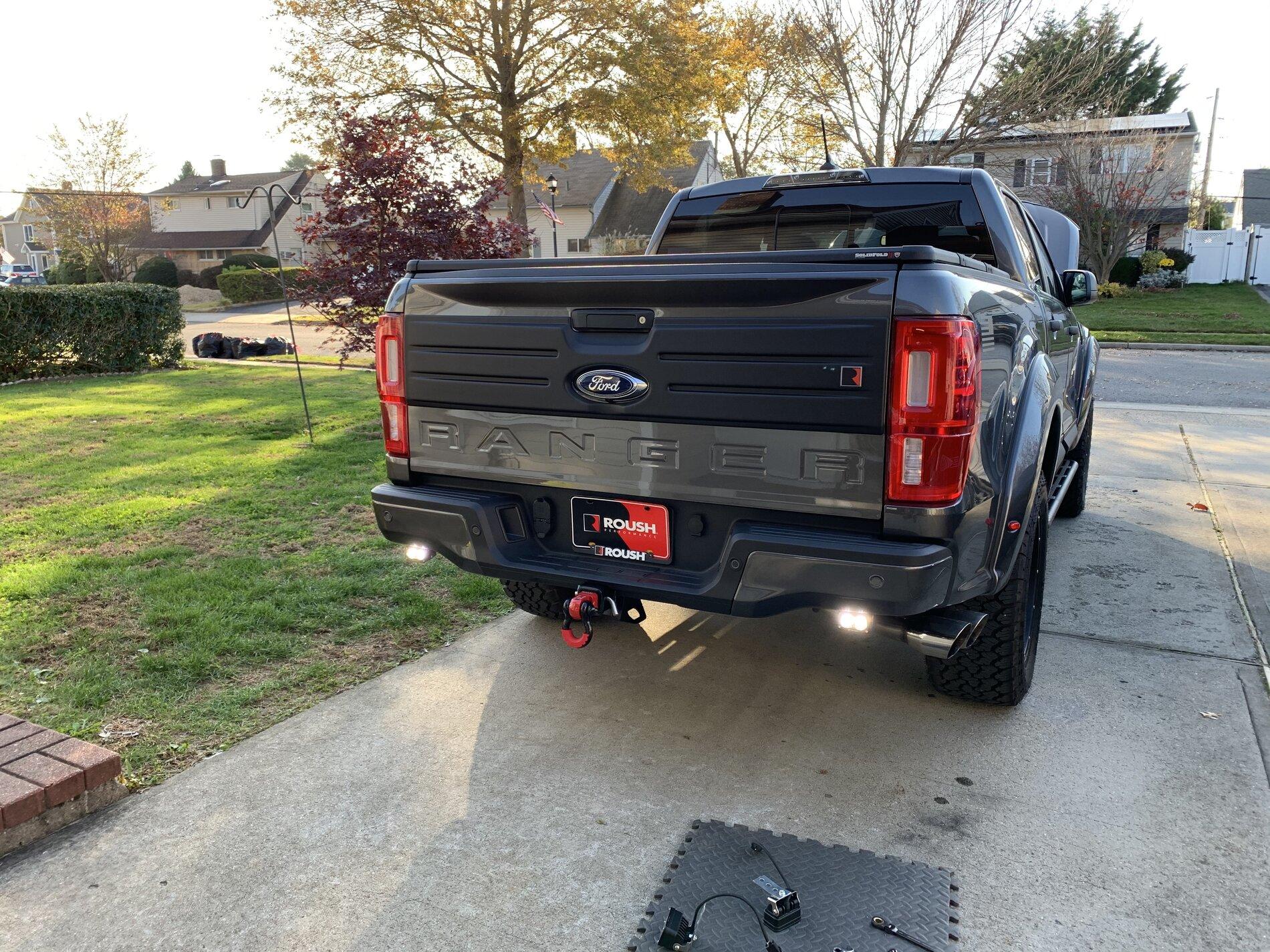

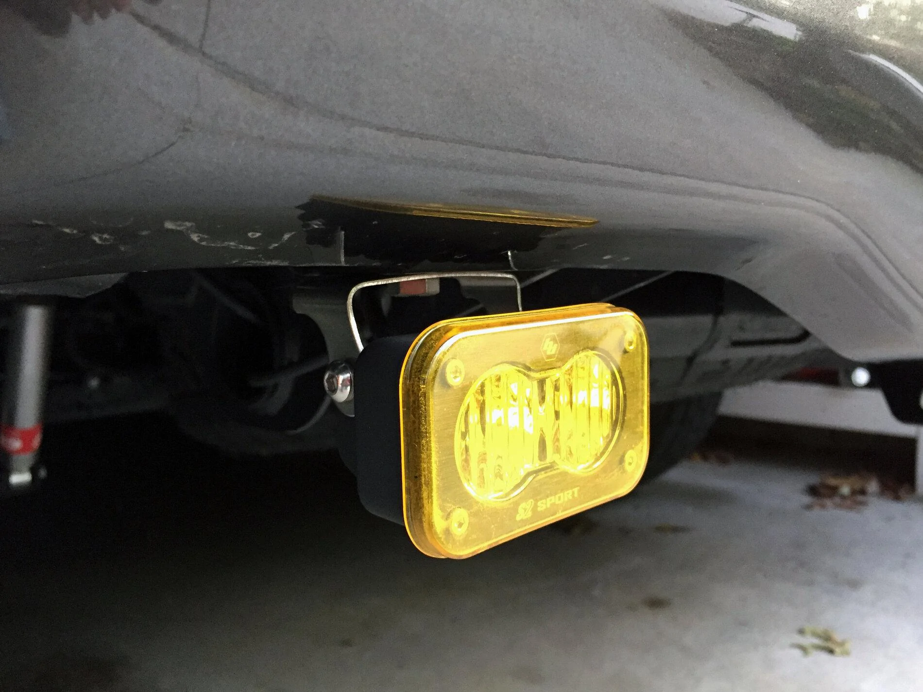

But, Hopefully this will give some members here an idea of where they can mount rear aux lights. ( useful as work lights or reverse aid)

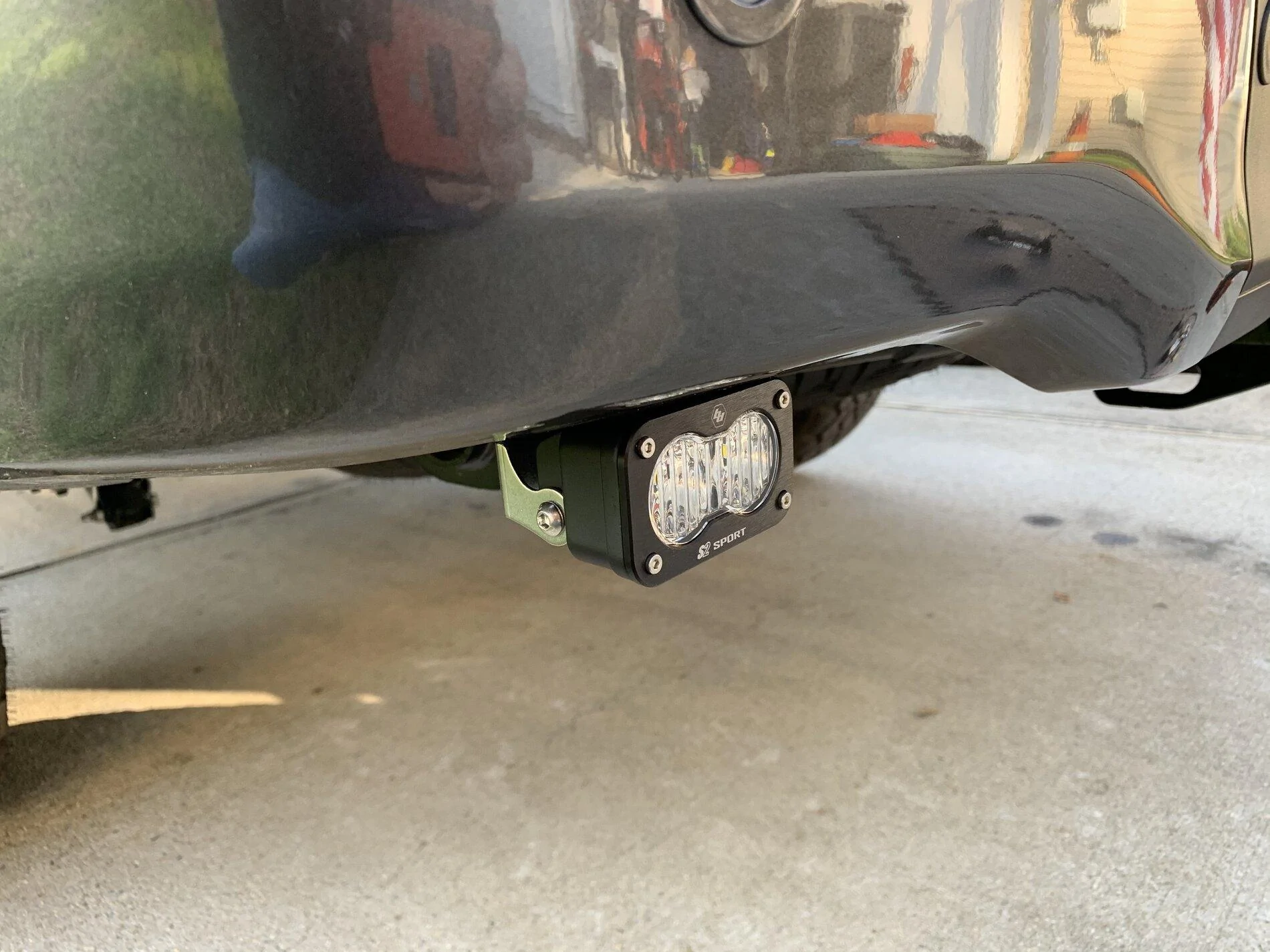

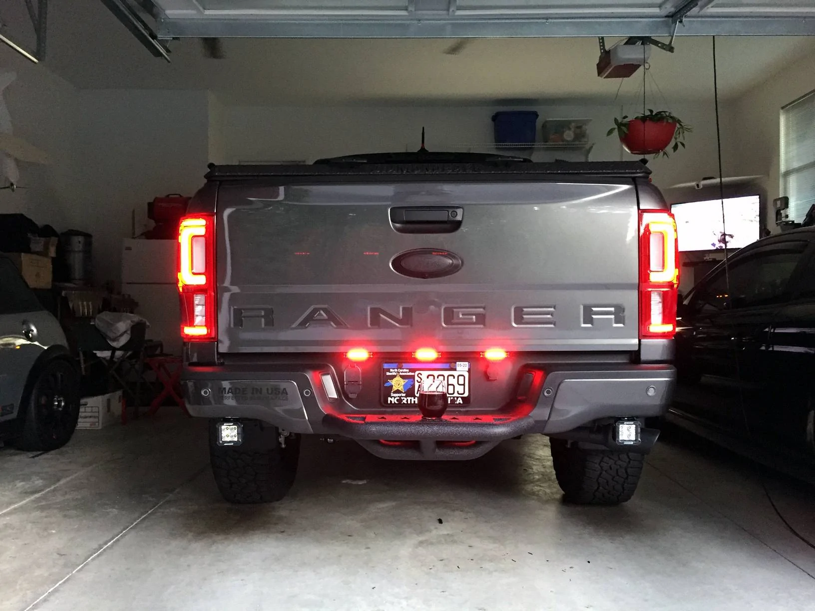

As for the lights themselves, they’re bright with very little amp draw!
Only about 2 amps draw each, but puts out great amount of light.
I have used them on my previous trucks and happy with them.
I got excited when I saw this and then noticed you had it wired to the aux switch. I ordered the Reverse kit and it wanted you to splice into a reverse cable but instructions dont help if you have Blind spot monitoring set up.
Just tried to wire mine to the Reverse light wire and now I get a blind spot fault
