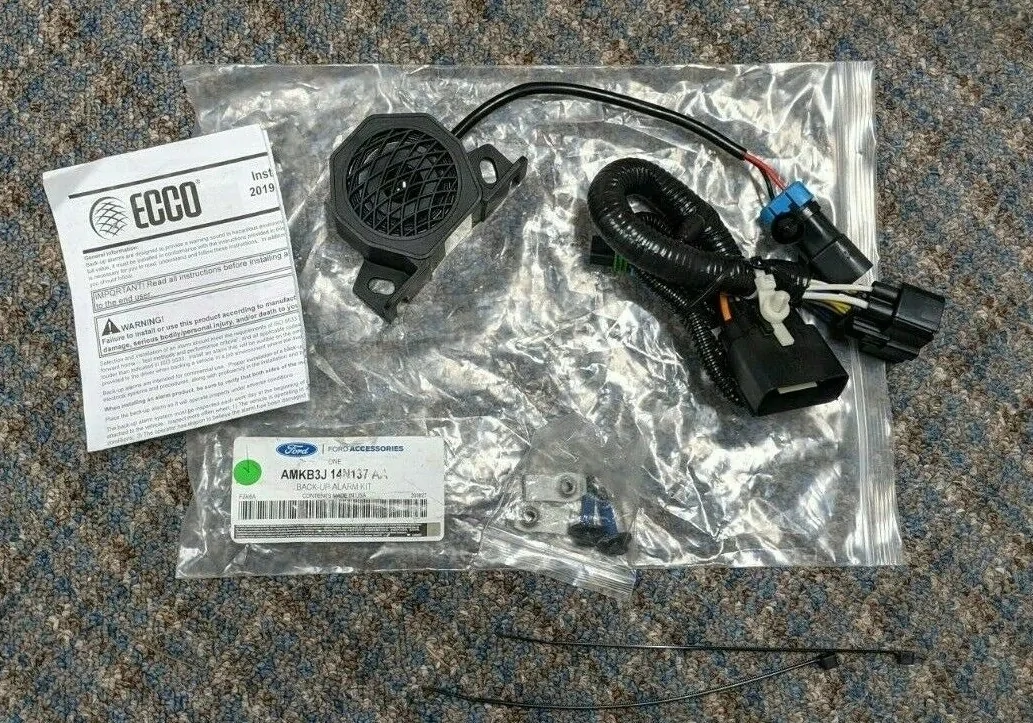

Ford Part# VKB3Z-14N137-A
Pic: Via EBay, It appears they are tapping off the Back-Up Lights via T-Harness, however with the BCM being finicky I am not sure if this would create issues or not (Amp Draw)
I do not have one installed, so I cannot say for sure.
Another option would be (Tap) the Back-Up / Reverse Light (power) to trigger a relay and then tap a 12-Volt Power source for the horn.

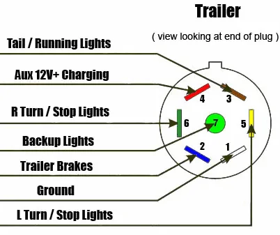

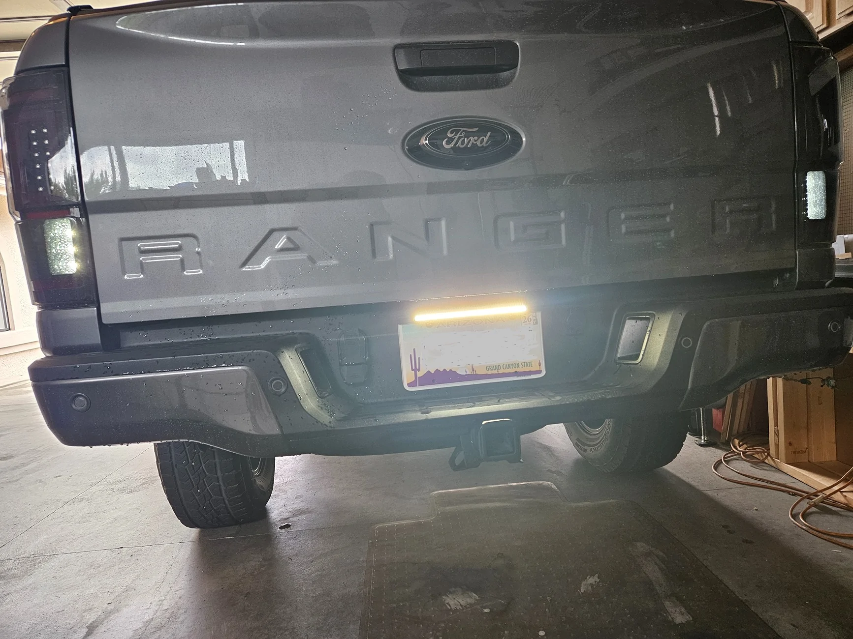

If you have the 7 pin trailer connector, use that. Easy to connect with a T-Tap on the back side. I did it for my extra backup light.
