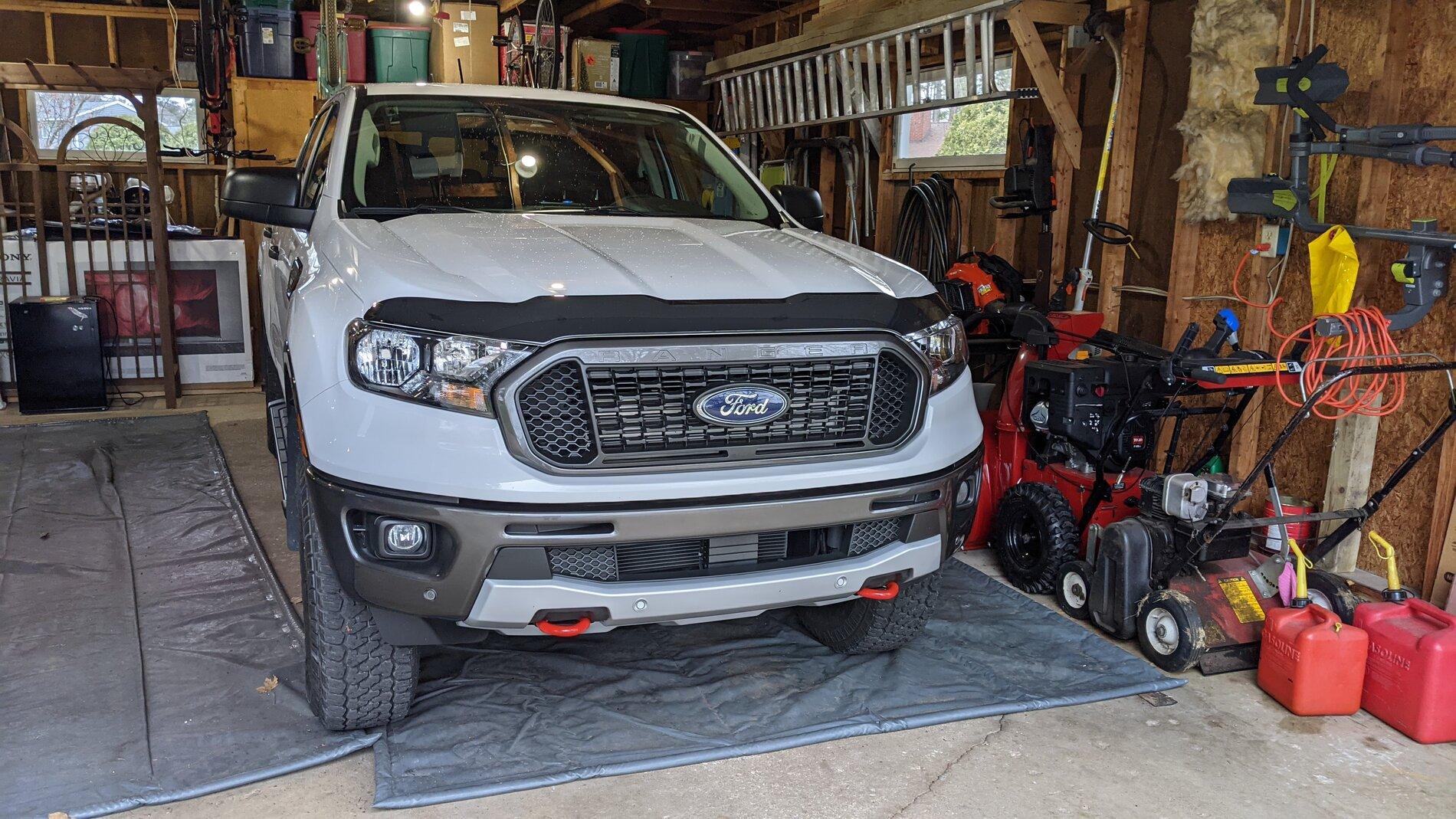

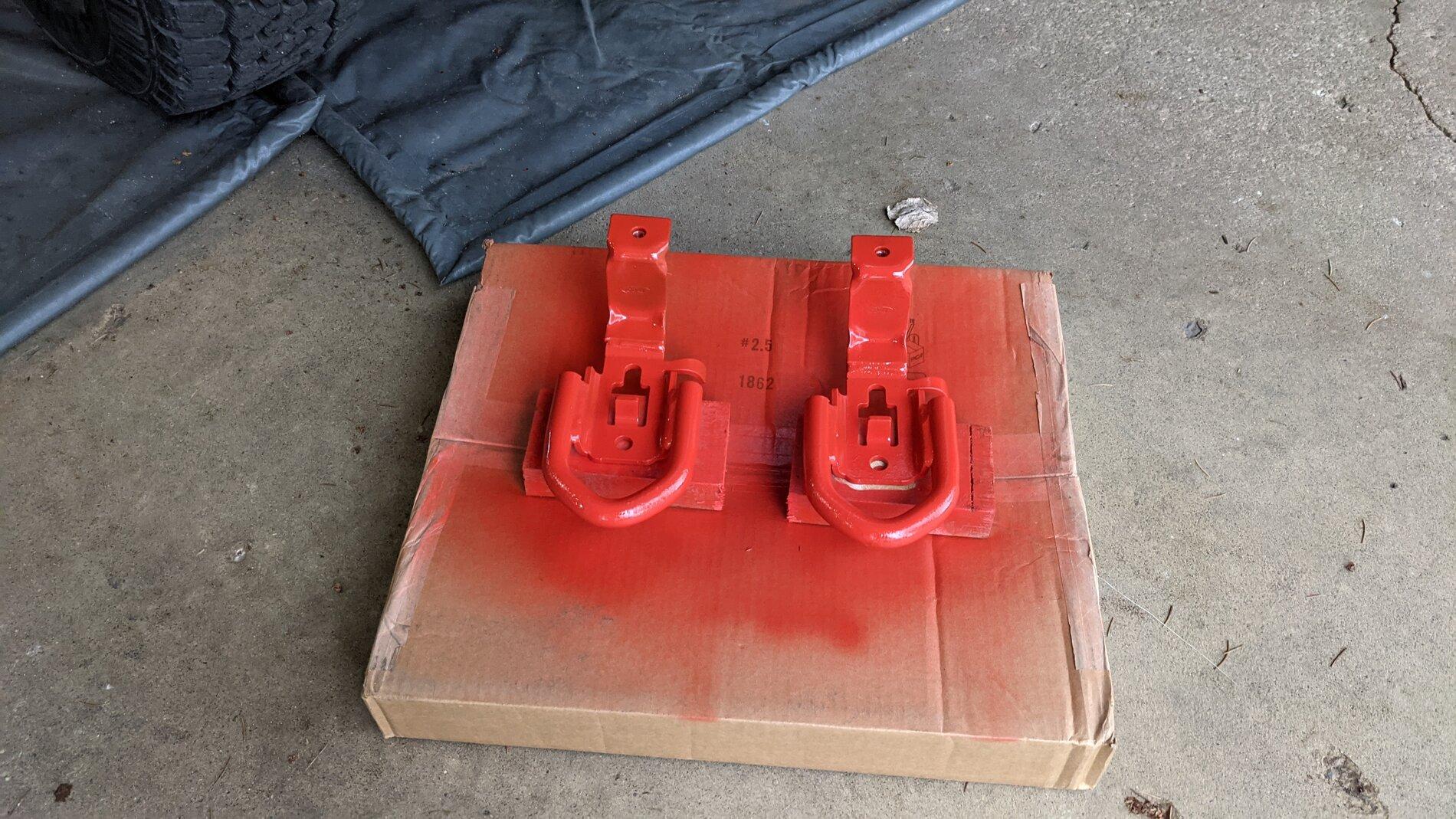

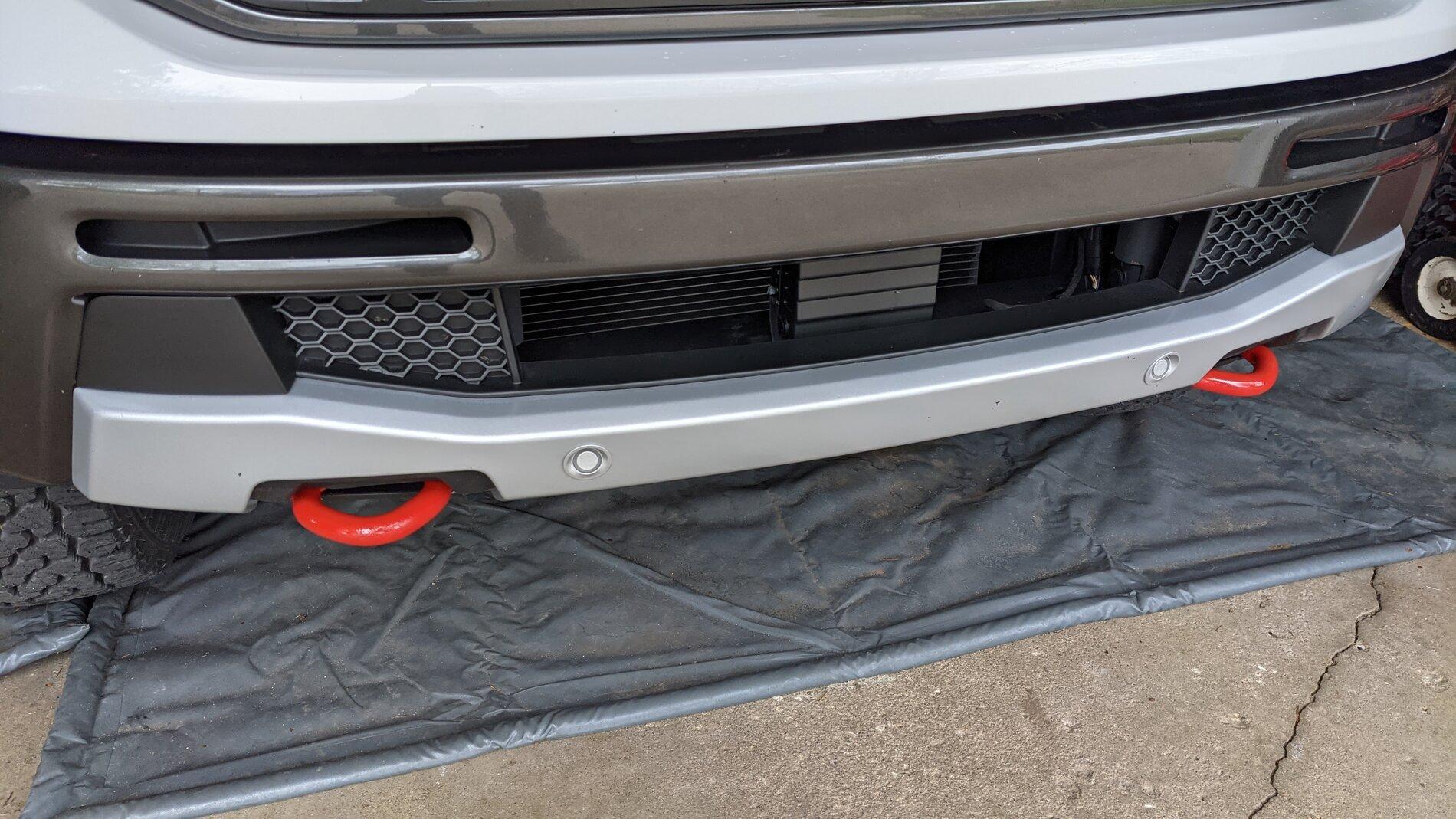

Ford wants $109 for a set of red tow hooks. Rust-Oleum is only $4.79 a can. Pretty much a no-brainer. ?
Super easy to do, 15 mm and a quick removal of the skid plate and you have full access. You don't even need to take off the back bolts as there are slots that hold up the skid plate and tow hooks, just loosen them.
15mm for both the skid plate and the hooks?

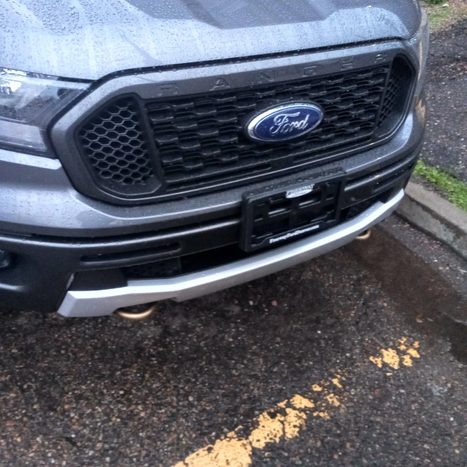

Inspired by OP, I did mine yesterday in gold on my carbonized Gray. I call gold!! Haha jkjk. For under 10 bucks a can I love it. Subtle. I took the pics in overcast/rain/evening. If someone wants me to post better pics let me know.
Ps I have to reinstall the rubber grommets that go over the hooks, paint was a little tacky when reinstalling at 9pm
