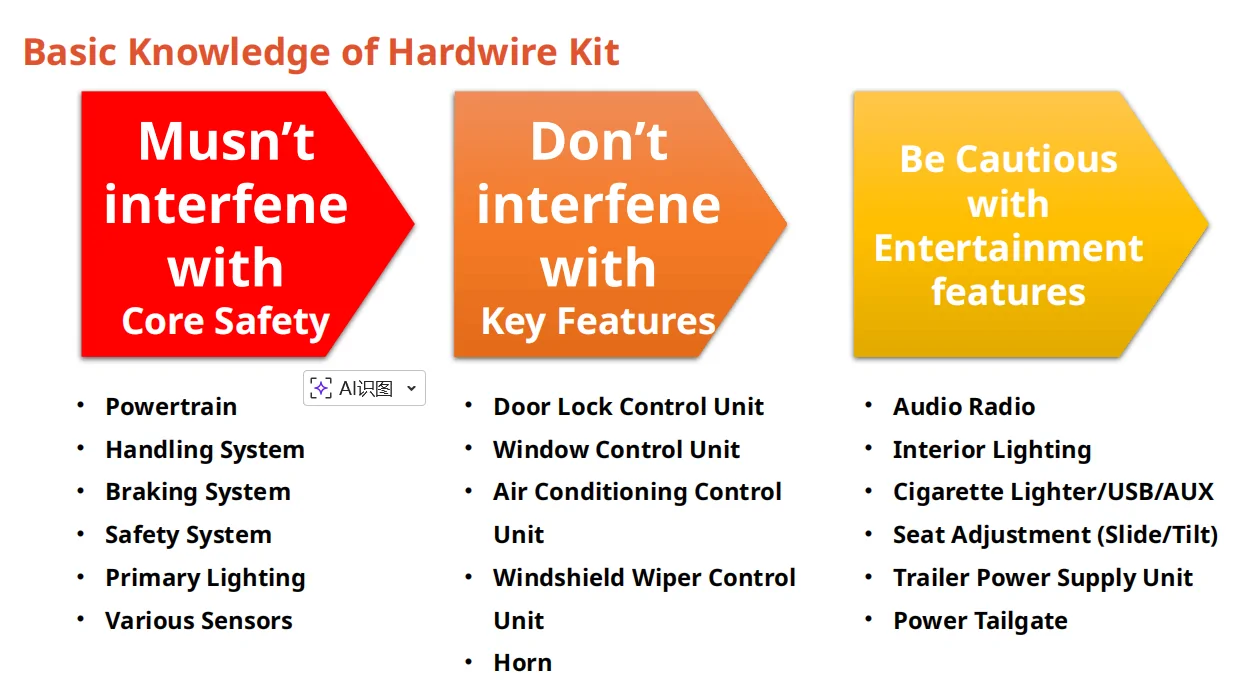

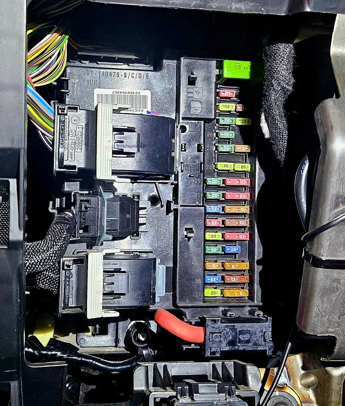

  1. Locate Your Fuse Box: Check your vehicle’s manual to identify its location. Common spots include under the dashboard or hood.

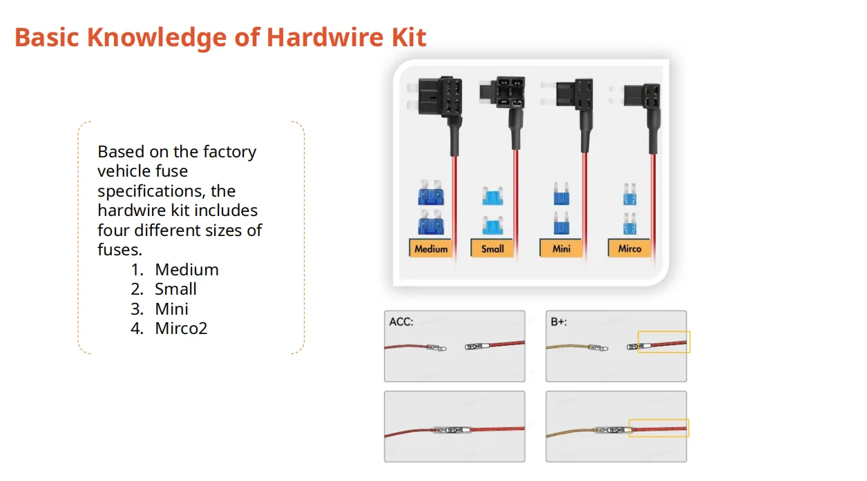

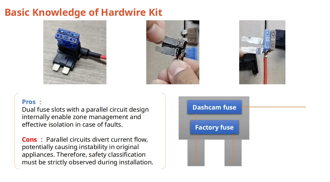

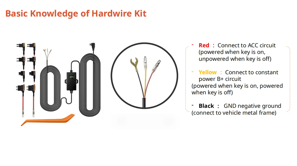

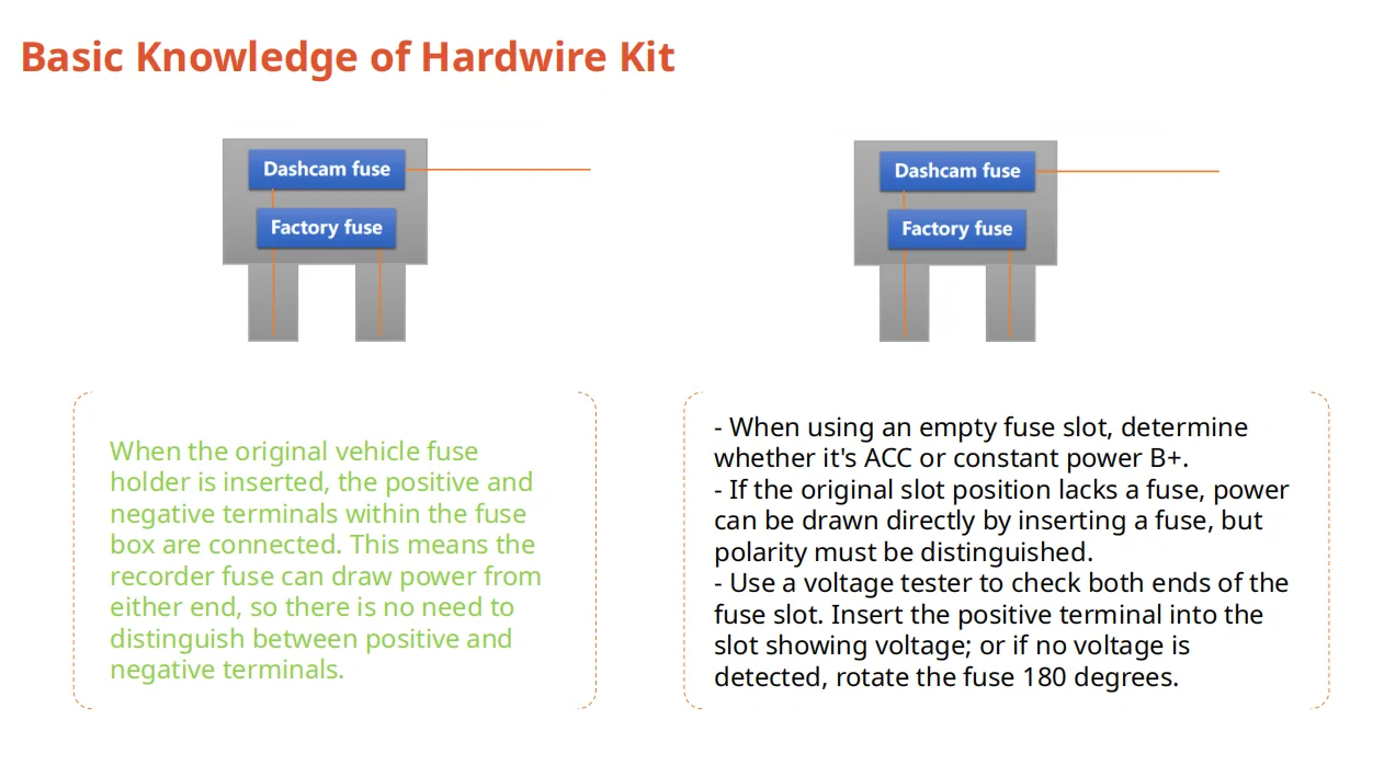

  2. Choose the Right Fuse Slot: Select a fuse slot that provides power only when the car is on (ACC) and another that’s always powered (BAT).
  3. Connect the Ground Wire: Secure the ground wire (black) to a metal bolt or screw that’s connected to your car’s chassis.
  4. Add Low-Voltage Protection: Ensure the hardwire kit has built-in low-voltage protection to safeguard your car battery.
Pro Tip: If you’re unfamiliar with fuse boxes or wiring, we recommend seeking professional help to ensure a safe and proper installation.
