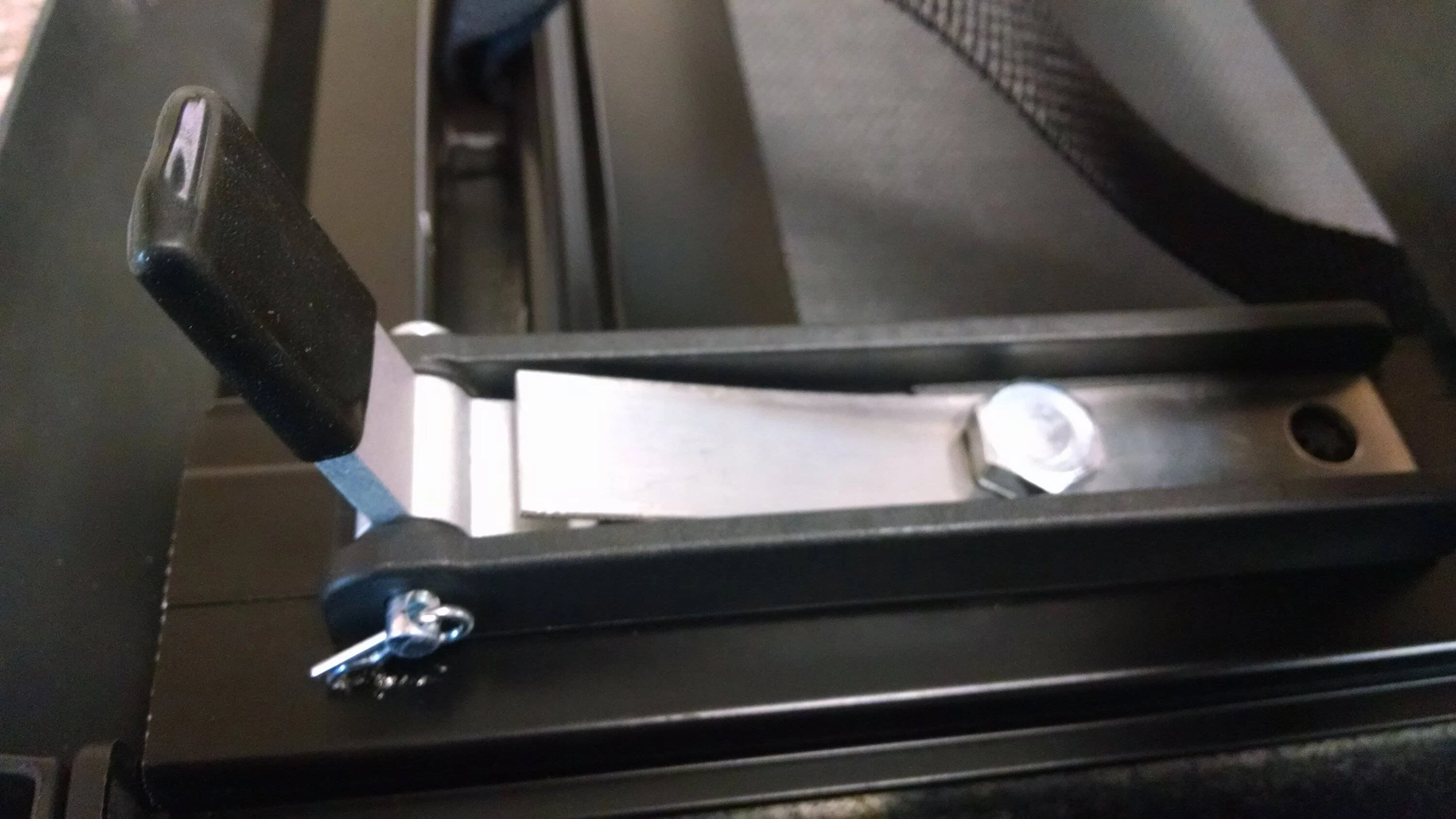

Does anyone have a drivers side rail for the lo pro tonneau cover for the 5 foot bed they want to part with? My trigger on this one is loose and the cover will not stay closed over bumps with out a jerry rigged string system I currently have.

So I contacted them and it turns out it must be a common problem I was having. My drivers side trigger was loose and anytime I hit a bump the cover would pop open. She sent me this picture and I checked mine and neither of my triggers had the metal piece over the trigger latch. They were both under it so I just had to remove the bolt and pull the metal piece on the outside of the trigger as in the picture and reattach the bolt. Haven't had an issue since. After 2 months of research and jerry rigging I'm grateful to be done with it!
