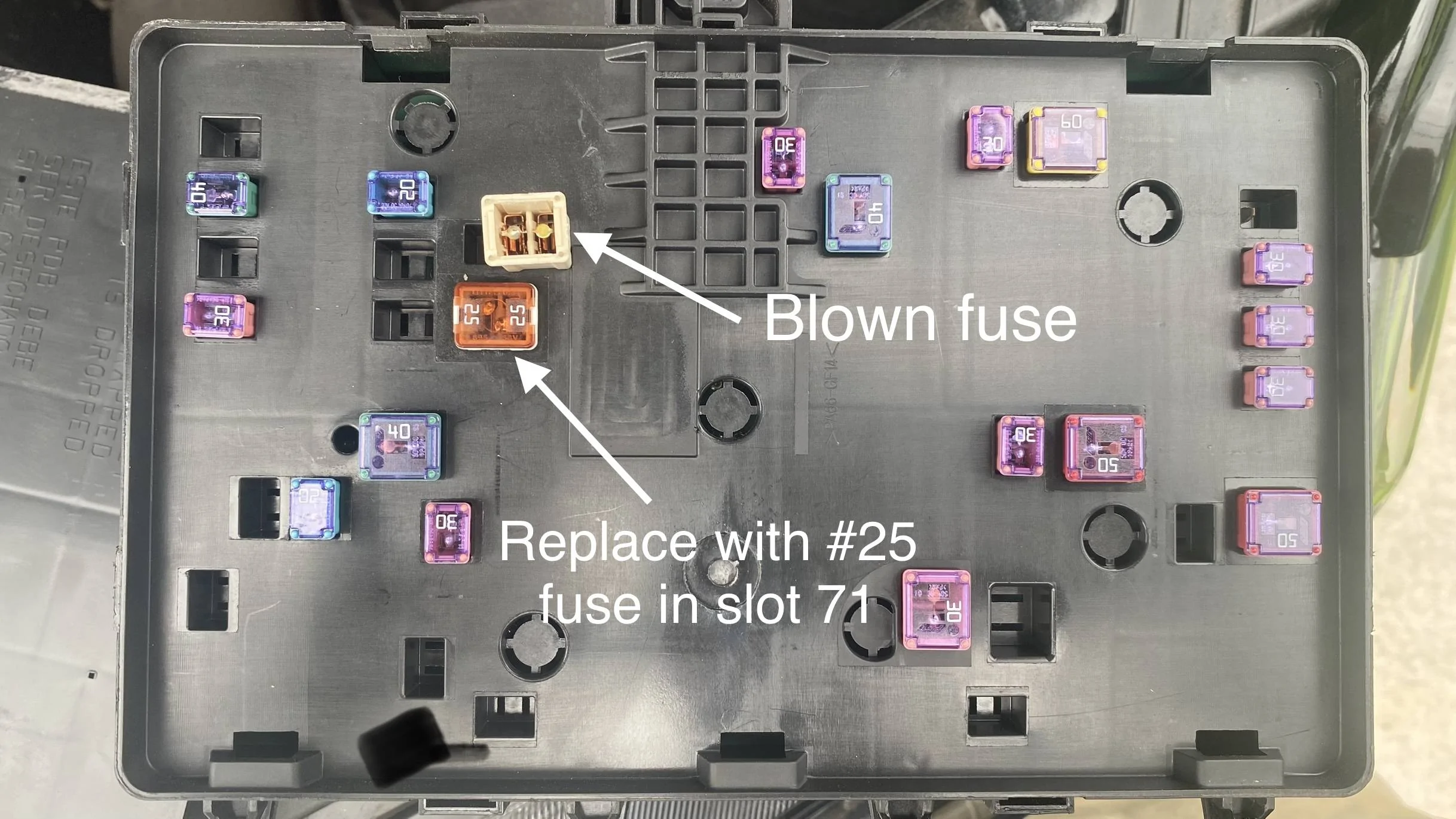

UPDATE: 10/22
Trailer running lights issue was solved by replacing # 25 fuse, located in slot 71 in the lower fuse box, under the hood.
There seems to be a confusing info on here about the factory installed tow packages TRailer Module. The trailer power connector still has a fuse that can blow. Changing it fixed my issue.
[SOLVED] I have the factory installed tow package, but I’m having an issue with my trailer running lights. The brake lights and turn signals work, but running lights don’t. They did for a minute, but I feel like something shorted, and I cannot find a fuse to check or replace.. Been searching the forum and found a few little bits of info, but nothing that really helps.
From what I understand is that the bottom fuse box under the hood doesn’t have fuses that control the trailer lights and that the fuses indicated in the owners manual are for aftermarket installs, another member mentioned something about a Trailer Module that, which I have no idea what or where that is? Really need some help with this, I feel like this is something simple that I could fix myself and not have to take it in.
