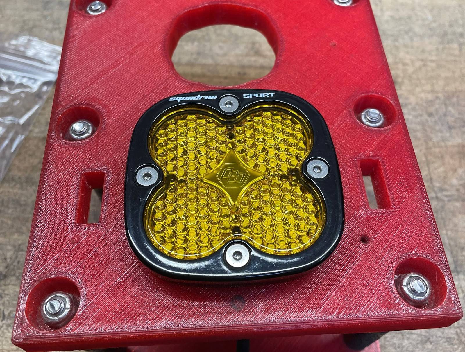

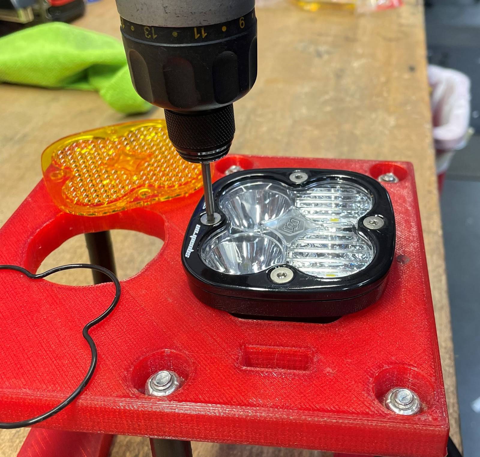

Step 1: Start by removing the 4 M4 flat head screws. This can be done with a drill or a standard Allen Key.

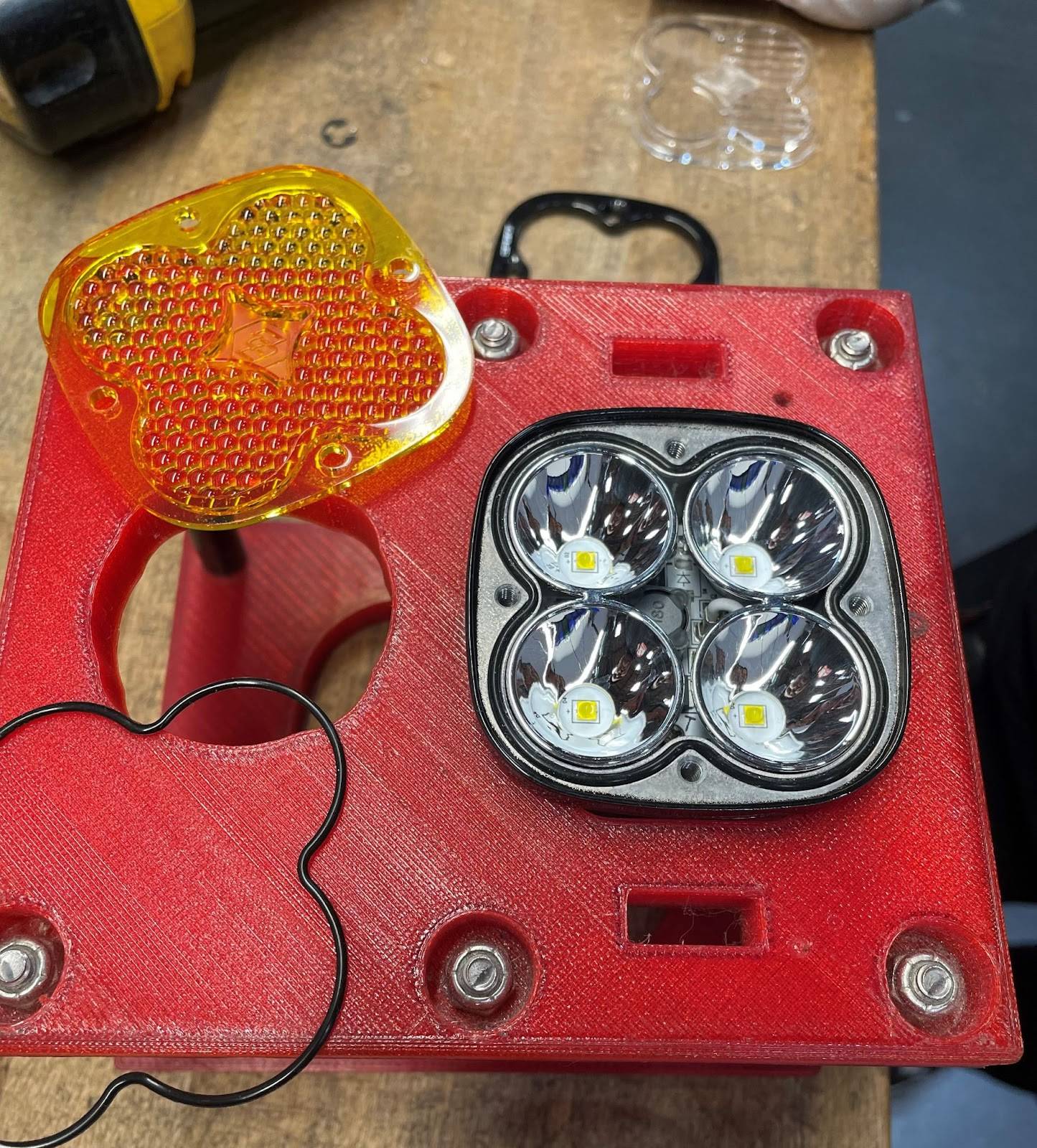

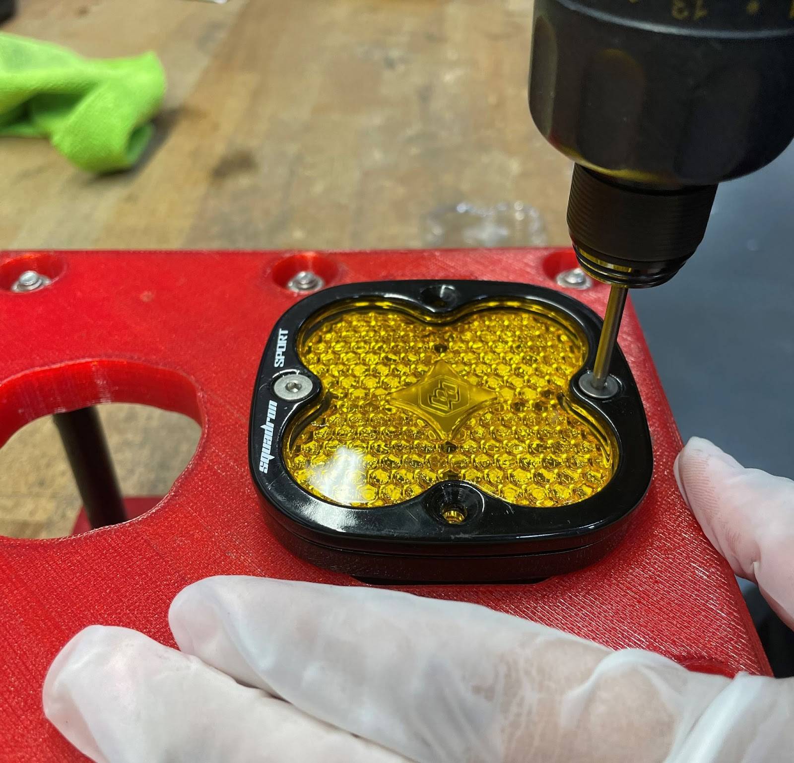

Step 2 : Carefully remove the bezel, lens and O-ring. Place the new O-ring in the groove of the Squadron housing making sure it’s seated properly.
Step 3 : Set the lens and the bezel into place. If you plan on flipping the bezel 90 degrees or 180 degrees now is the time to do so.
Step 4 : Tighten down all 4 m4 flat head screws in a crisscross pattern. The M4 screws will need to be torqued to 3 inch-pounds per spec. Failing to do so can cause moisture to get into the light.

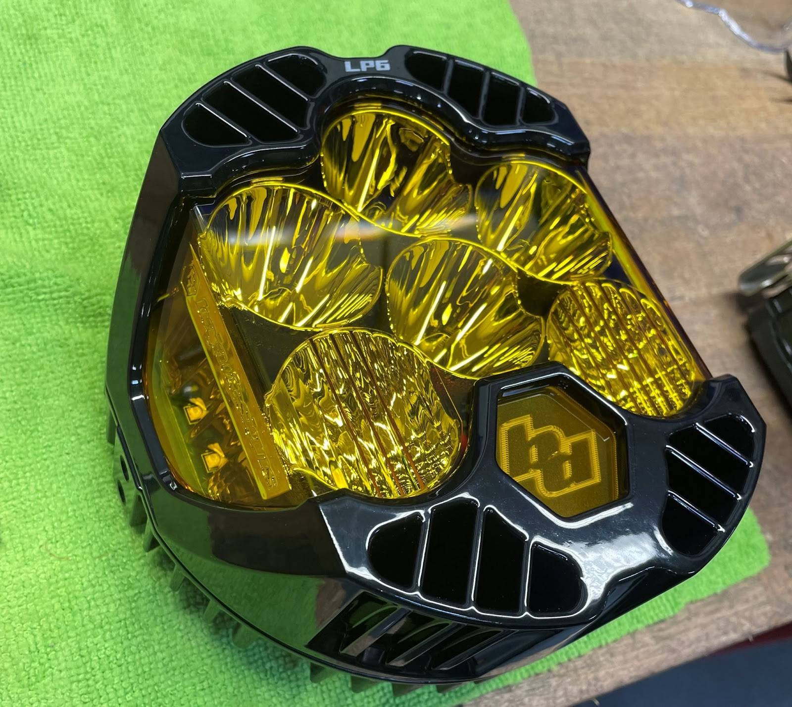

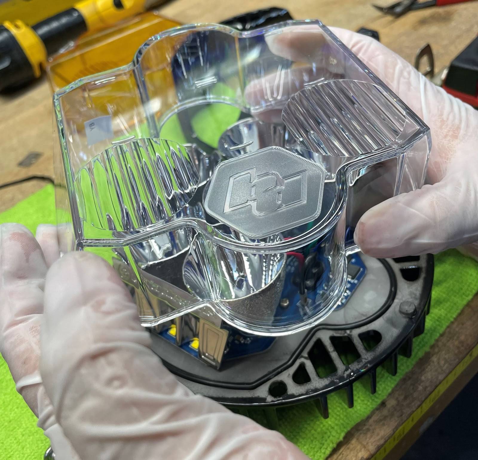

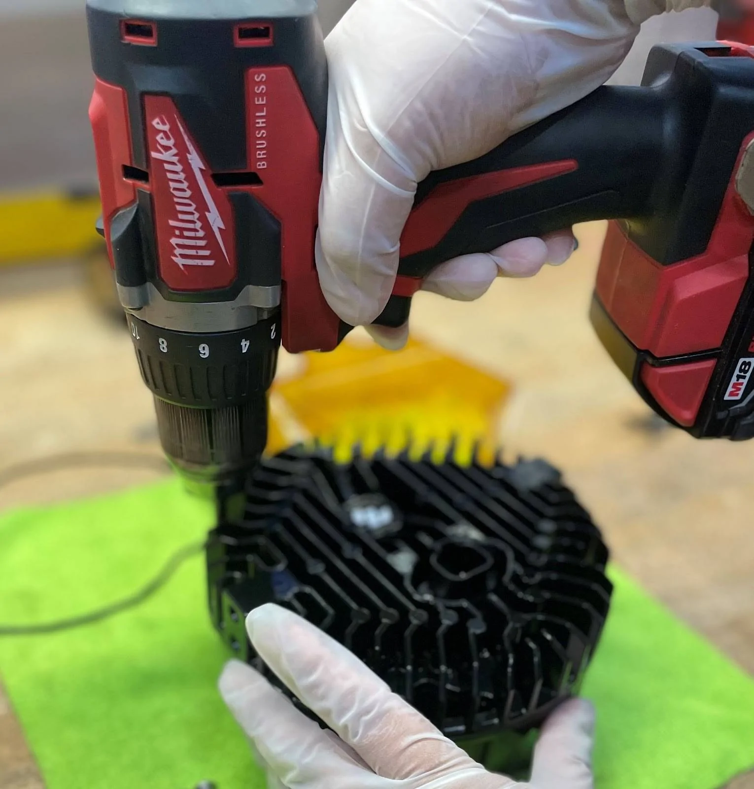

Step 1: Flip the LP6 so the connector side is up and remove the 4 M6 Allen bolts. This can be done with a drill or a standard Allen Key.

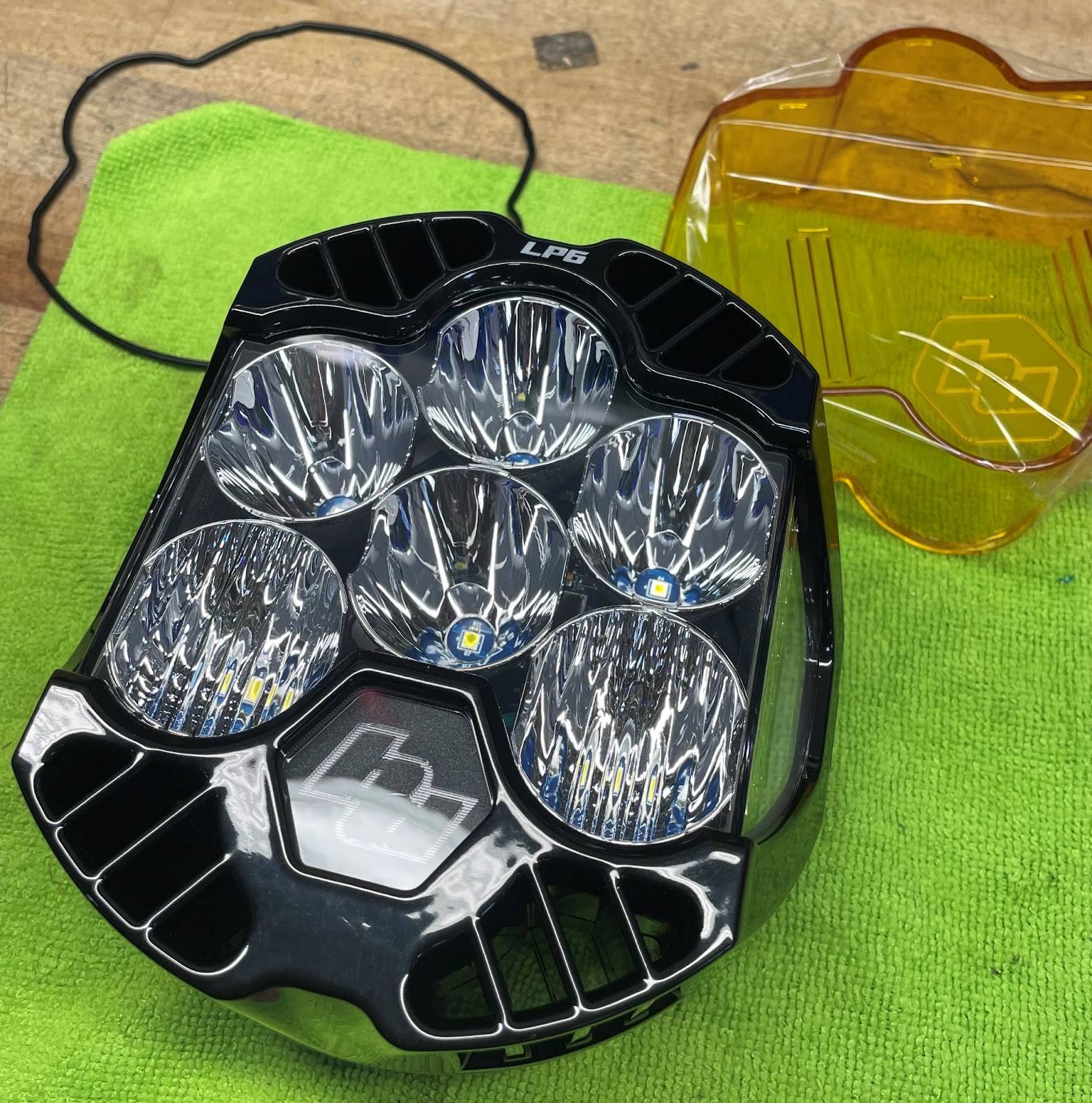

Step 2: Once you have all the M6 bolts removed you can now carefully flip the LP6 back right side up with the lens facing you. With the 4 M6 bolts removed you will be able to remove the LP6 front bezel and lens. Carefully remove the Lens as well as O-ring that seals the lens to the lights housing and replace it with your new lens O-ring and lens.
Step 3: With the new O-ring and lens secured place the LP6 bezel back on the light making sure that the lens O-ring has been seated properly. The lens O-ring is a very important aspect of this because if it is not seated properly it will allow moisture to enter the light.
Step 4: This is the final step to get your LP6 Switched over to an amber lens. Once you have insured that the O-ring and lens have been properly set with the bezel on top, flip the light back over and reinsert the 4 M6 Allen head bolts back into the lights housing. We recommend tightening these in a star pattern allowing for the proper amount of pressure to be applied. Each M6 bolt will need to be torqued to 25 inch-pounds per spec.
