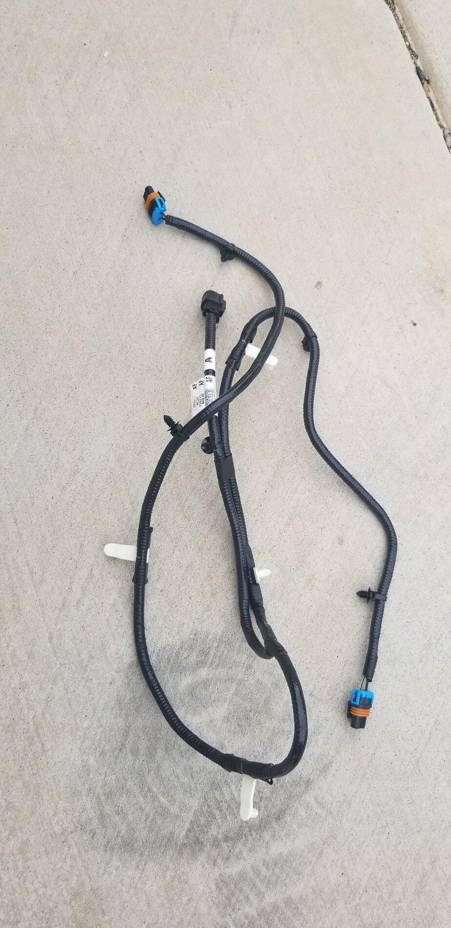

Hello. I recently purchased a factory wiring harness and headlight switch that can control fog lights. I cannot locate the plug for the harness anywhere on the truck, a 2020 XL. Is there going to be another harness or extra wiring needed? I'm feeling a little frustrated here. Any help would be much appreciated.

I'm trying to add parking sensors to my XLT with fog lamps. When ordering the harness I noticed three options. (fog lamps only, fog lamps with parking, and fog lamps with parking and addapive cruise control). There might be a chance that if you have none of the three features the wiring is completely missing from your build.
501-19 bumper uninstall had all the locations of the connectors you are looking for. Document can be found on the forum here....
https://www.ranger5g.com/forum/threads/2019-ranger-technical-shop-manuals.1548/

Thanks,and being an XL,I have none of that...
May have to make a trip to the dealer,and see what we can come up with.
