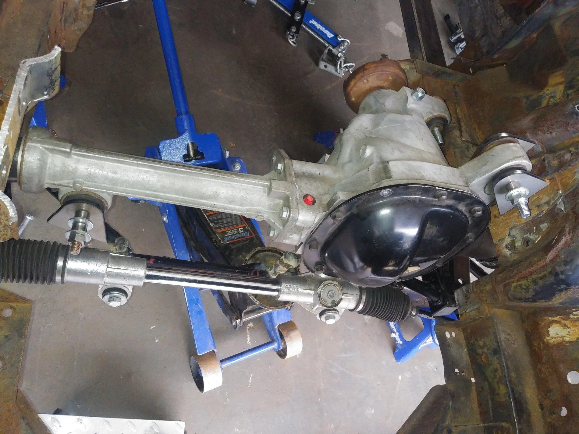

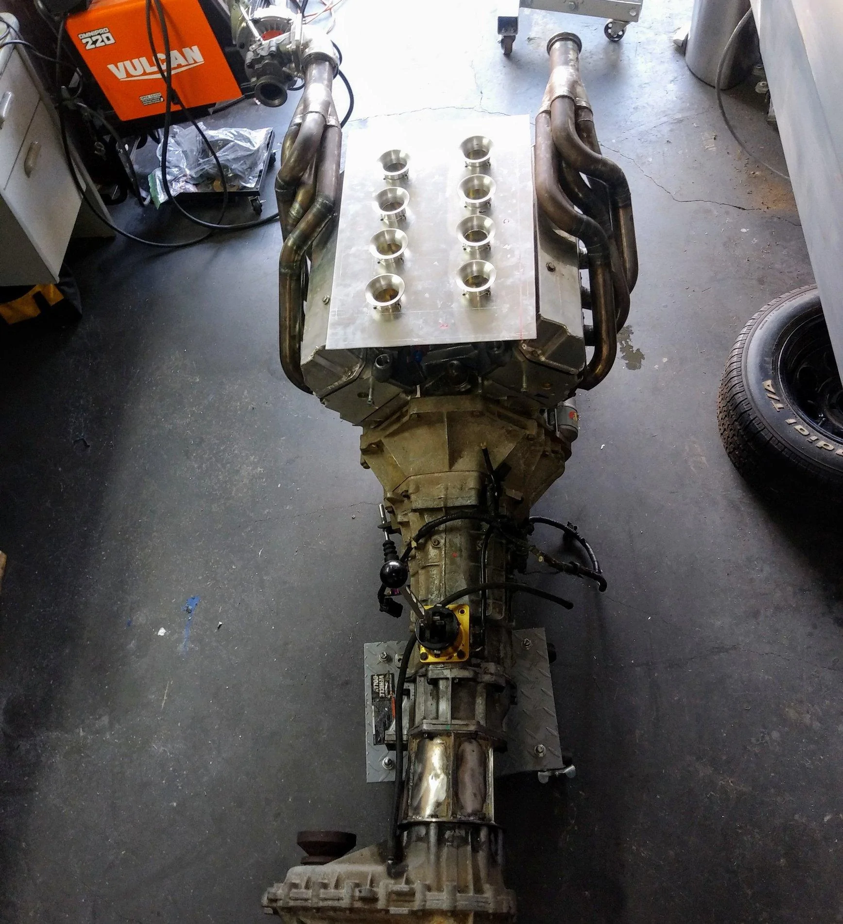

Yeah I do some crazy stuff. The bed conversion is probably on the easier side of the things im doing. To compare I have a 69 awd twin turbo itb independent cantilever suspension fairlane cobra fastback that I have been building. The bed conversion seems strait forward compared to that.

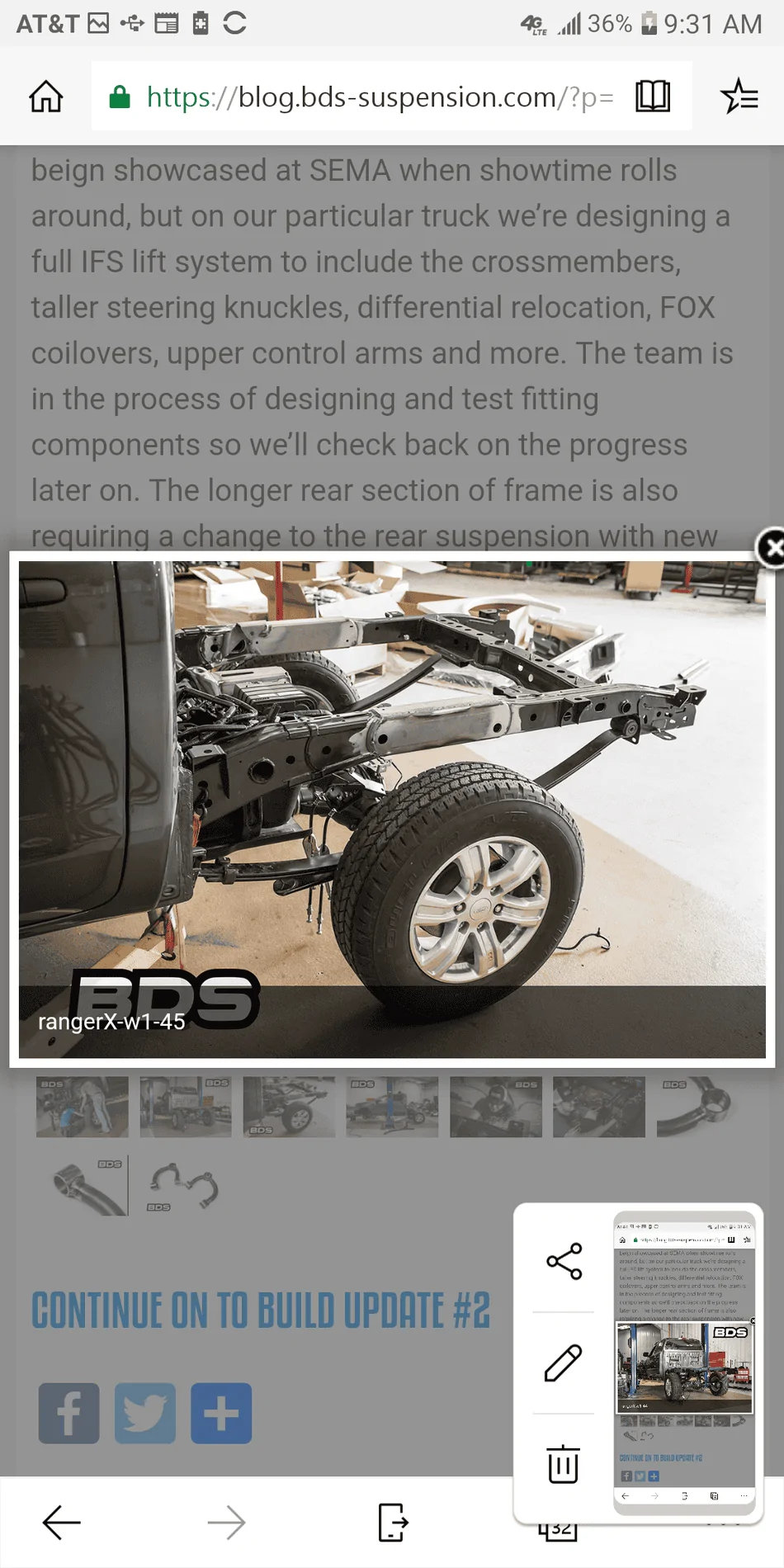

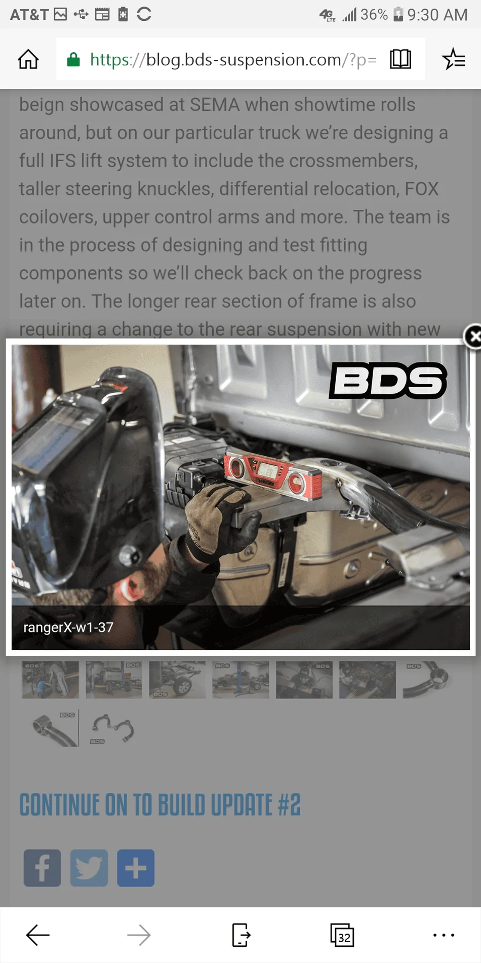

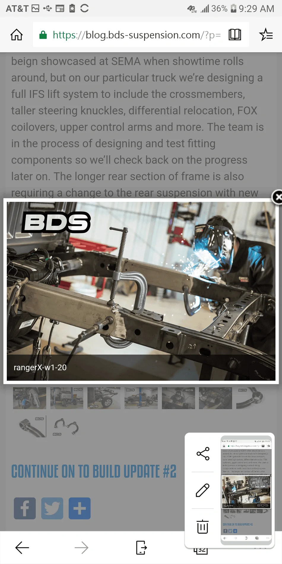

So as far as the swap goes, I will need longer leaf springs, relocating shock mounts, extended brake lines, extended driveshaft, and extending the frame. These guys at BDS extended their frame 10 inches. It seems pretty strait forward.

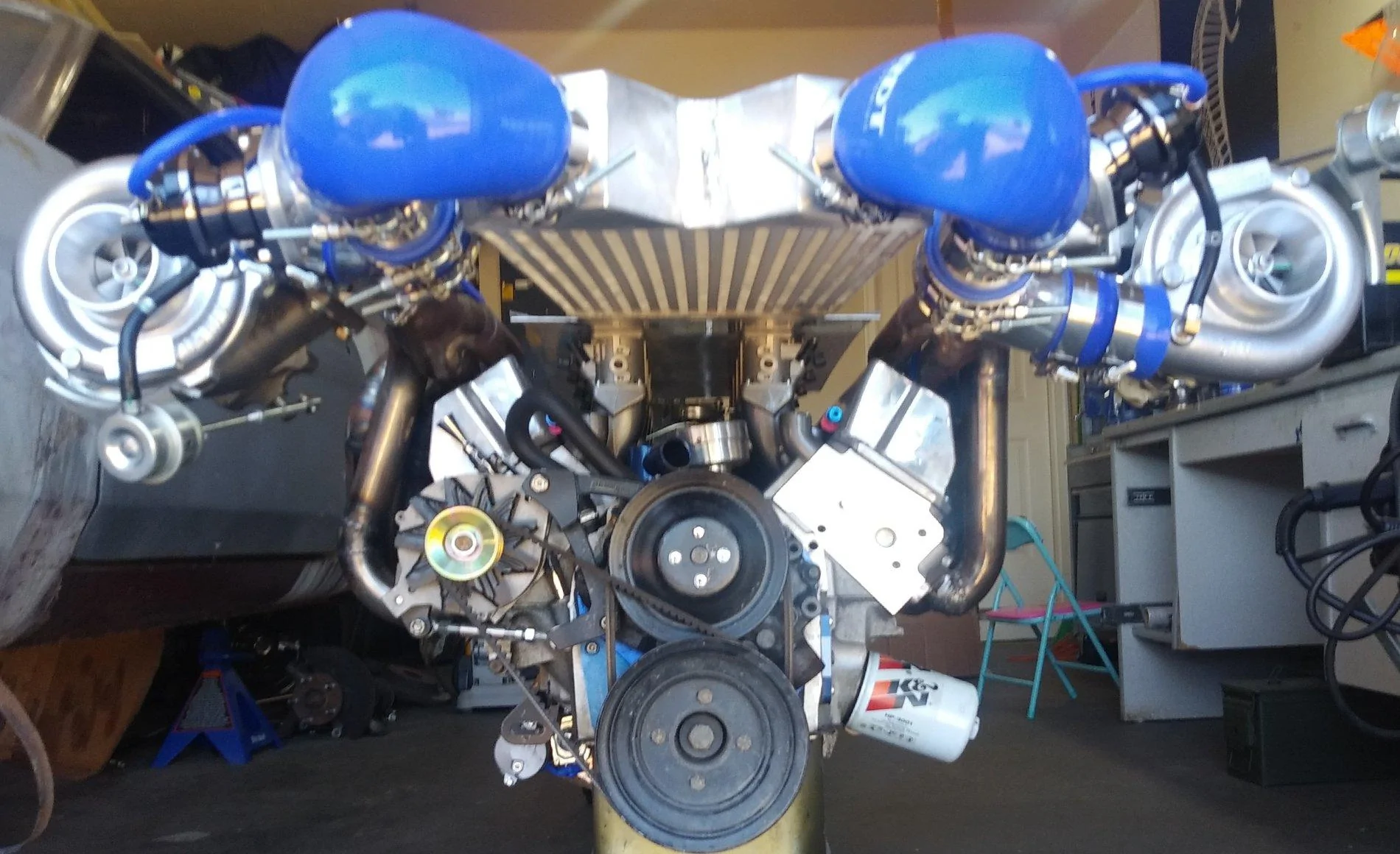

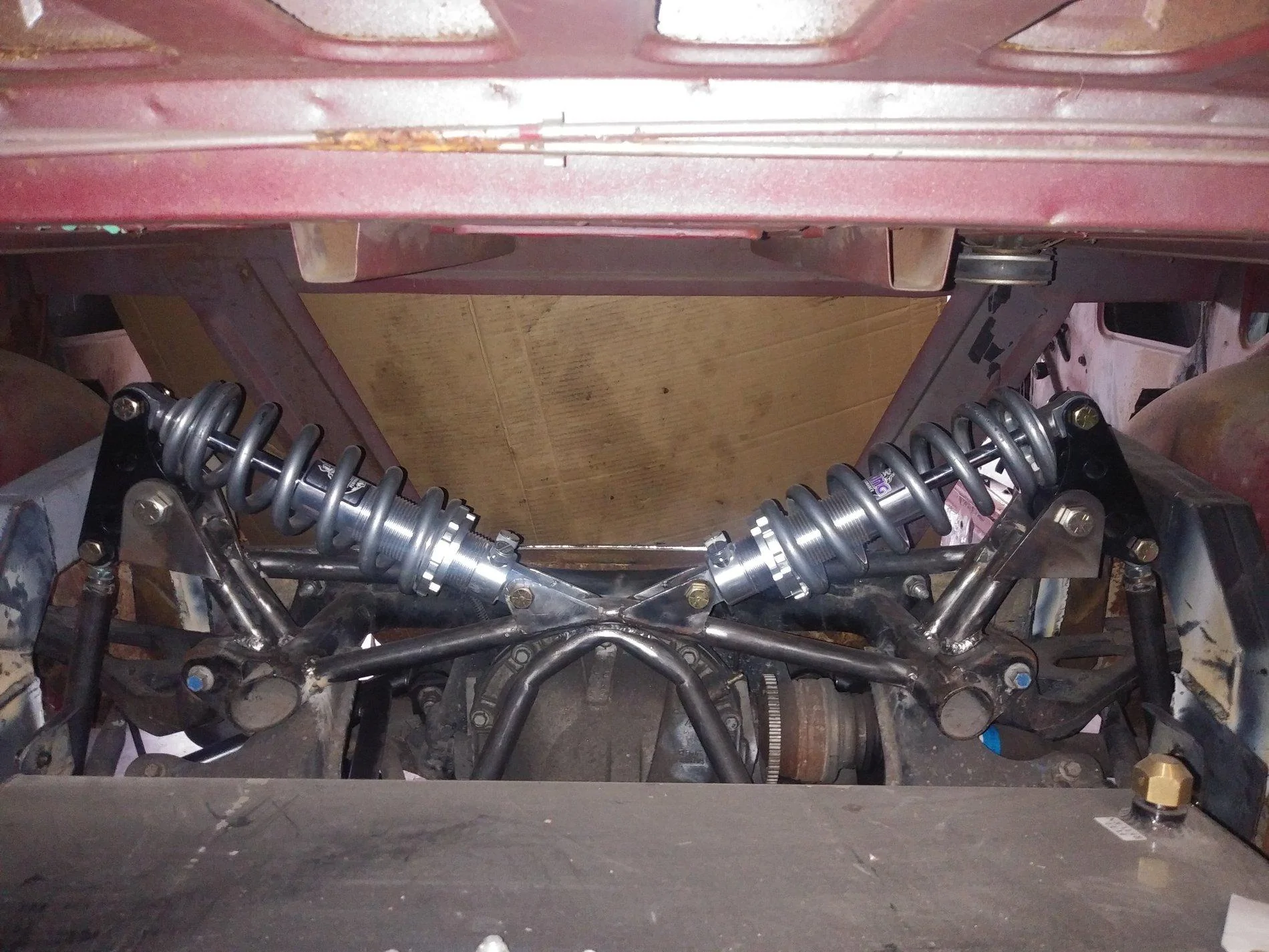

Now you can't say something like this without including pictures!! Or videos!! :beer:
Long bed crew cab does sound cool! Definitely going to follow this!
AirborneRanger
Wil
Nov 7, 2019
70
96
Yelm washington
69 Cobra SCJ, 19 Ranger FX4
11B4V
You are absolutely right! My apologies. This 69 cobra is just like my wife. Its a love/hate relationship and im always working on her to make her better.
