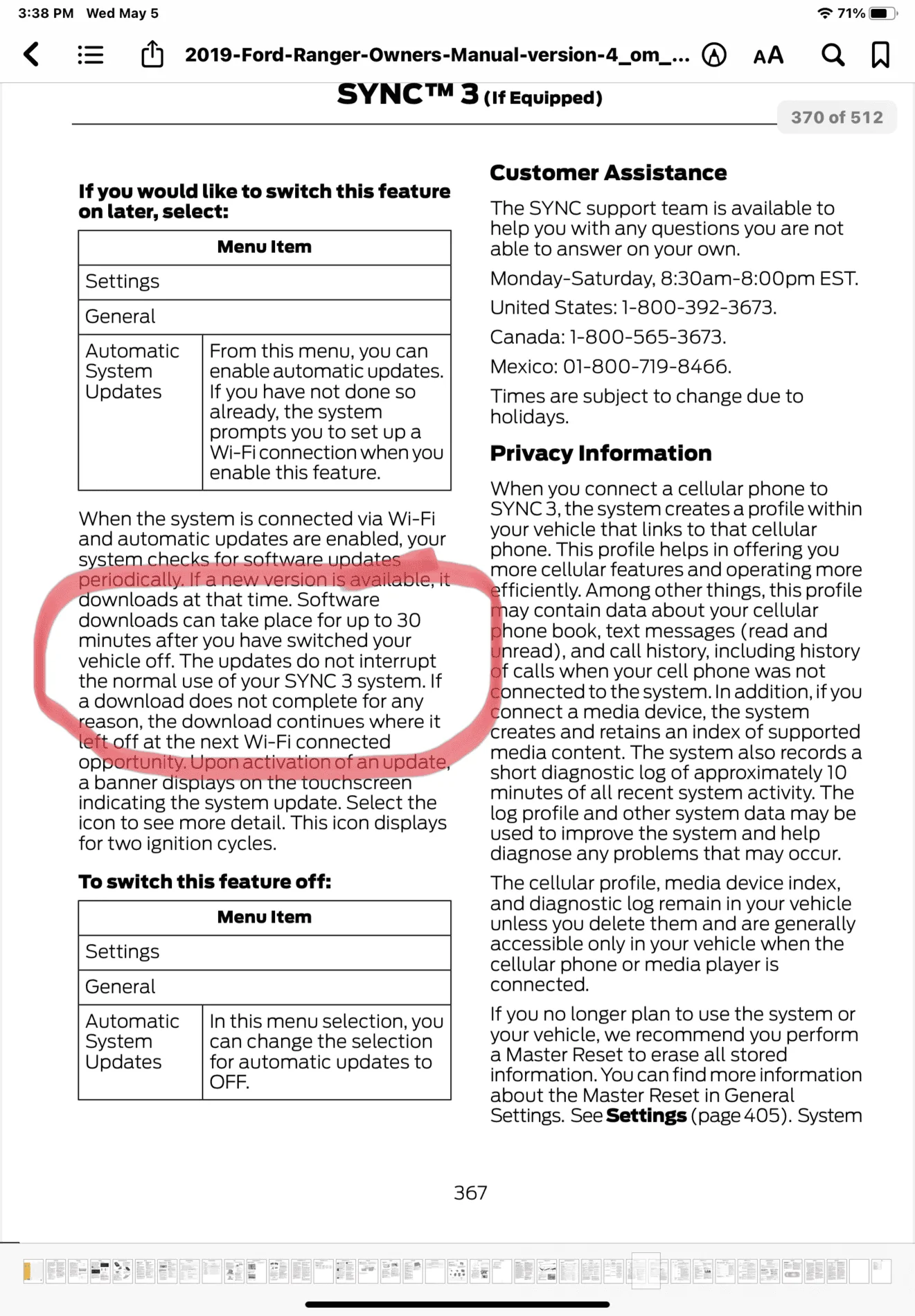

So... I began an update with the home network. I see stuff that I don't recognize. With that said- can't Ford allow these under normal driving conditions?
This has been multiple hours of trying to be compliant. I'm still trying...in my garage...to participate and be a loyal Ford owner. I cannot believe that it's so impossible, with any intent, to be so customer or owner not responsible.

I tried the WiFi, and it worked.
I had to cycle the 30 minute window a couple of times, but downloaded a couple of files. I finished the Sync and the map files.
Ranger was off, in the garage, I was putzing around doing other things.
I think I'll spend the 40 bucks on beer while I do the update.
Good luck.

This. It'll download the update in chunks until it has the whole update, and then it will apply the update.
So basically just park near WiFi when you can and each time you do it'll spend up to 30 minutes downloading what it needs until it has the whole update and applies it.
Yup....
