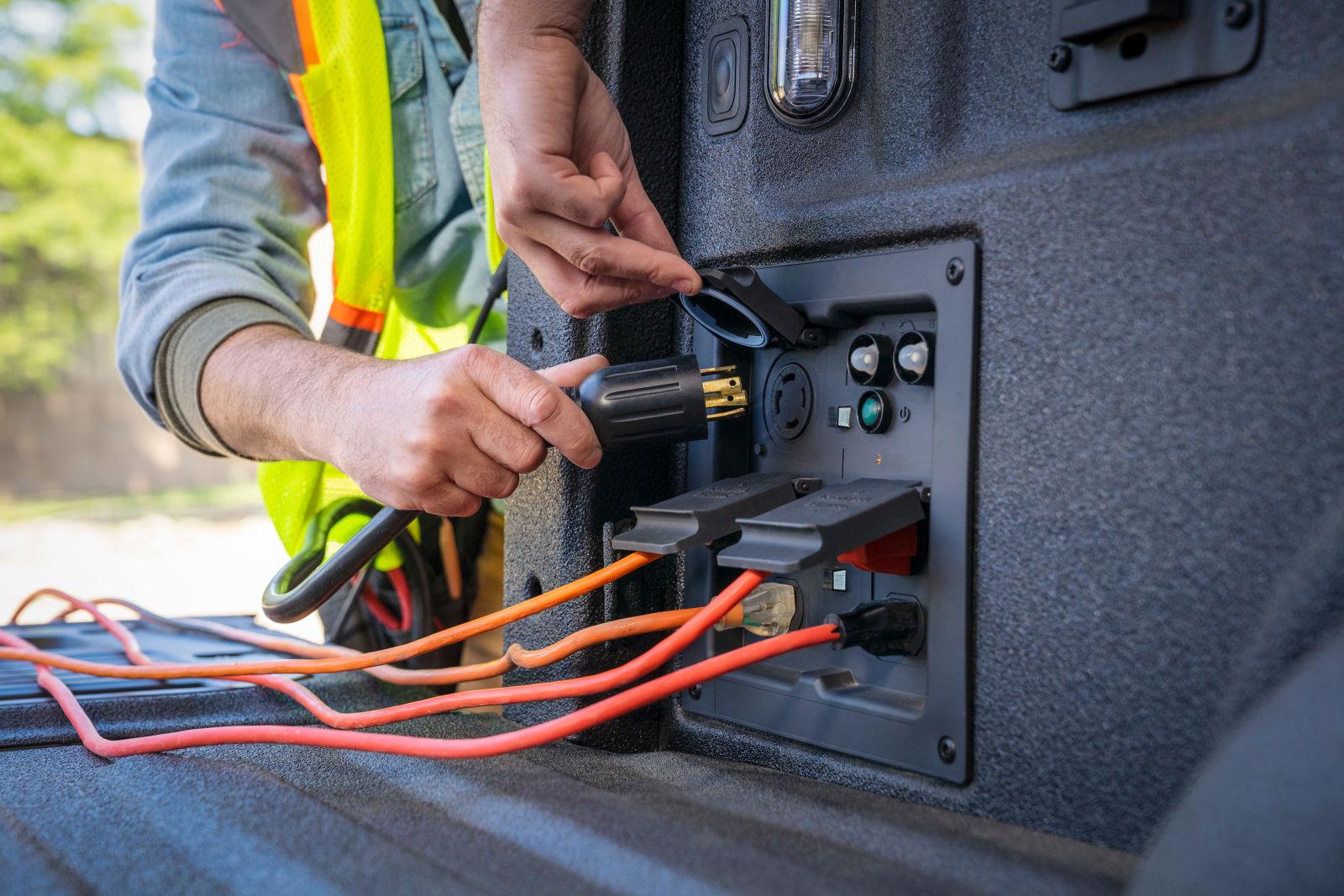

Wish this was an option on the Ranger

Will this be an option on all F-150s or just the Hybrid model?

I believe it'll be an option on all models, at various power levels. 2.0kW option, 2.4kW option, and 7.2kW option on the hybrid models. Which is an insane amount of power.
Apparently the hybrid will also be available on all models as well.

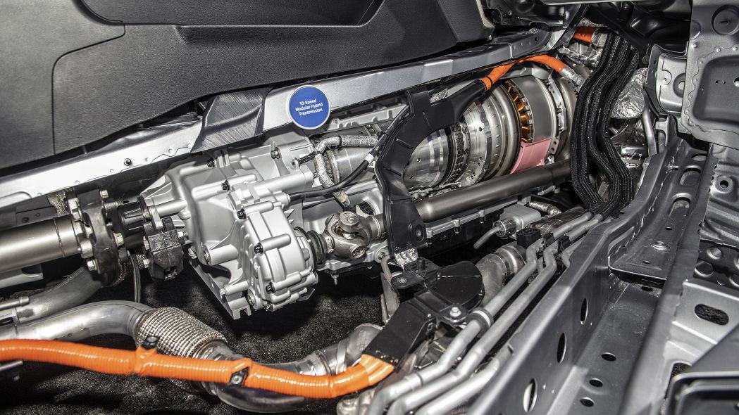

Agreed it is the 3.5L Ecoboost only and should be available across a wide range of trim levels. Per Ford's press release and technical specs (The PDF attached) that hybrid uses the 10-speed "Modular Hybrid Transmission", which on the Explorer and Aviator, uses an electric motor sandwiched between the engine and the torque converter. This is a little different than the Escape/Fusion and Toyota hybrids, which connect the electric motor to the engine via a planetary gear-set and a CVT transmission.
Here's a cutaway from this link of the Explorer's hybrid system, you can see the windings of the motor towards the right side of the screen:
https://www.autoblog.com/2019/06/18...rid-first-drive-review-49v5fj7/#slide-1278677
All that's to say, the hybrid system makes the hybrid F150 a lot better at generating the continuous power needed for such a large inverter. Something like a big 12V 5000W inverter will only run at peak power for about 15 minutes on a 100Ah battery, so the hardware is still impressive.
