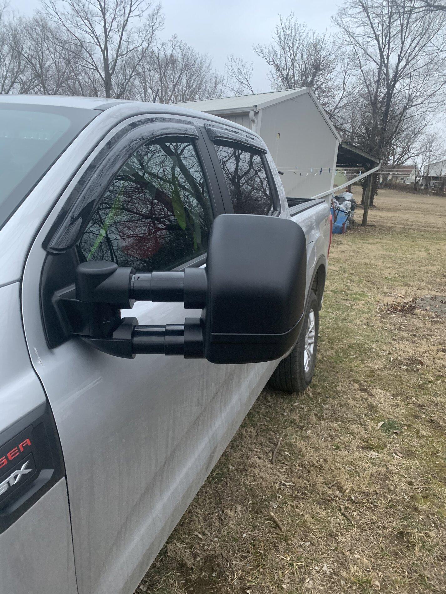

Can anyone from Europe get me a wiring diagram for the mirrors circuit on your version of the Ranger. Our plugs are different from yours and would like to hook up my tow mirrors from clearview mirrors. Thanks for anyway you can assist me.

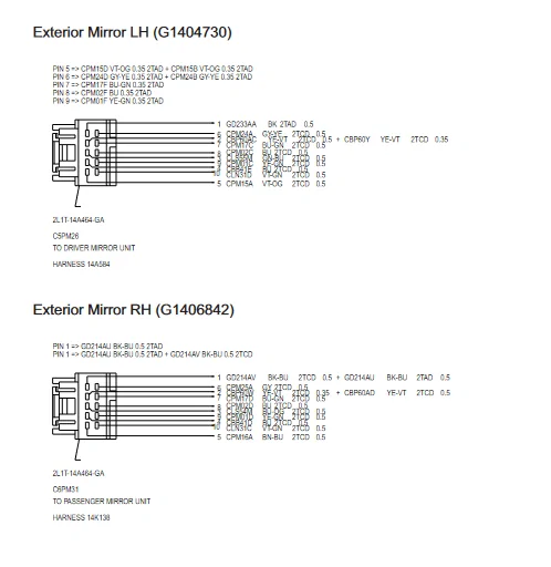

Try THIS - section 509
Here's a screen shot

Cool thank you sir. Appreciate the assistance
Let me know if you have questions - I have a whole thread on changing XLT mirrors for Lariat ones(Link in Sig).
I dont know if the mirror connector is same type, but if so yu could use the pins I link to

Appreciate this. My mirrors are aftermarket from Clearview Australia

Does the connector in the mirror look like the one in our mirrors? maybe less or more pins, but same shape?

It’s close but will not connect. Going to repin to our rangers plug. But needed the European ranger wiring so I can match to our schematic
