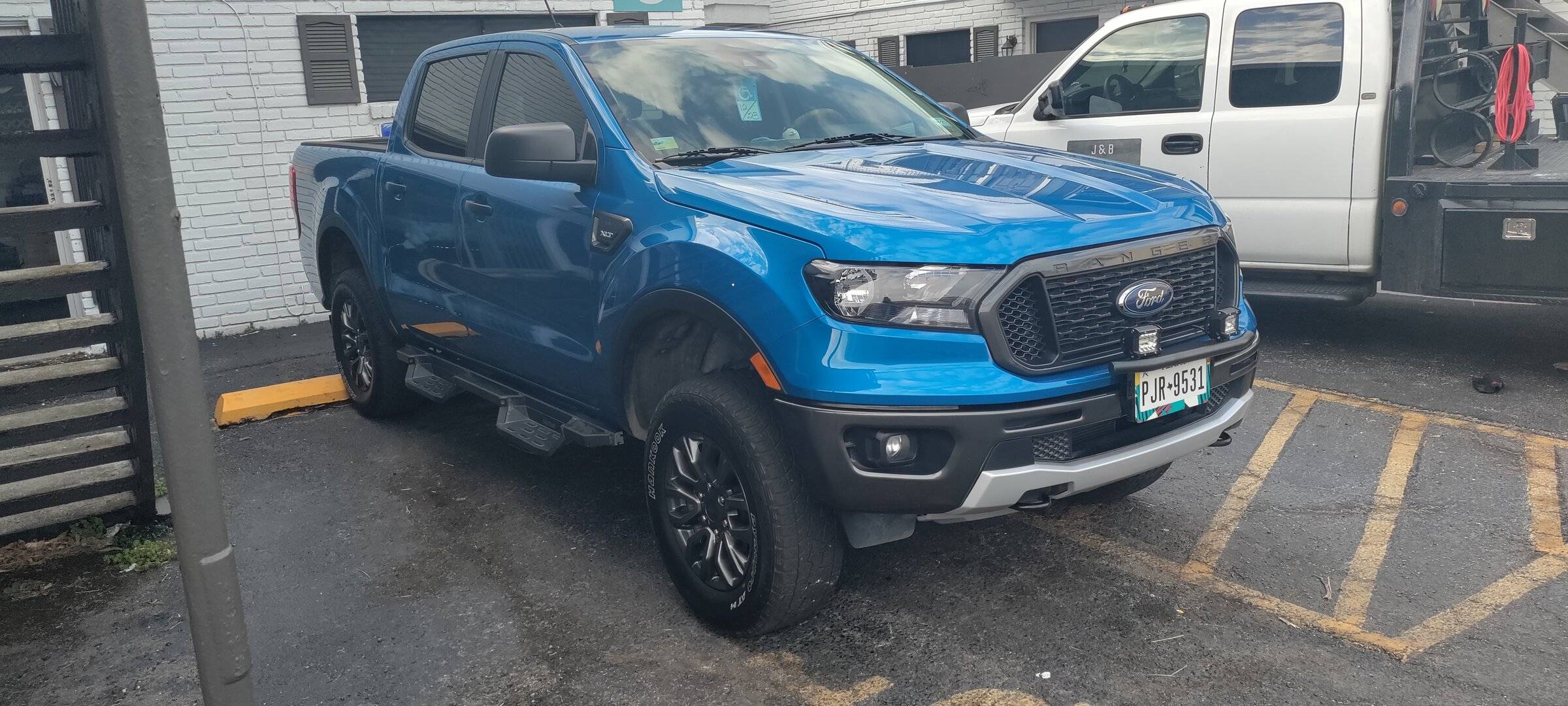

I have the 3 1/2 BDS kit. with 285 7017‘s the other day I saw one in the parking lot with what looks like a 2 1/2 to 3 inch level kit no upper arms. It had 305 17s no cash bars and trimmed bumper and valance from what I could see. It had aftermarket wheels not sure what kind.
