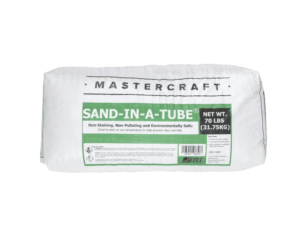

two or three of these should take the 'snap' out of the springs and feel more planted.
From Menards website, HD or Lowes has Sakrete brand sand tubes.

I have definitely done that a few times simply for winter traction. It's amazing on how much that helps

Yes i have them also the Sakrete sand tubes @60lbs x3 works very well.

I see Home Depot has Quikrete 60# bags in stock. I may try starting off with 2 bags and see what that feels like. Thanks for the idea!

I have the Quikrete ones i mistakenly posted the wrong brand above:blush:
HD / Lowes didn't have them in stock in my local store so i got them from Ace Hardware.

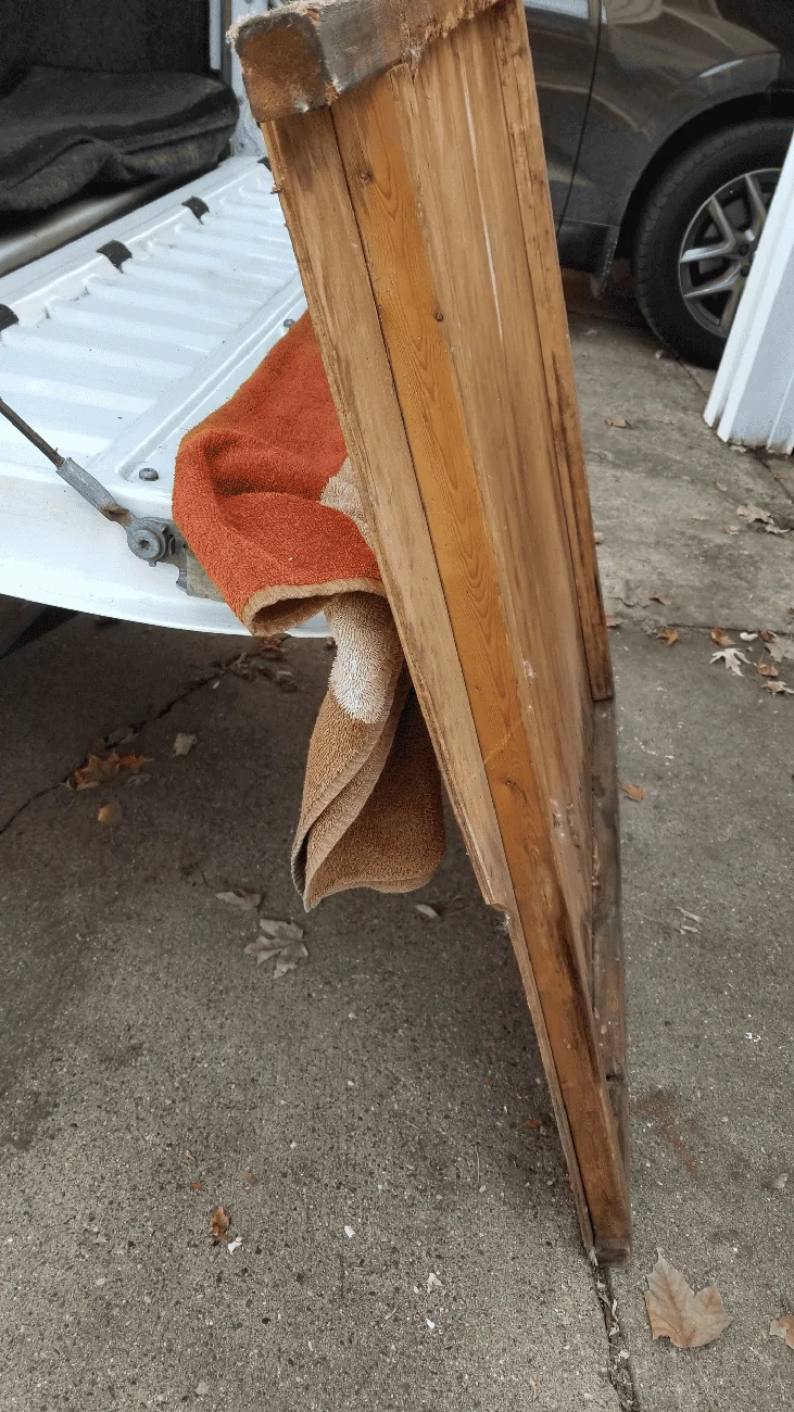

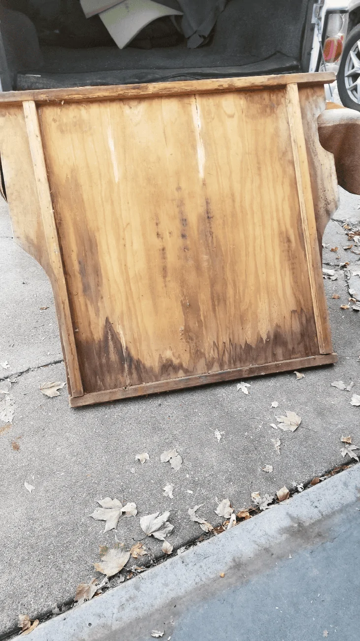

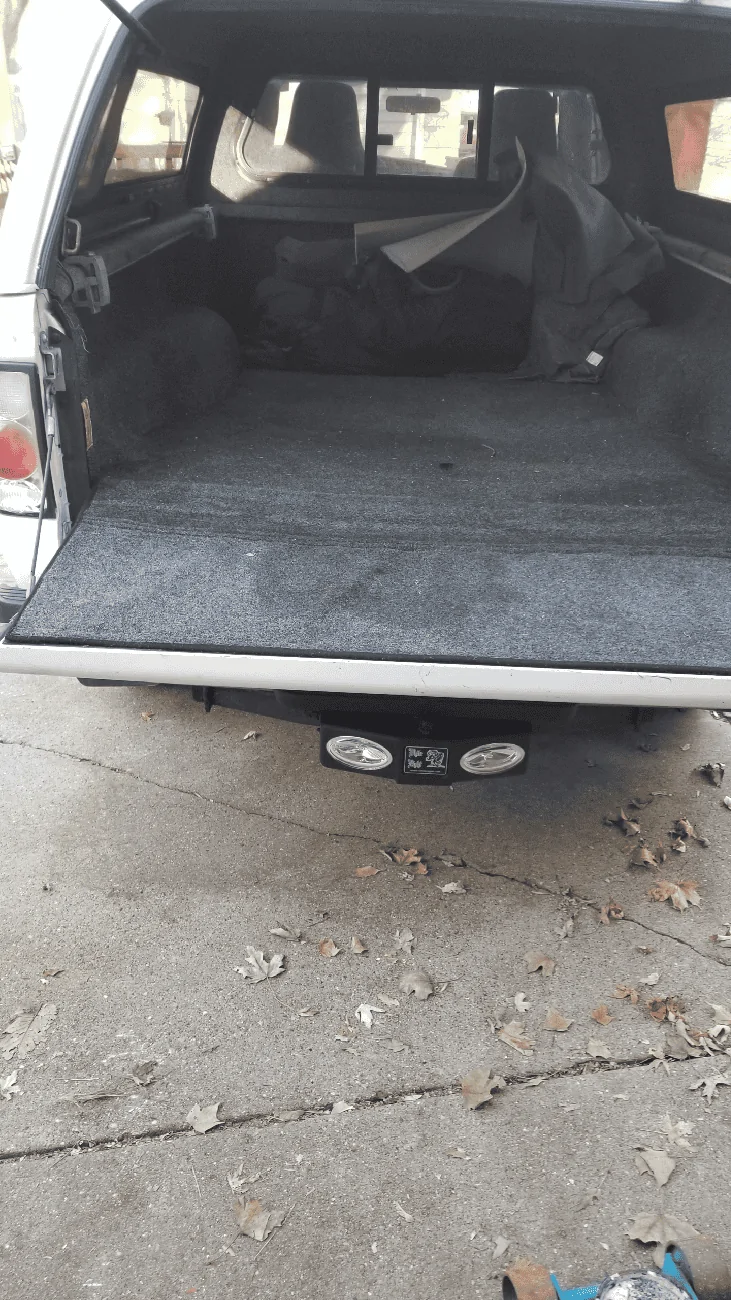

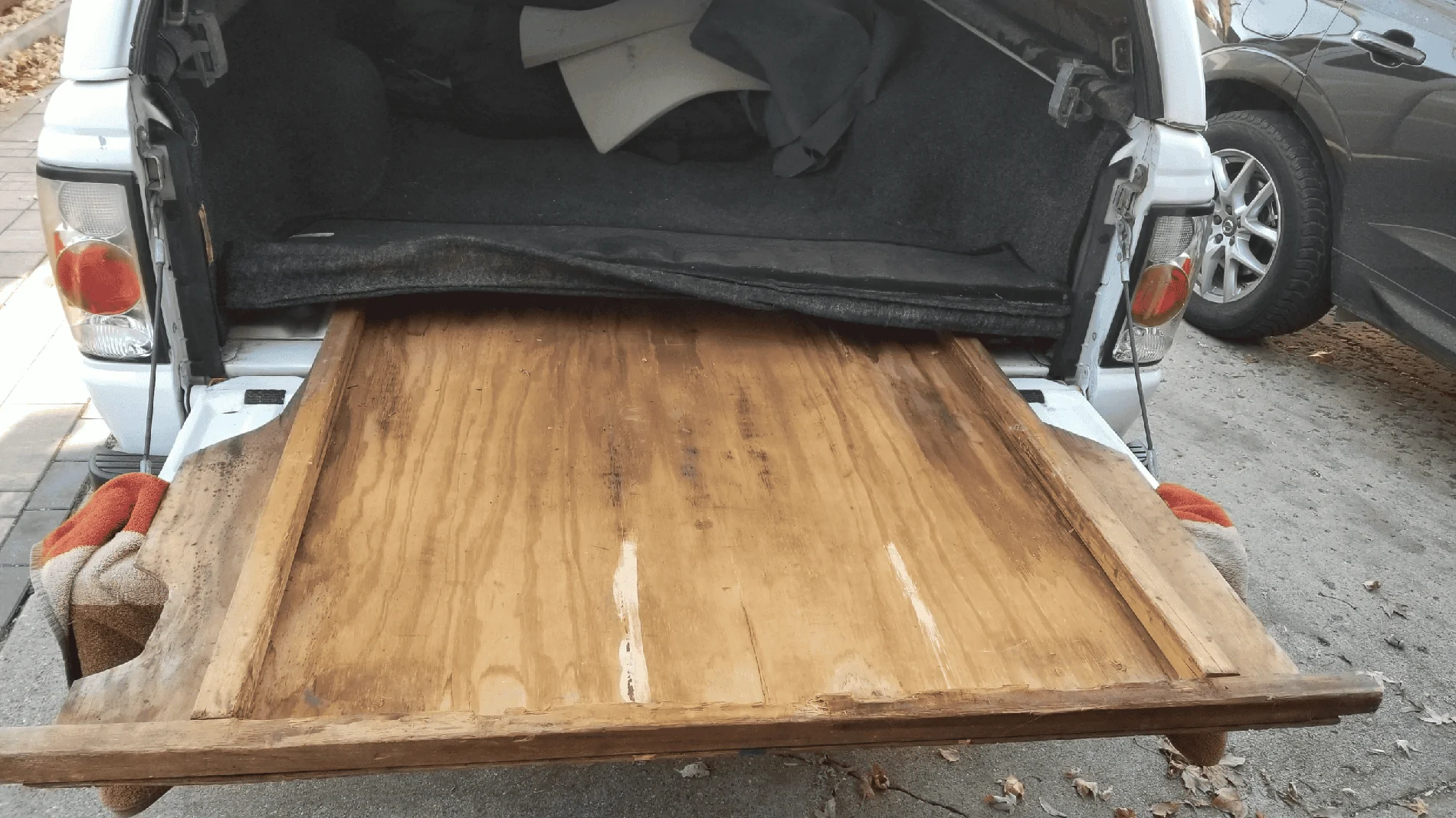

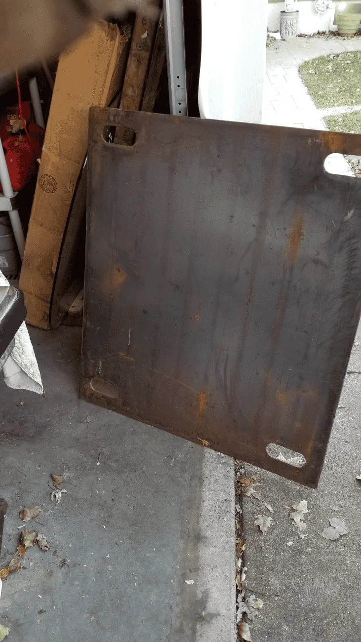

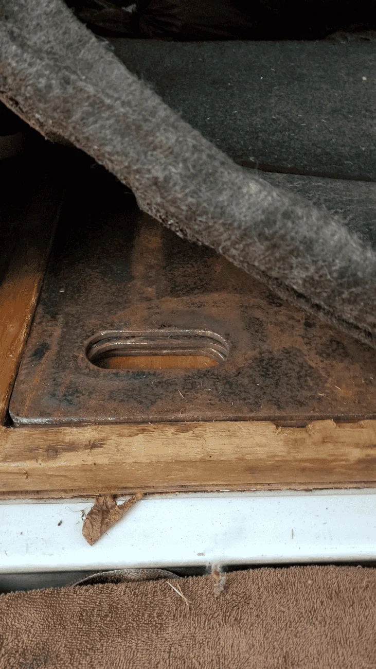

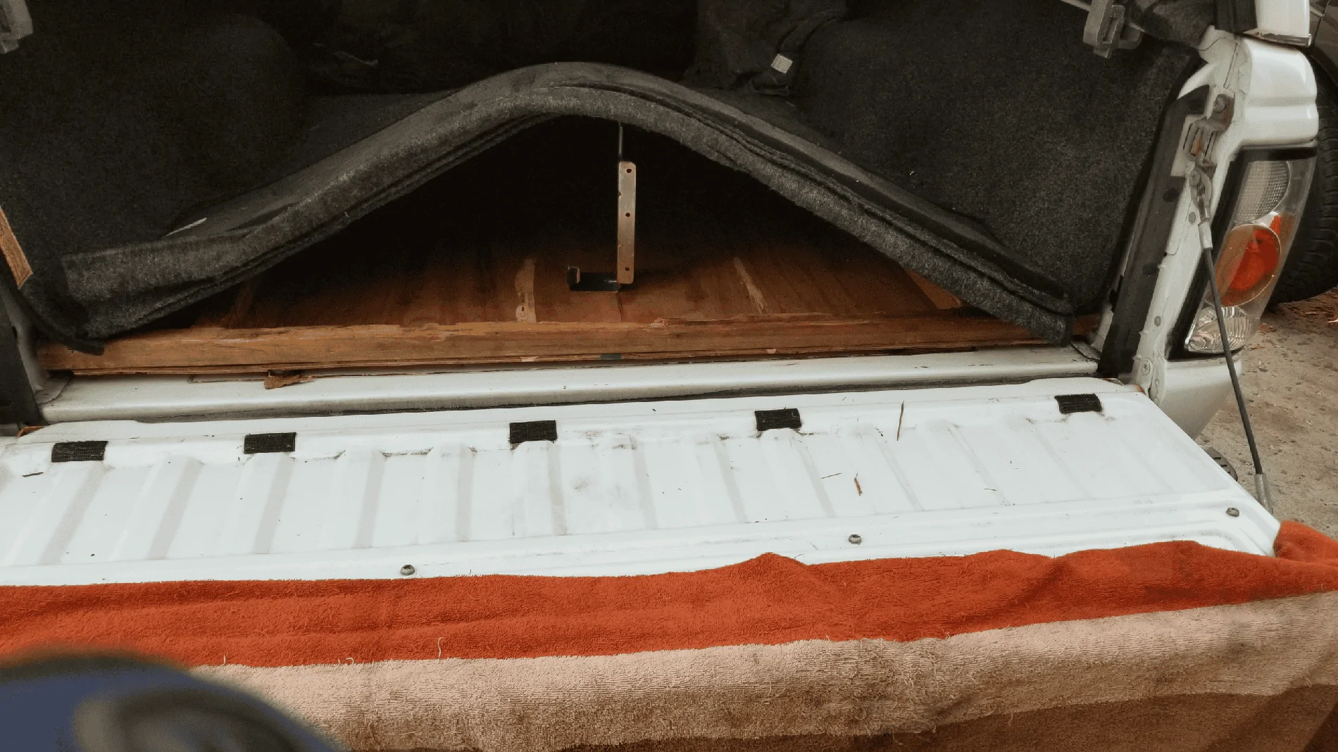

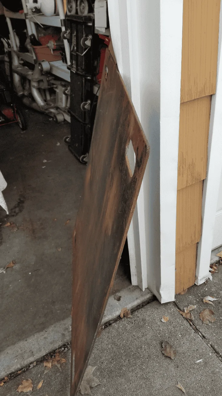

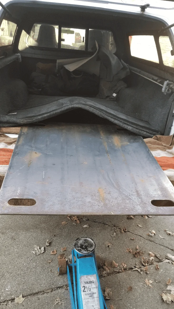

For my previous Ranger, 2005 which I had from new till 2019, I had bed weight made to order from 1/4" plate to use in the winter... total of 400 lbs. Ran a bolt through the box into the frame so it would no bounce around over rough roads and speed bumps. Doing the same for 2019 Ranger as well. Definitely smooths out the ride.
See pics.
Wood frame to hold the plates (1"x1" screwed to 1/4" plywood)
Plywood shaped to fit between wheel wells... full width otherwise... just slide it in.
Steel plates are 100 lbs each:
Covered by BedRug and still have a flat usable bed.
Used it for 15 of the 20 years I had the truck... well worth the effort.
