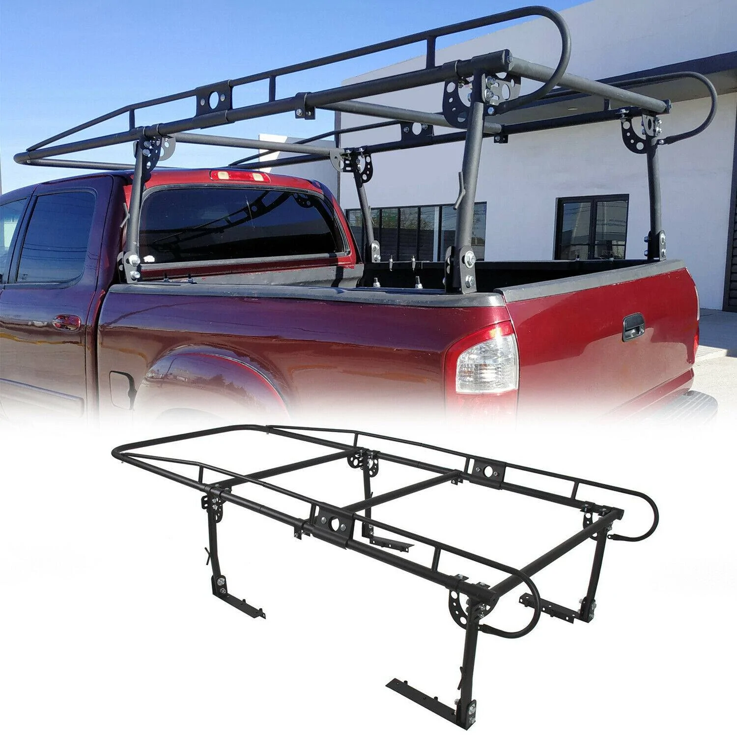

Looking for a basic rack for the 2021 screw.
Looking for something similar to pictured, any particular brands you guys recommend, anything to stay away from?

What are you planning to do with it? My overall thought is that I want a reputable brand for carrying cargo. To put it in perspective, pretty much any main brand roof rack company charges ~$200-300 for the crossbars alone. Now, I'm not stating that they're not inflated prices, but to get an entire ladder rack for $300 raises a red flag to me. Why is it SO MUCH cheaper than name brand competitors? Looking at eTrailer, here's an Erickson similar design: https://www.etrailer.com/Ladder-Racks/Ford/Ranger/2019/EM07707.html?VehicleID=201993275
Looking at the pictures, they look like complete clones of each other... so why is that one half the price? Call my OCD, but when I'm putting several hundred pounds of gear elevated on my truck, I want to have the peace of mind that it's all secured. I can ensure that the gear is well secured to the rack, and the rack is well secured to the truck, but I can't do anything about the build quality of the rack... Except buy from someone who has a reputation to protect.

So yes, in theory, a rack is simple. You have some uprights that connect to the bed rails. You have bars that run fore/aft. And you have crossbars tying it all together. Pretty simple. And as a self made rack, I can almost guarantee you overbuilt it because you built it for yourself. Except a company trying to mass produce these is going to want to optimize material thickness... I don't really need 3/16'' thick piping - I'm fine with 1/8''. Which perhaps they are, if they've done the R&D to confirm that. I bet you just went with nice and thick materials, and spent plenty of time prepping all of it, and laying it all out. If you had to estimate, how much do you think you spent on materials for your rack? How much time do you think you spent putting it all together? (I'm not talking about v2 and v3... just a single start to finish rack assembly).
Running through a quick home depot shopping list of what I think it'd take to start with...
Fore/Aft... 1in x10ft black steel pipe - $20 x 2
Crossbars... (cut above in half) - $20 x 2
Uprights... (cut above in quarter) - $20 x 1
So $100 gets you a skeleton. And probably another $50 at least in order to get it to the barebone basics installed on a truck. And I'm not a welder, so I apologize if my times are completely off. A quick google search shows that a 3'' pipe should take about 15min to weld, and since it's going to be the perimeter that matters, a 1'' has 1/3 of the perimeter, so I'm going to estimate 5min. Again, at minimum, you have 4 joints at the uprights to the rack, and 8 for the crossbars, so that's an hour of welding. Google shows that the average pay for a welder is ~$20/hr in wages, and the rule of thumb is that total employee cost is 150% more when you consider benefits and stuff. Except then you're going to need something to help stabilize it all, some nice triangle pieces should work well, and some feet for it to rest on the bed rails, so let's go ahead and double that. You're now at $210 for an ugly, but bare bones functional ladder rack.
Sure, the company is going to be paying less in labor and probably getting better rates, but has to pay to ship it as well. My rocker rails just shipped from CA to MI and cost $110 to do that. And that was just ground shipping across the country. I have to imagine that shipping a rack (even if it's not fully assembled) is going to be similar.
And if we look at the rack listed... it looks like each fore/aft bar is 11' with a through hole drilled. The front crossbar has been bent at either end to 90 degrees (we never even discussed bending metal tubes) and pinched to slide into the fore/aft bars. End user will assemble the fasteners to complete that. The second crossbar seems to have formed metal strips welded onto each end, allowing the end user to position and clamp it onto the fore/aft bars. The 3rd x-bar has the same, but then a triangle reinforcement plate welded onto the side. The 4th x-bar looks like it just has an oversized pipe welded onto the side, and looks like the back of it has a hand knob with probably a setscrew to hold it in place. Oof, that doesn't look too secure to me - those hand knobs have a habit of loosening - make sure that you frequently check to make sure that the bar isn't loose. The uprights appear to have a slight bend in them, tie downs welded to the sides, two through holes drilled, and the rear has an oversized pipe, while the front has the same as the 2nd/3rd x-bar. Front one also has 2 more through holes drilled, while the rear has a drilled tab welded on. I see the guard rail secures at the front through hole and at the back tabs, and it looks like some sort of bolted plate halfway through, but I don't know how those vertical supports are attached - they look welded, but there's no way that's the case since the guard rail is bolted on at the front/rear. The plates see to be an L extrusion with 3 (?) holes drilled, and a tower welded on, with 4 through holes. I don't know if the underside has any blocks or is just a u bolt pressing into your side rail. So, the reason I went through this, is to just demonstrate that even this rack has a TON more than my stupid simple calculation above, so that cost of $210 really isn't a complete rack since you're going to have so much more to deal with that I didn't bother detailing out.
