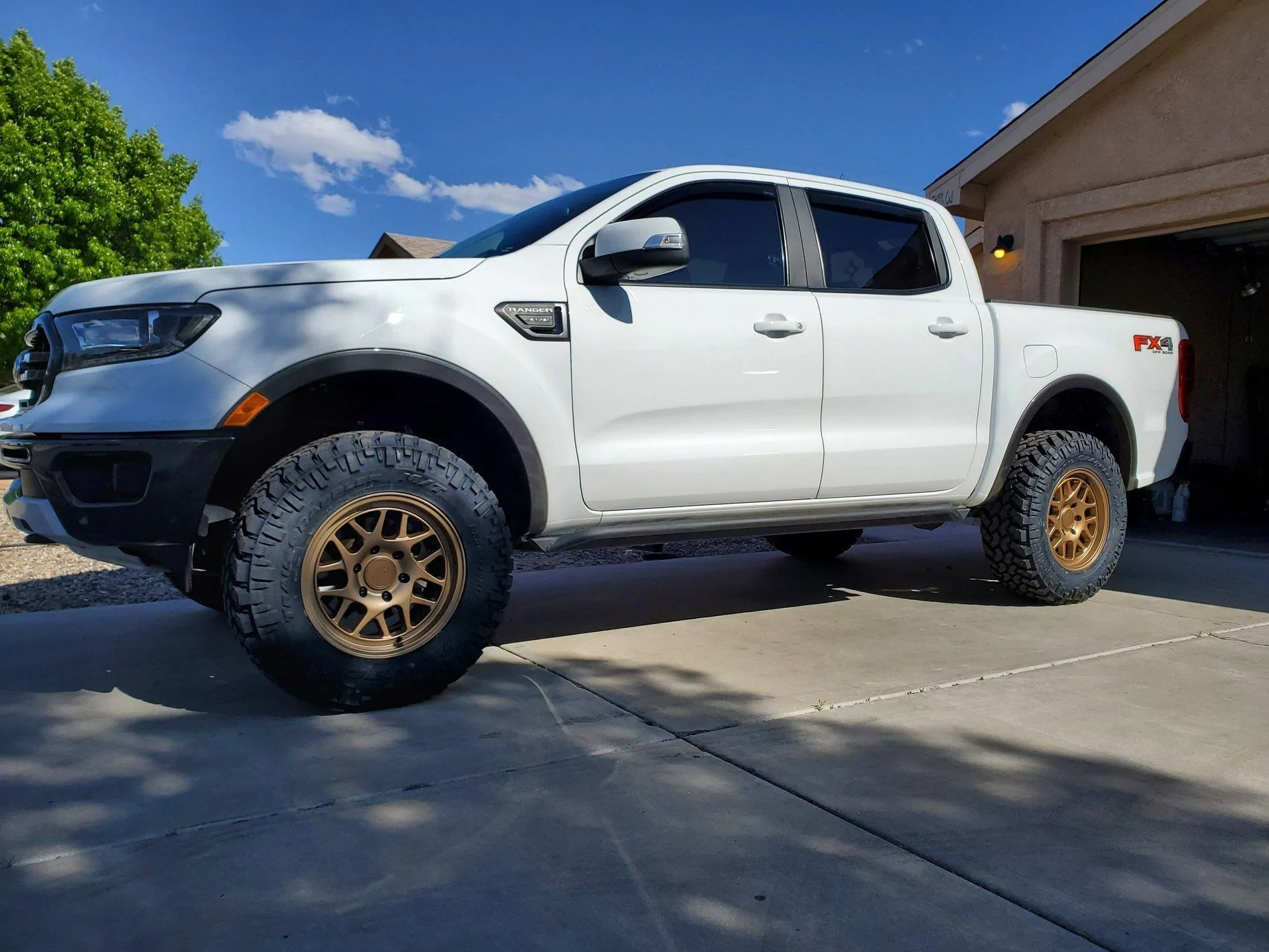

The bolt pattern on the wheels is in fact 6-139.7. I have 17" Black Rhino Chase wheels that are 9" wide on my truck. The wheels have a +12mm offset so they sit just outside the fender well as you can see by the image of my Ranger XLT below. Hope this helps.

Most wheel companies go by offset now instead of backspace. My wheels with a +12mm offset have a backspace of 5.5". Here is a link to a some great information about offset and backspace.
https://www.discounttire.com/learn/offset-backspace
Here is a link to the Black Rhino Chase webpage. The Chase comes in two colors matte black and brushed gunmetal.
https://www.blackrhinowheels.com/off-road-wheels-rims-chase.php
Below is a photo of the Black Rhino Chase wheel on my Ranger.

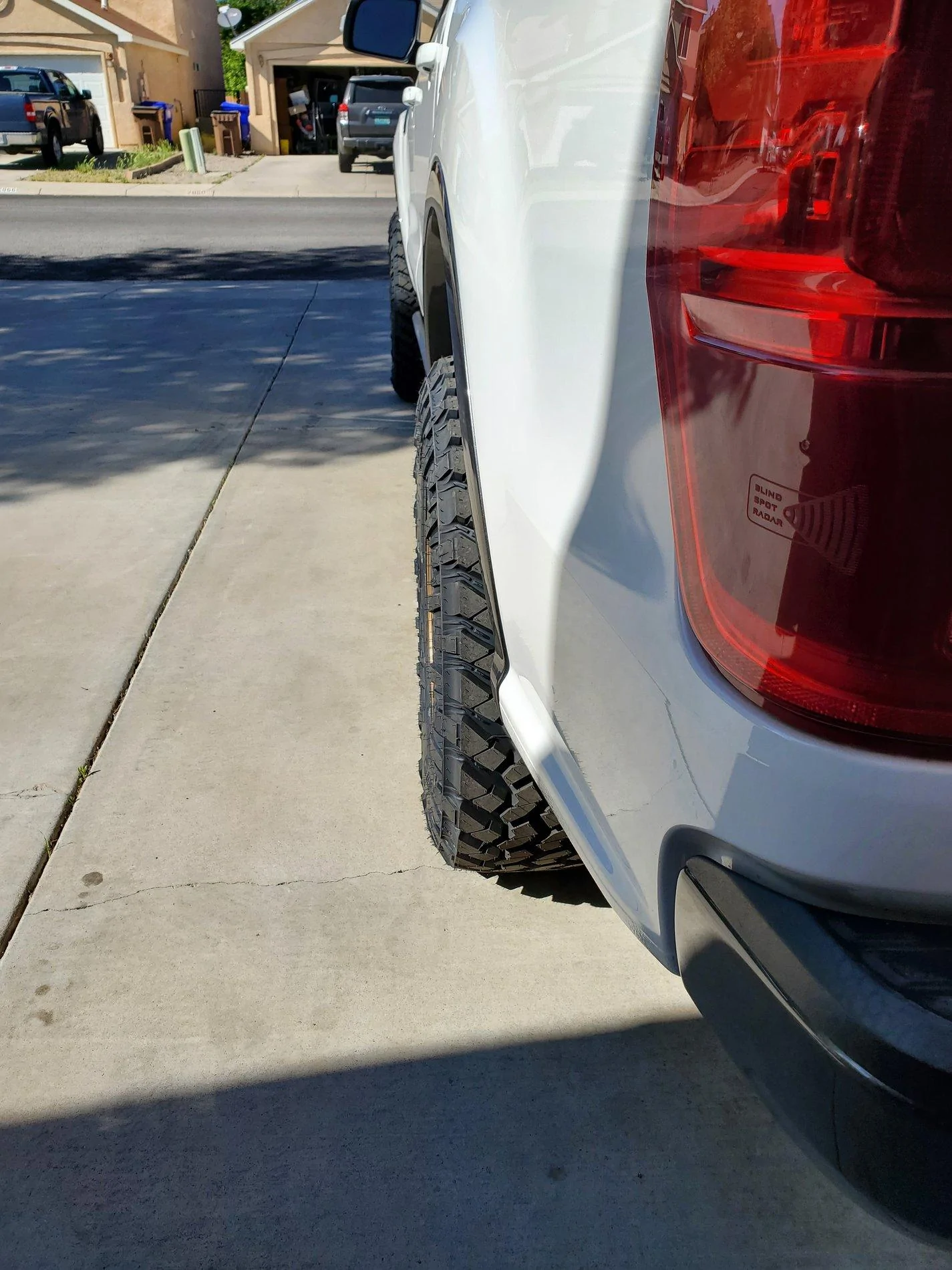

The 17x8.5 0 offset is going to sit 2-1/2" further out towards the fender when compared to where the factory wheel sits now. According to our measurements, this places the front lip of the wheel about 1-1/4" outside of the fender.
The 17x8.5 +18 offset is going to sit 1-3/4" further out towards the fender when compared to where the factory wheel. sits now. According to our measurements, this places the front lip of the wheel about 1/2" outside of the fender.
