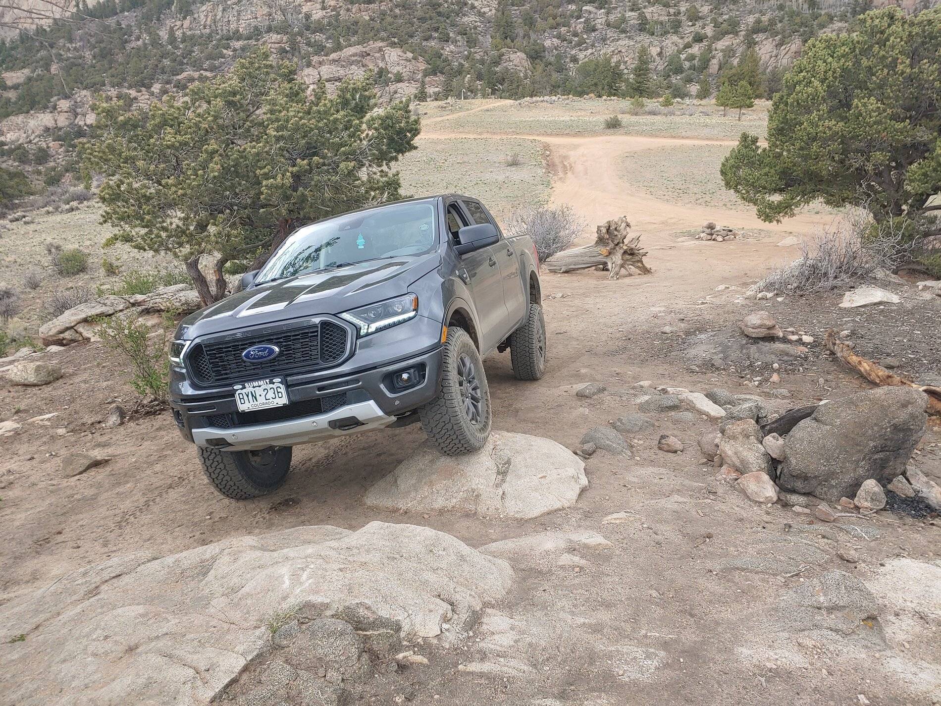

Taking recommendations on 3-3.75” lifts. I’m not interested in the most cushy long travel ride but I’d like something smoother on road and firmer off road than stock. I tow a 4,000 boat as well so that’s also a factor. Thanks in advance!
Also, here is a couple pics of the ole steed

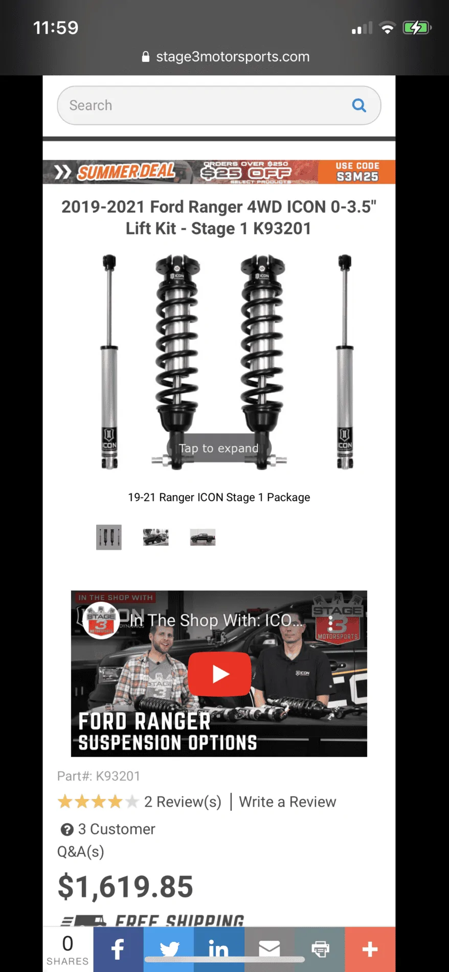

Here are the 3 I was looking at but I’ll take any recommendations.

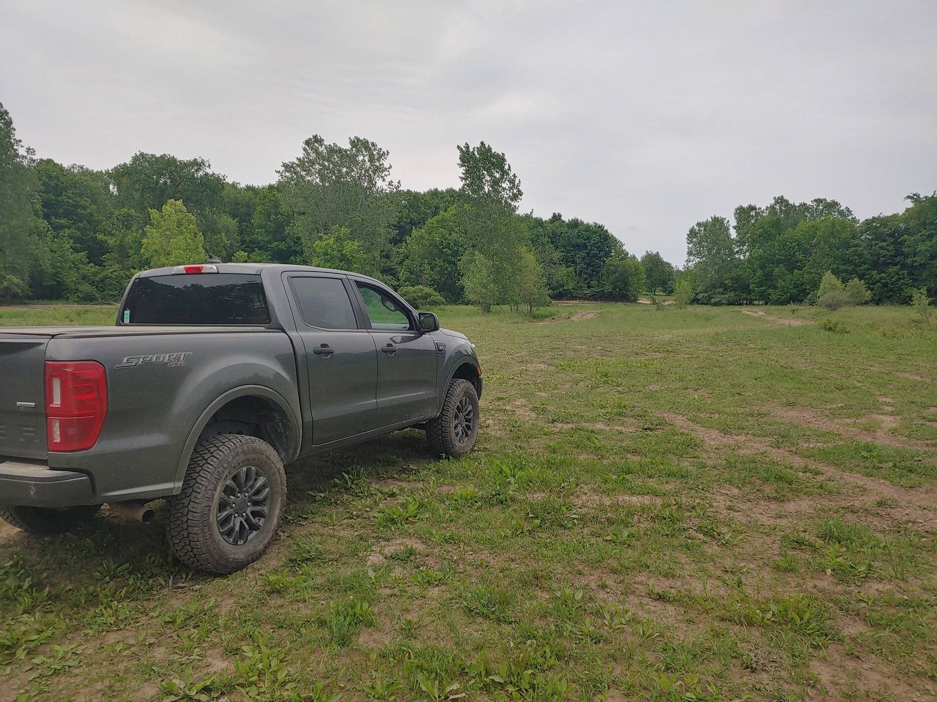

So if you want a PRACTICAL lift then I suggest the Old Man EMU lift!! I have the standard kit that has the basic shocks. I also have 285/70-17 Firestone Destination XT's on it with no problems.
How much lift do you get? 2.4 front and 1.6 rear. As for tires it depends on wich ones you go with for extra lift all around.
How does the kit do on road? Well lets just say that it is way more comfortable to say the least and way more confident in the twists!!
What about the OffRoad? Freaking AWESOME!!! I have great control and due to how Old Man EMU does the lift you get nive travel on all 4 wheels!! Should I add that i don't have any added skid plates yet?
Now you wonder about towing? Well it does just fine. I towed my old 280ZX a while back and I didnt have an issue. The car and trailer was right about 5,500 lbs and I'm sure the toung weight was enough as the truck was level.
What about control arms? Surely enough you must replace those right? Nope not at all!! I still have my factory control arms and the truck does just fine!!

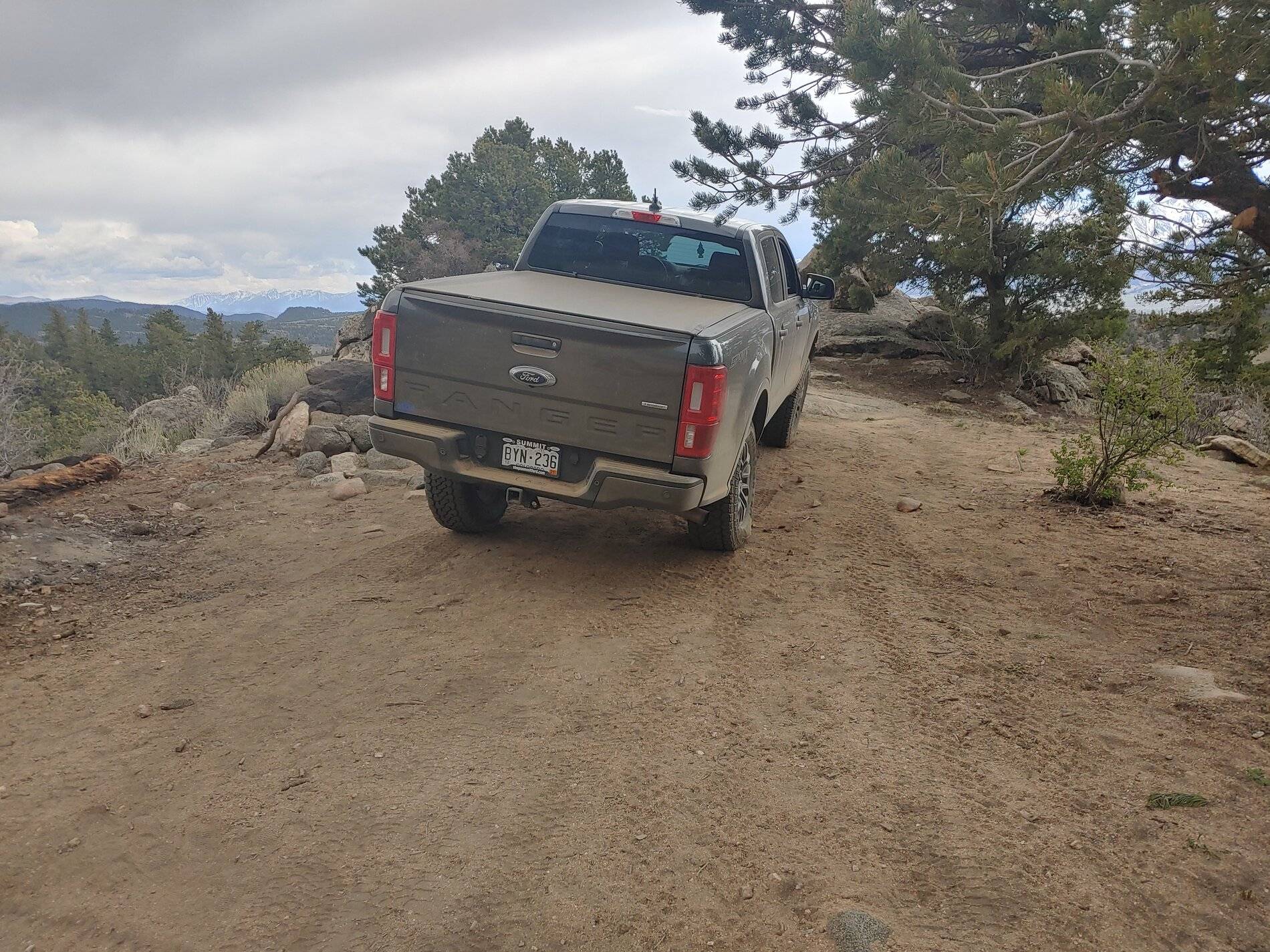

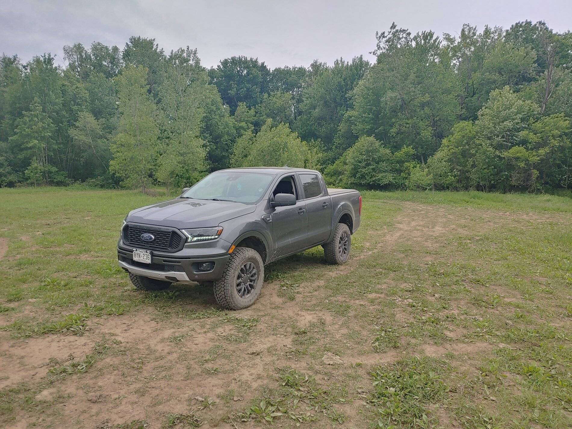

Here are pictures of the truck now and from when I had 32 inch tires on it!!!
Hope this helps!!

So would you recommend the basic OME kit with leafs and shocks over the Eibach kit?
Frenchy
Mar 15, 2020
98
6,126
8,267
Elizabeth, Colorado
Crown Forklift Technician
Yes I do. I recommend it over any leveling kit just because you're going off-road especially if you are camping if you're going to have stuff in the bed. You have a leveling kit your truck is level without a load and we'll do the stupid Virginia SWAT can you put stuff in the bed ome you can load the truck and possibly get level depending on how much we can put in it and still be able to go off road with no major problems
