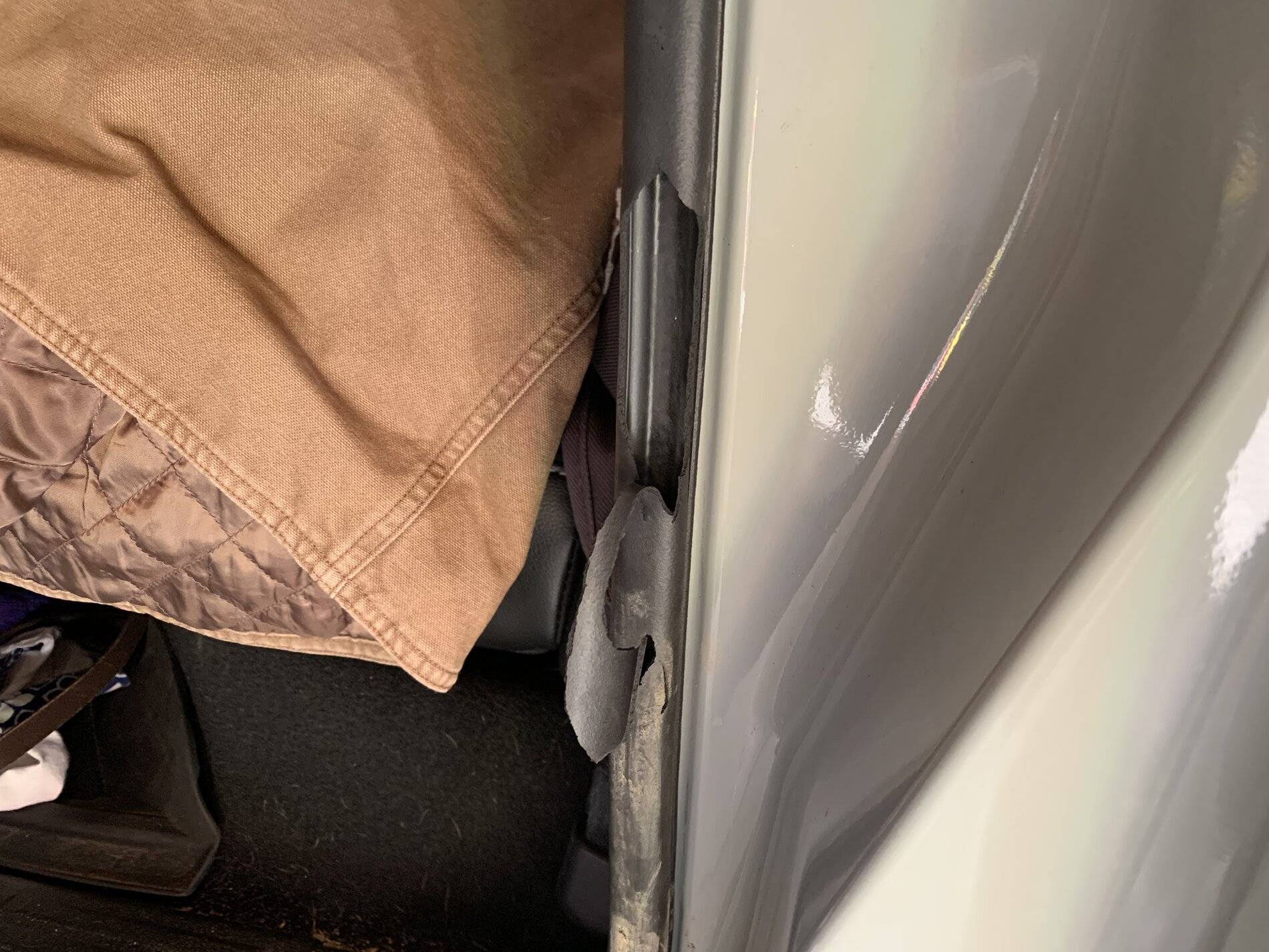

Hey,
So I was running some errands this morning and was getting in the truck at the bank and noticed this rather noticeable hole in the weatherstripping on the bottom of the driver door.
Would this be covered under warranty?
Have had my truck for just over a year now, only have 9,300 miles.
My experience with these is after the first hole/tear it falls apart rather quickly. I have been hearing new wind noise lately.. don’t know if this the cause.
Also; Don’t know if anyone can see it, there is a small indent in the stripping at the bottom of the pic. On the truck there’s an identical one a couple inches farther back. Does anyone else have these? They’ve been there a while and I don’t know what’s caused them.
Thanks in advance everyone.

Hi Brandon,
Not normal....Dealer should fix under warranty....

I noticed 2 tears on the drivers side weather strip of my truck yesterday when cleaning it.
one below the rear door (super cab) & the other opening/tear is about 4" up from the bottom rear corner. I have to wonder what caused this....
will be going to the dealer in 2 weeks for the 10,000 mile service & will show them the issue.

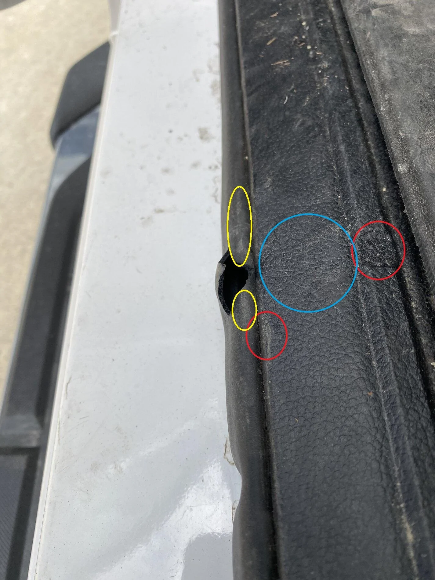

Honestly it looks like something impacted the trim next to the tear and dragged across the weatherstripping and snagged it causing the damage. There's a divot and scuff marks all around the tear and on the plastic. My guess is something was in the wat when the door was closed causing this. Check the corresponding location on the door to see if there's any marks there as well.
One thing that stands out that something may have been there when the door was closed is the large dent (large red circle). My truck does not have this deformation divot in that location.
I marked the areas in the picture that stood out to me.
Red circles - Possible impact points.
Yellow circles - Scuff marks.
Blue circle - Plastic discoloration possible impression mark.

took my Ranger in for the 10000 mile service & had the dealer look at the door seal. they ordered a new seal but for the life of me I cannot understand why the seal tore open. it does flex easily & feels very soft.
