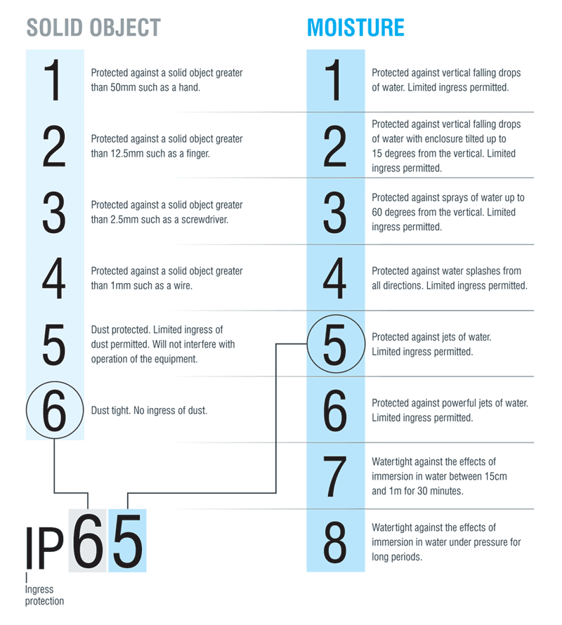

I want to add some USB connections to my either my rack or storage pods, along with a 12V port. Ive come across plenty of options with the rubber caps, just curious if anyone has a recommendation.
In this case NEMA codes mean a lot. Then what’s your intended criteria use for long term reliability. So another case of you get what you pay for. Good sources would be online at Mouser or DigiKey
