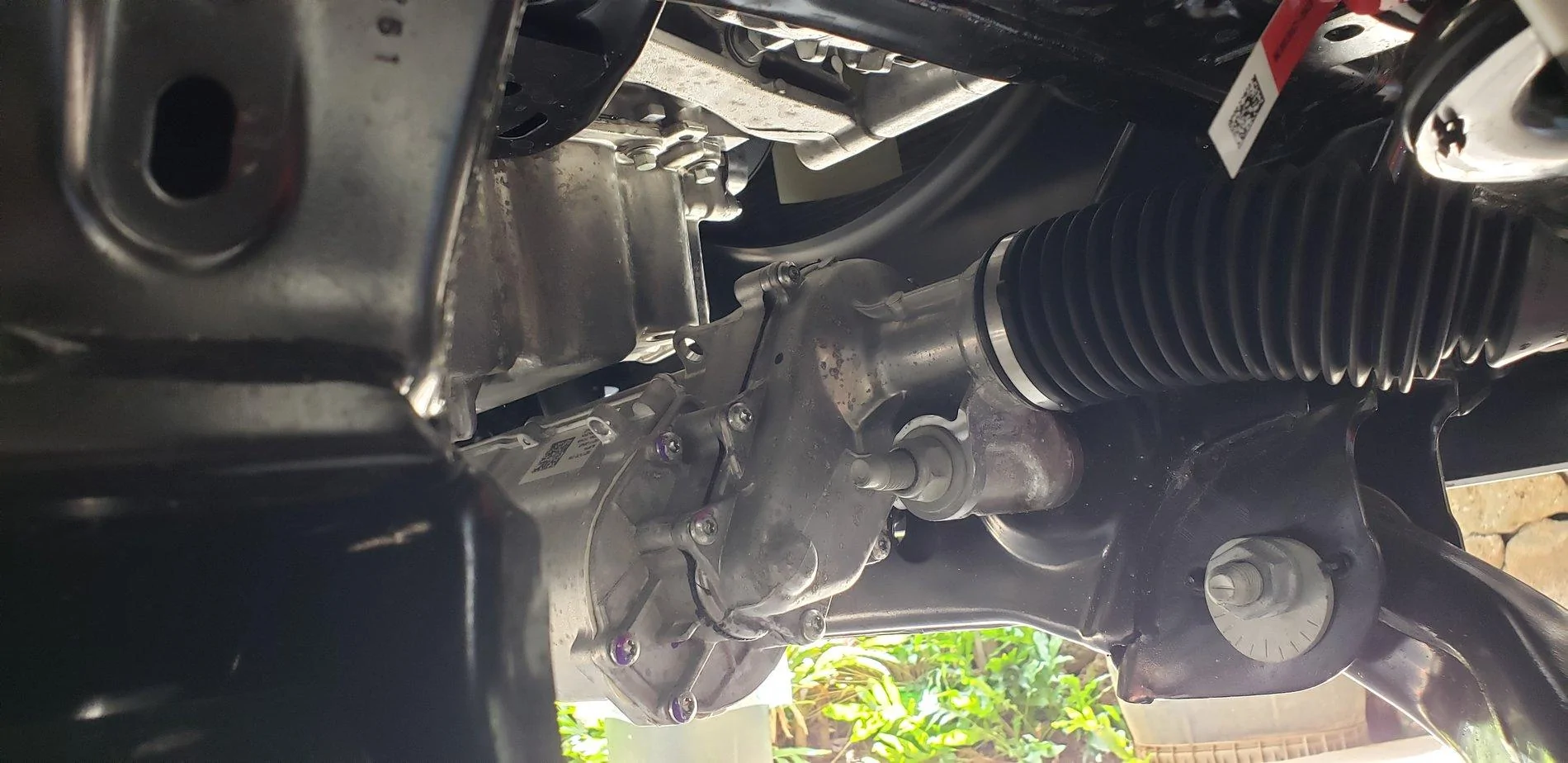

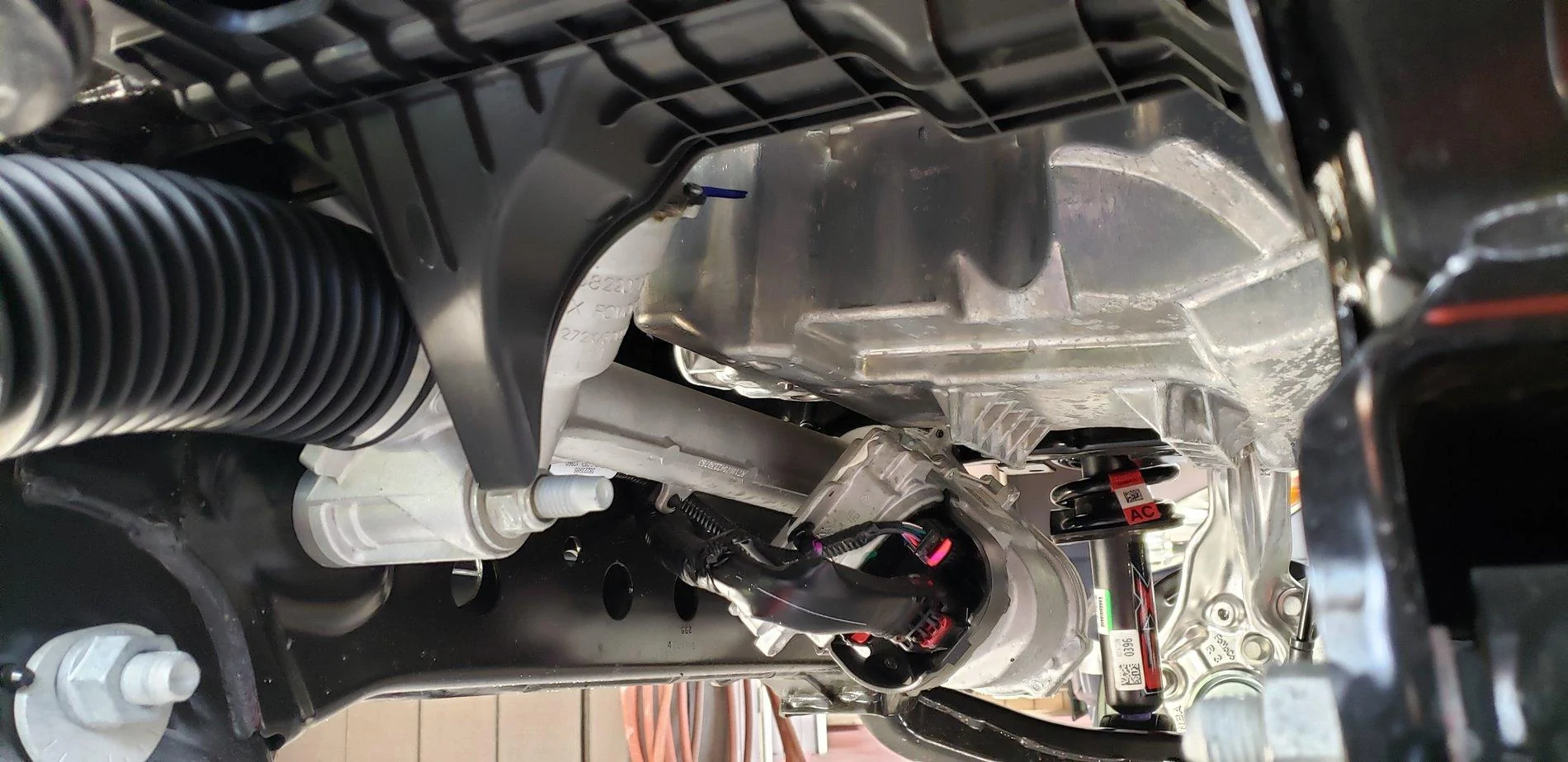

I own 2020 Lariat S/Cab with the FX-2 package (4x2) and noticed just how vulnerable the electronic power steering motor (EPAS) is just aft the number 2 crossmember.
The motor itself does appear to be adequately protected from forward impacts as it does not extend below the crossmember itself, but any ground obstacle beyond that point will damage it severely.
Does anyone know of a manufacturer who might produce a skid plate for this area only?
Not looking for an entire front skid/bash plate, just one which mounts to numbers 2 & 3 crossmembers, there appears to be four 8mm. tapped holes already, 2 in each crossmember.
Not planning to do any serious off roading, just looking for insurance for now.

I saw that recently as well when I was under my truck and thought the same thing. Wow these wires are very exposed. Interested in finding something as well.

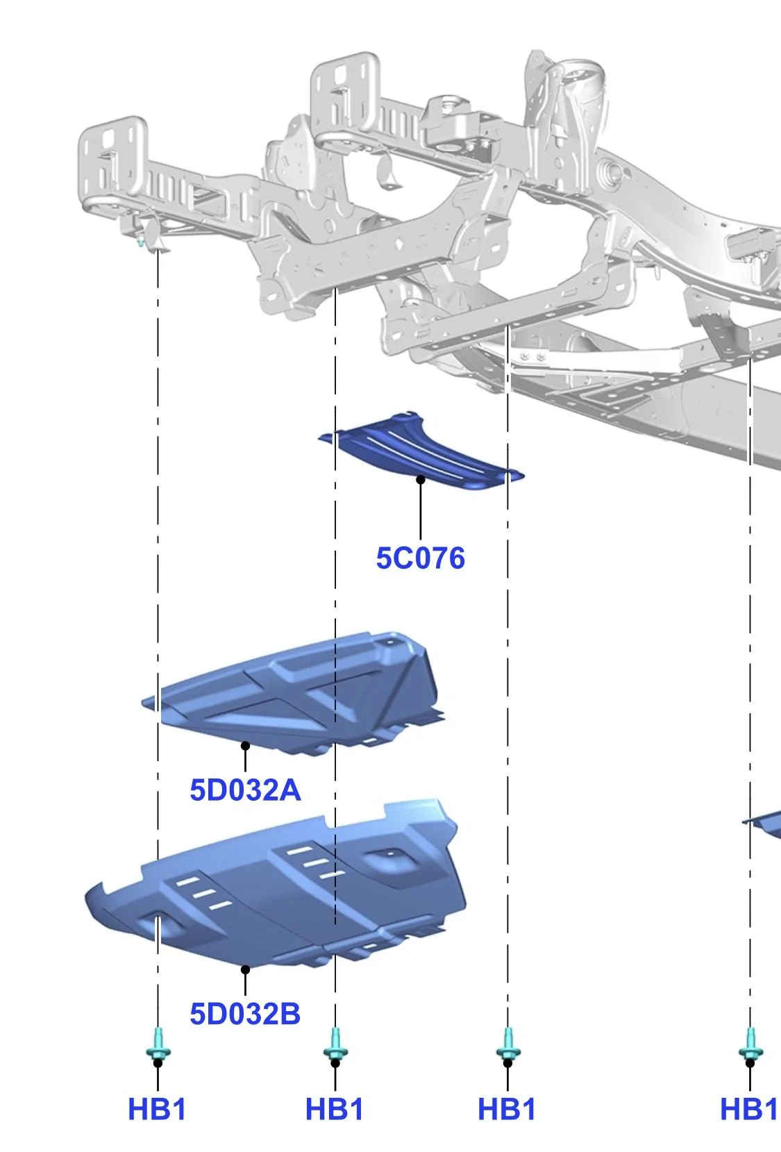

Indeed, I've already private messaged Benny @ Levittown Ford parts.com an inquired about item # 5C076 shown on the attached image. I can forward you his response if you like.
Ford calls this plate the EPAS protector so I am certain it should do the trick. There are already four 8mm. tapped holes in crossmembers 1&2, 2 in each member.

Wow, learn something new everyday here. Appears 4X4 only gets the plate. Ford surprises me with these little cheap outs. Definitely get one of those on there. That's one expensive part exposed.

Mine is 4x4 and came with all the skids. Just surprised yours didn't. Looks like you'll have to order the 5C076 from your local dealer.
