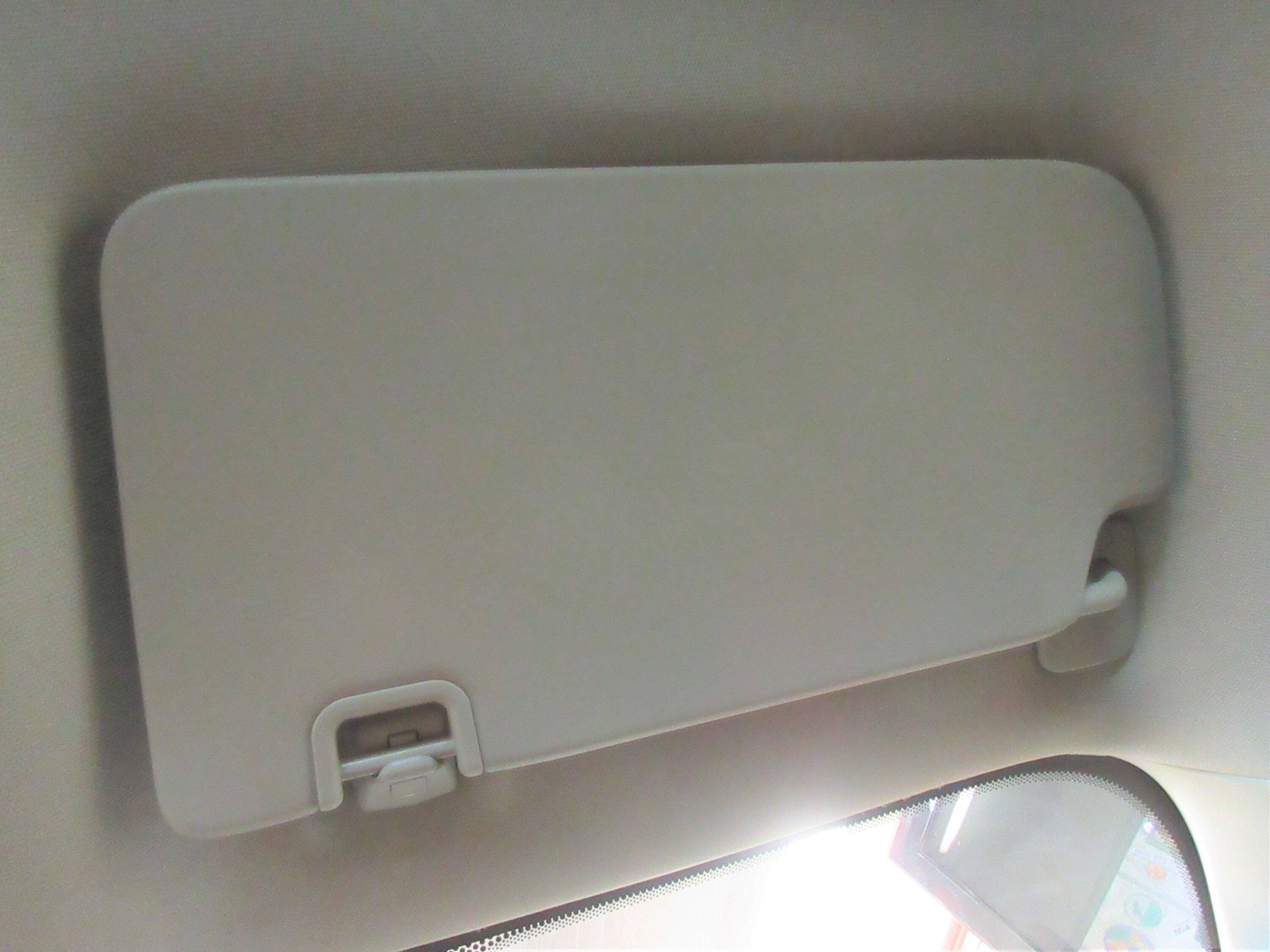

Has anyone tried to remove their visor warning labels yet? I did once on an older car with mixed success. On my BMW I ordered euro visors and swapped them out. I wanted to see if anyone tried anything yet. Thanks
Determined to get the stickers off, experimented with Goo Gone, Acetone, Lacquer Thinner, Brush Cleaner,
Isopropyl Alcohol none totally removed the glue residue left behind after using a heat gun on low to pull the stickers off. Laid the visor flat and put a cloth soaked with Isopropyl Alcohol on the glue residue for 5 min and it turns the glue a milky white, then wiped it clean with Lacquer thinner. It’s like the Alcohol reactivates the glue and Lacquer thinner finishes the job. All I can say is it worked for me and not a trace of any stickers. It made me happy! Your results might be different on older Visors where the glue has hardened.
