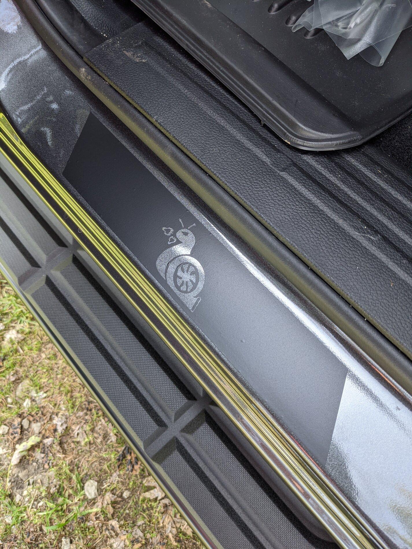

Vinyl is fun. What kind of a plotter do you use? I just have a cricut, it's fine for what it is but I wish I could do longer cuts than 24". I just made these door sill decals last week

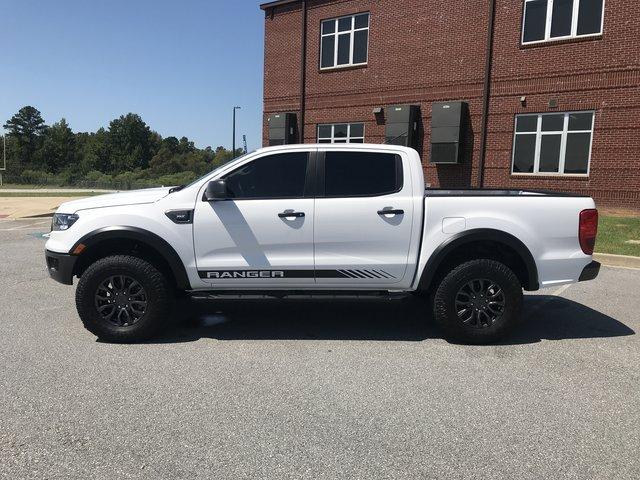

The "RANGER" part on my sides is actually the front half of the Ford graphics. I just modified the rear half...
Original:

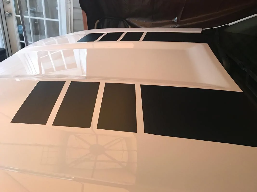

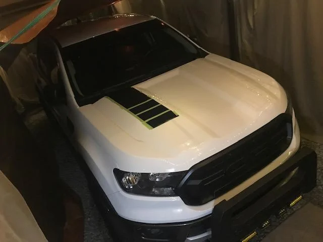

Well its somewhat easy as long as everything at its core is a straight line. I tried tinkering with doing curves and while its not completely out of wack, it can't match a machine cutting it.
The spacing is easy because I just use a line of 3M 1" wide automotive tape as the spacer. lol
I more or less mock up the template, then cut them all out as individual pieces. I then apply the largest piece first, then put down the tape and spacer the smaller bits as needed.
Like I said, straight lines or angles, cause all an angle is is a crooked straight line. I did about a 10-15 degree rake for the hood. The sides are 45 degree rakes. You can spot one of the small imperfections below where the bottom line of the big piece is not straight. Somehow when cutting it I angled to much and the corner now rakes inwards.
Like I said all of this will just end up being a template for a professional company to go back and do it for real.
