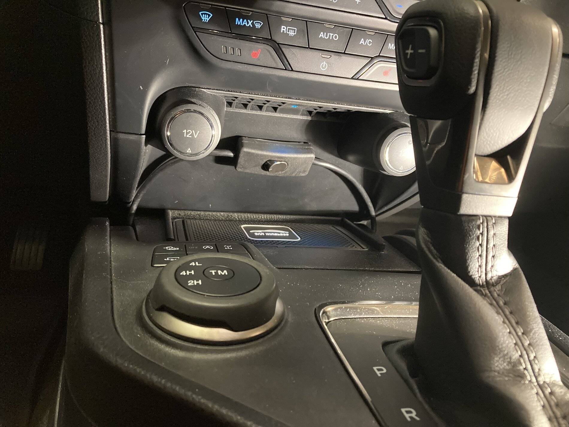

I have the same issue but since I'm using the carplay2air adapter along with @DirkM 's wireless charging solution...I can't just unplug the usb cable and go. Only time I've lost cell service was when I went up to Ole Miss for move in day but it was for only a 20 mile radius around Oxford probably caused by the sudden influx of panicky parents.
I have the same setup, here is my solution. I installed a USB switch and dbl sticky taped it up to the dash above the phone. I can now decide if I want the carplay adapter to be in control or just the car sync without having to try and unplug the carlink adapter

I will plug the iPhone USB cable into the USB ports on the back of the console (LETTER E), no CarPlay!
If you want CarPlay, plug into the ports under the console (LETTER A).
