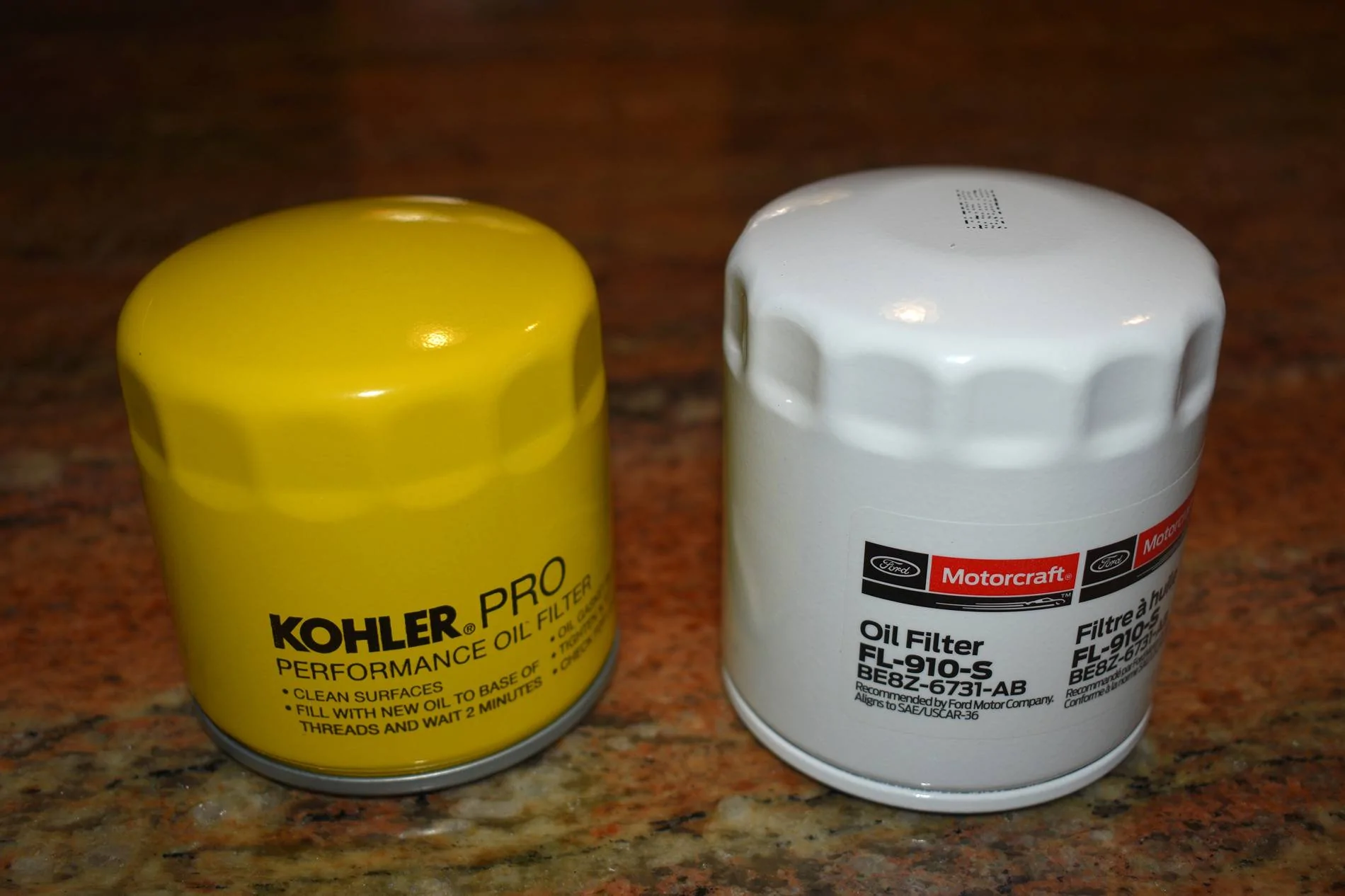

Just by going figuring the volume to ounces of the filter with out taking into consideration the filter media space.
Fl 400 is 16 oz while the FL 910s is 14.6. All based on outside dia. About 1.4 oz difference. I don't know if the filter media is
the same size or any other internal components. Need to cut open one of each new to see.

Thinking more about it , what I am going to do is measure how much oil to fill a FL 400 and do the same for the FL 910S. I use the FL 910S on my lawn equipment. I just have to get a FL 400.

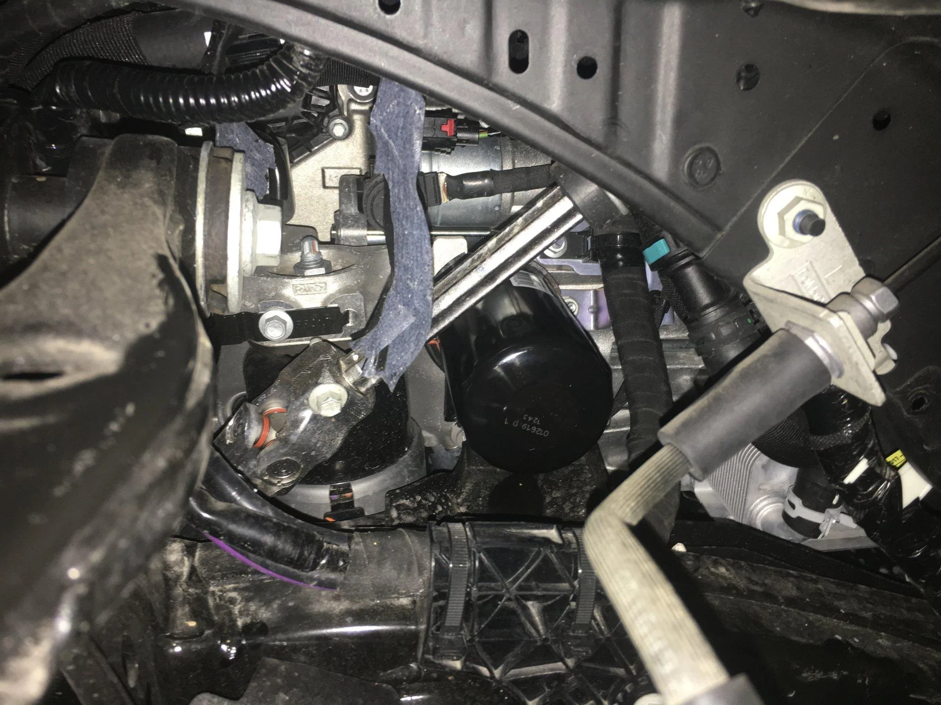

FL400s fits, it was a PITA to get the original off, I think they had a gorilla tighten them off the line.
I initially filled with 6.5Q, then added about another .25Q after running the engine for about 2 minutes and letting it sit for 15 minutes. The oil line was about 1/4" below the full mark until the extra .25 went in.
So about 6.75q brings you close to the full mark. I think 7 would go in, but it's too new to try that kind of stuff yet.
4800 miles on the ODO.

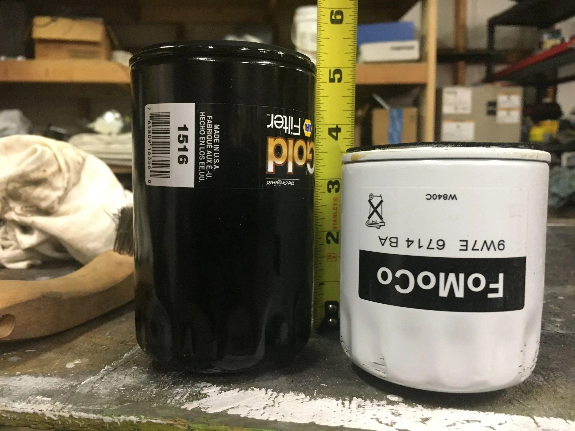

Just did my first change, so Iā€™ll share some thoughts, no particular order.
  • Wix 1516 (itā€™s the cross for the FL-400s) fits quite comfortably. There are zero issues with fitment, it doesnā€™t rub the shield or anything.
  • I pulled the wheel off since it was my first time. I would agree with what most are saying: itā€™s not required but it does make it nicer to work. Do it with your tire rotations.
  • 6.5 qts got me to the full mark.
  • The filter drain trough wasnā€™t where I thought it was! Thereā€™s another trough forward, roughly on the wheel centerline. The one we want for the filter is behind the sway bar. I got an arm full of oil.
  • 15mm wrench for skid plate and drain bolt.
  • My factory filter wasnā€™t overly tight. I didnā€™t have the right filter wrench on hand so a pair of channel locks got it off no problem.
  • If youā€™re the I-donā€™t-need-no-stinkin-funnel type, stand down and buy a funnel. The oil fill hole is quite a bit smaller than other Fords lately.
