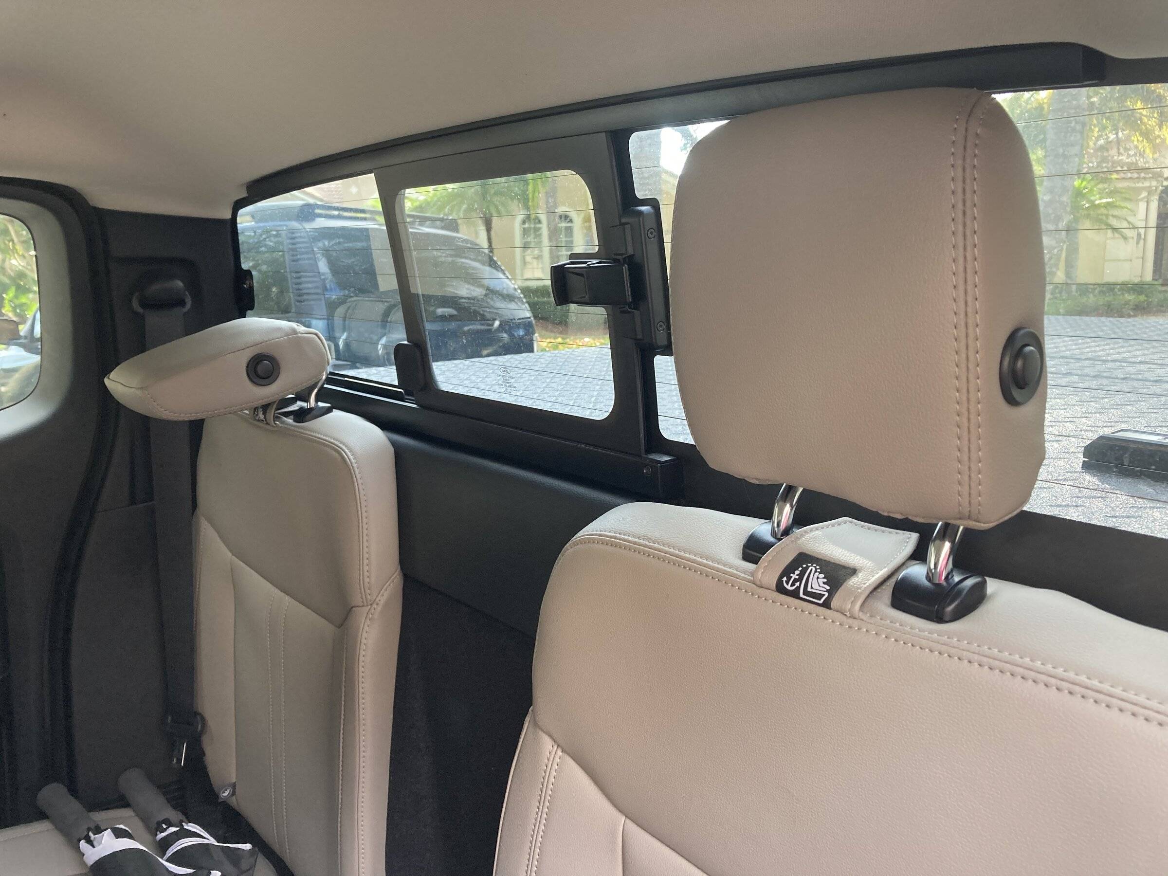

just had both supercab recalls done. mechanic said he has not seen a failed seatbelt, but bonus is I now have the 2019 headrests in back that fold. They kept my original non folding ones.
If that's the typical result, I suspect many more will soon be needing the recall ?
