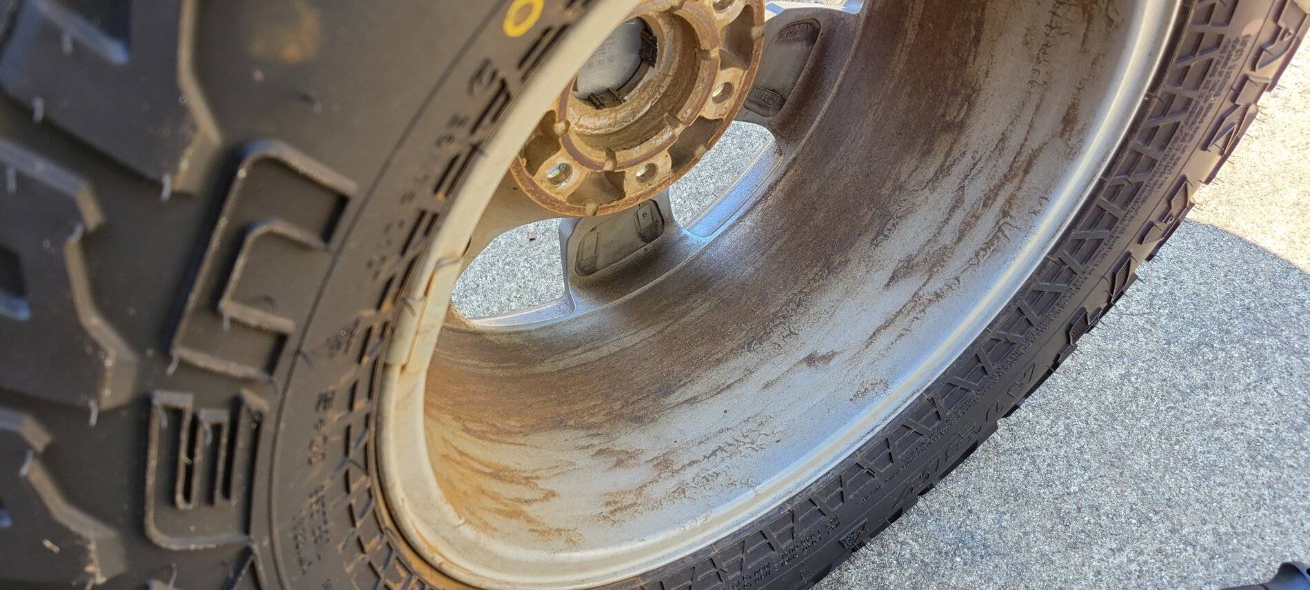

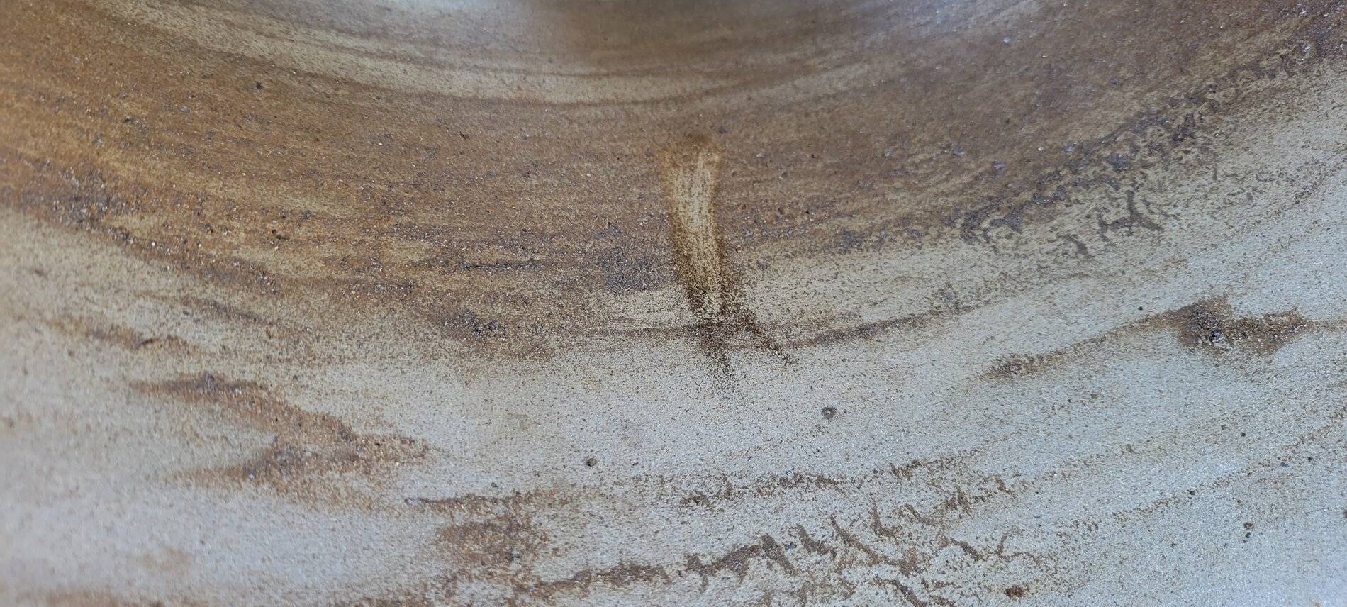

At least it's not axle grease! I blasted out the rear driver side caliper with the pressure washer and it sounds a little better. I need to do the passenger side later. I ended up starting with the driver rear because I crawled under the truck and saw what you see in the photo above.
