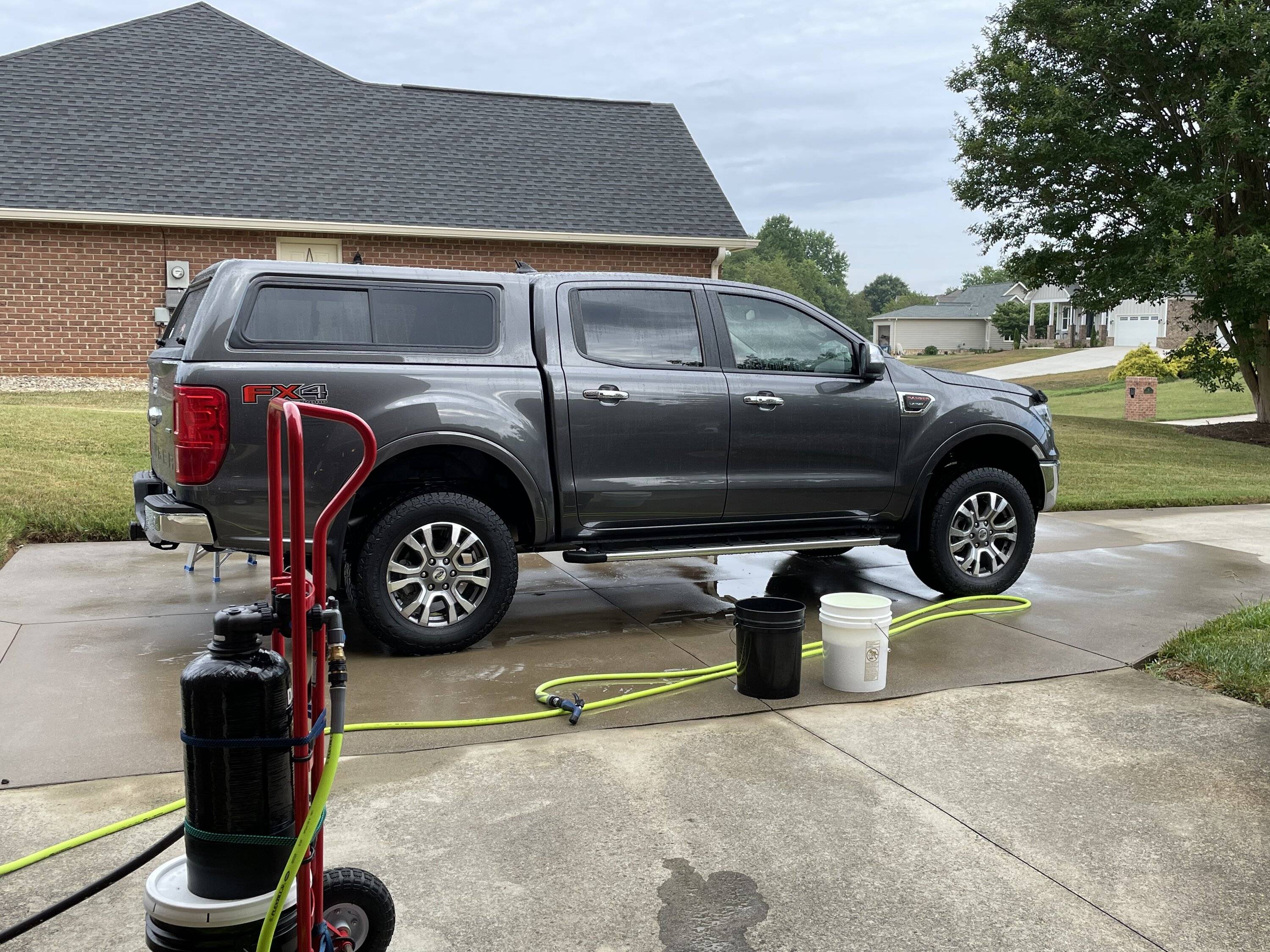

Two buckets, grit guard and DI wash/rinse for me. I have a foam cannon but start with a Chemical Guys foam gun if I don't use it.
Exact same set up, but i also use a dedicated wheel bucket and brush/cloth. Each vehicle has two wash mitts for that vehicle (below and above the beltline). Explaining why I needed a HF Hand truck for my wash kit to the wife was interesting...LOL
I have a McKillans cannon off Amazon that is amazing. Only use it for very dirty days though, not really needed usually. Nice to get the mud and heavy bits off and I use it for customers.
A lot of my friends think i'm crazy for the effort I put into cleaning our cars (I am also a side hustle detailer) but there is no comparison when I park next to them. My '19 and my wife's '14 vehicles have zero swirls.
