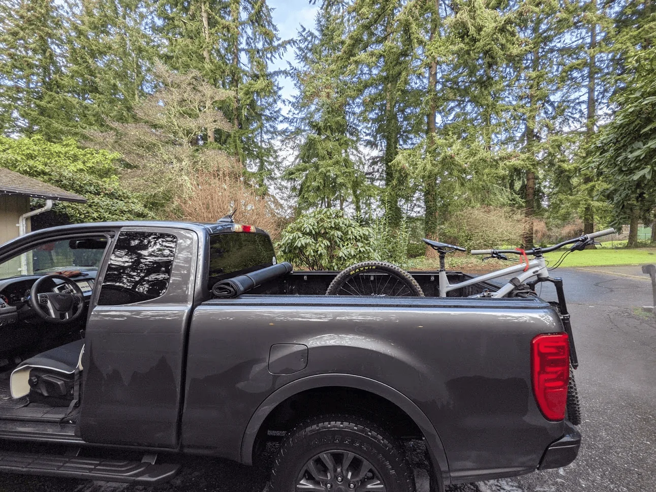

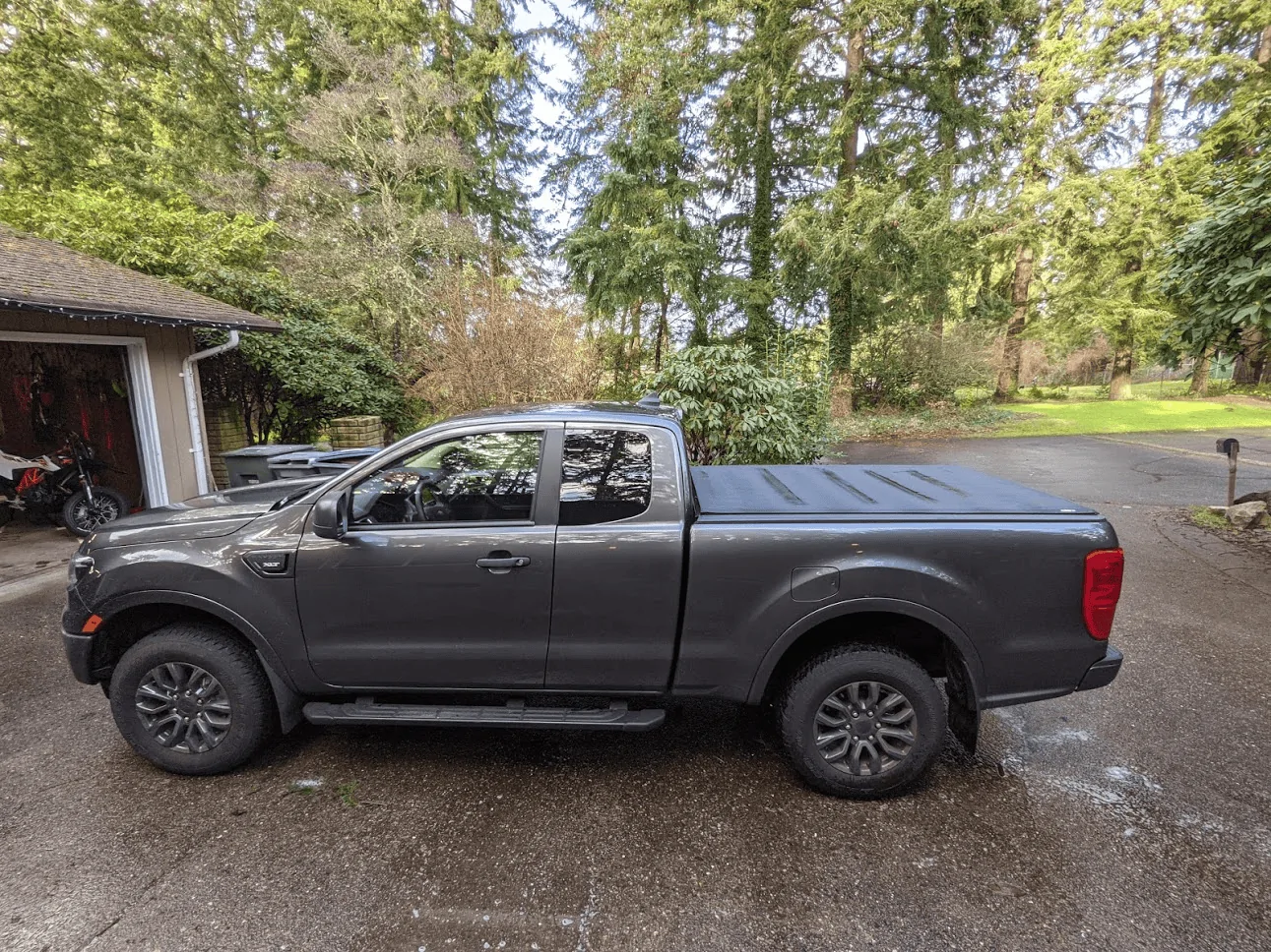

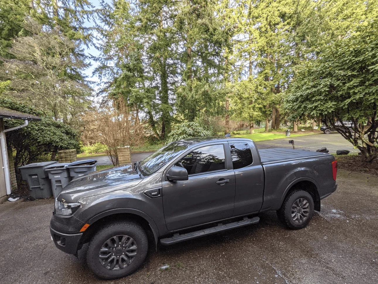

I have the Prox15 that I just installed. So far very water resistant here in WA. I sprayed it all down with a hose directly and had minimal water ingress. I really like how it rolls up quickly and I can still toss a moto in the back. I did not want folding covers as they block the rear window and would make it difficult to put a motorcycle in the back / you lose some bed space.
The prox15 comes off the rails with 2 slides, and you could remove the cover and keep the rails in 30 seconds. I am very happy with it so far. As far as the tailgate, the cover closes on the tailgate. So when you open the tailgate and go to close it, you hit the latch to just pop the rear 4" up, close the tailgate, and push the cover down so the seal is sitting properly. If you don't pop it up, the gate will close on the seal and fold it, making it not seal properly. Takes 2 more seconds. It is also flush with the bed and the material is very nice (main reason I went with the prox15 over their cheaper rolling cover). I'm not sure if there are any covers that do not require opening before closing your tailgate, if there are, they do not get a good seal. The prox15 is super quick to open and close with the single latch.
Here's some photos, keep in mind its all wet so that's why you can see the lines.
