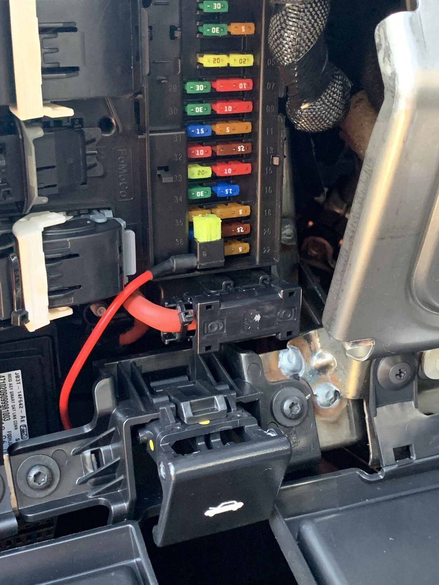

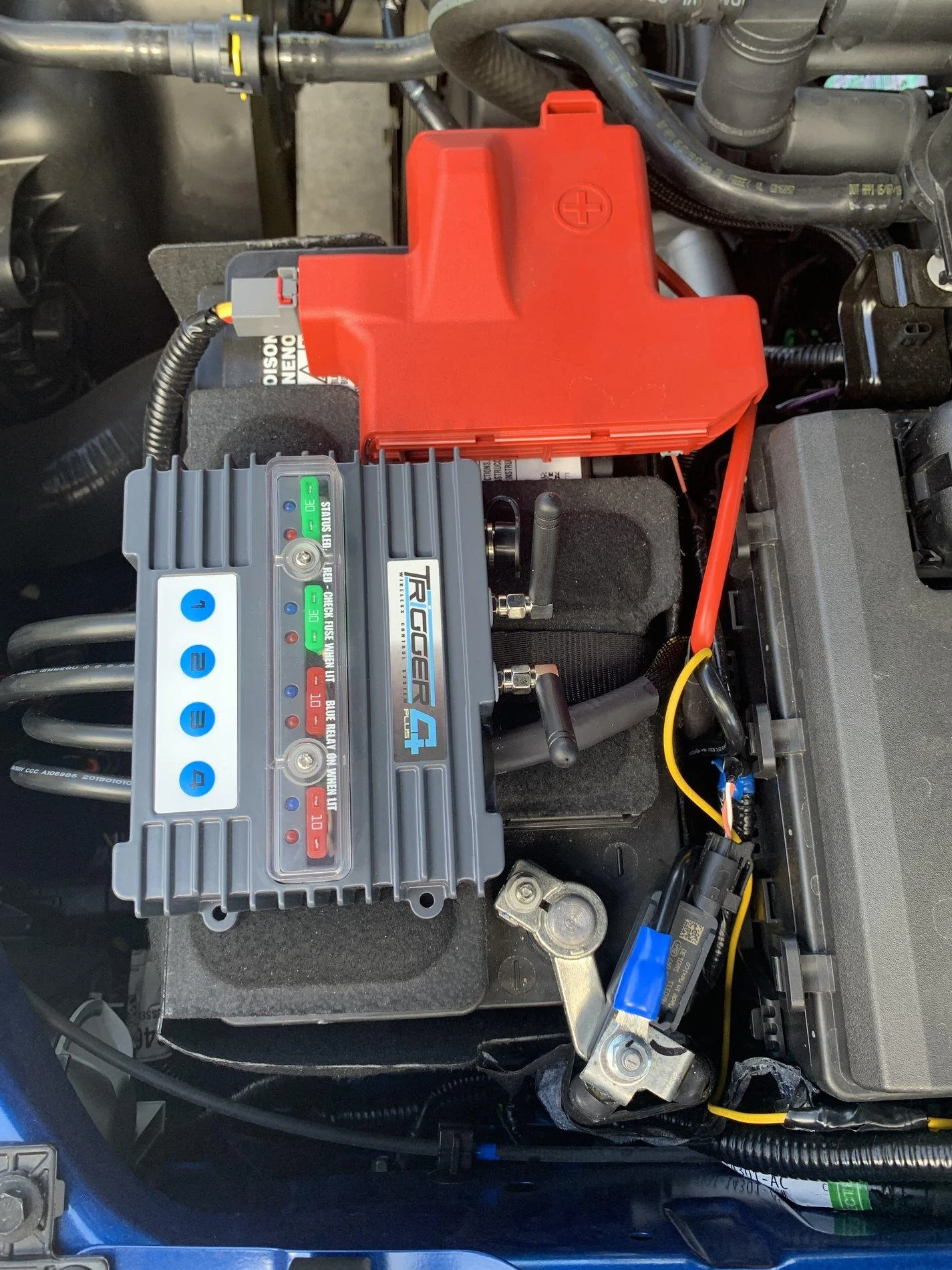

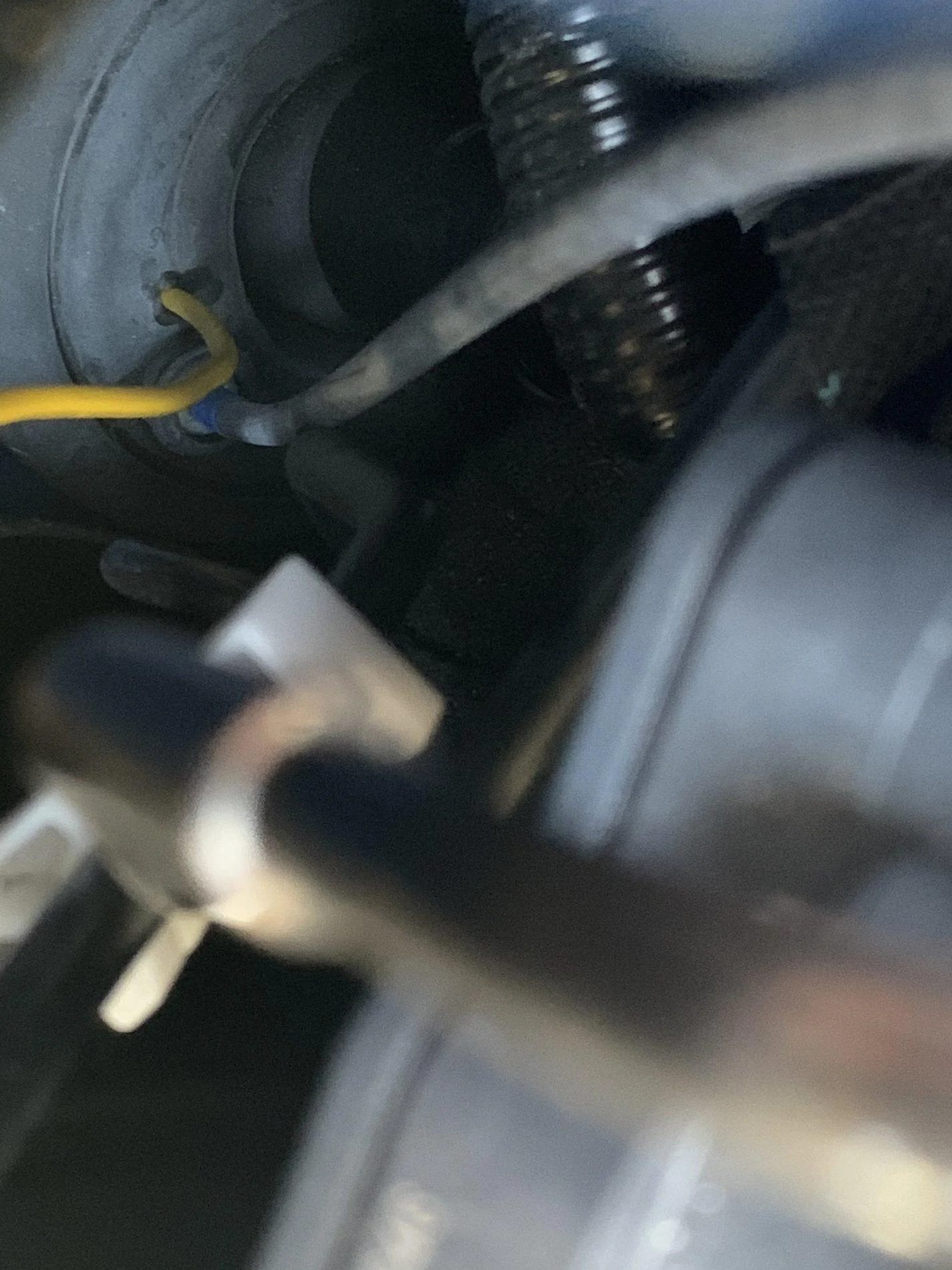

-trigger 4 shooter mounted via Velcro on battery, ran the yellow power through the grommet hood release, and did a micro-2 fuse tap into #37

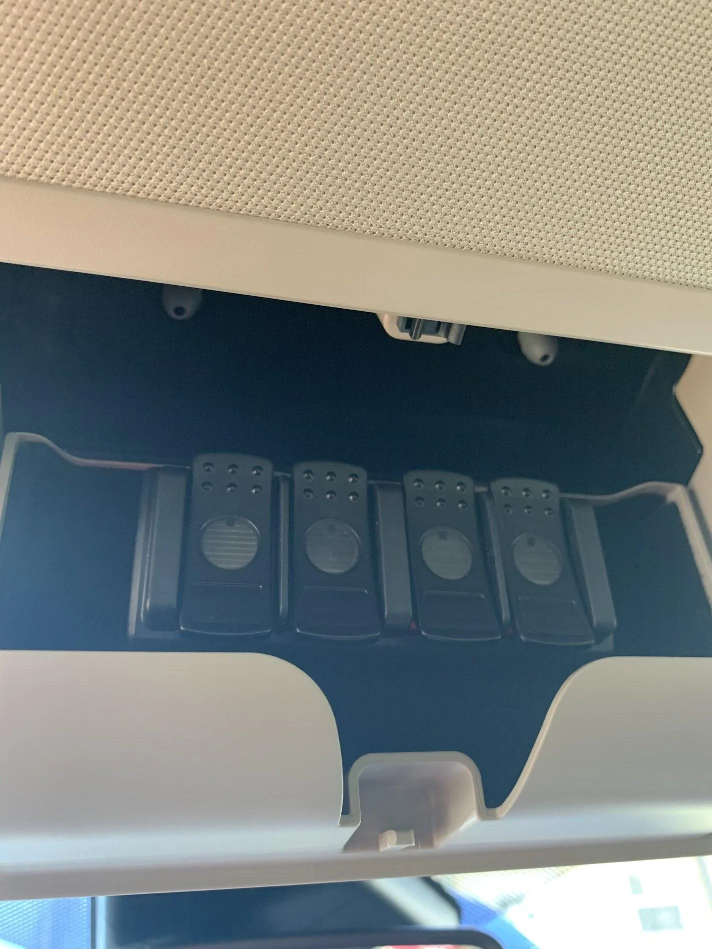

Magnet mounted the switches in the sunglasses compartment so they are tucked away and flip down when needed , which is my favorite part (holds up well so far)

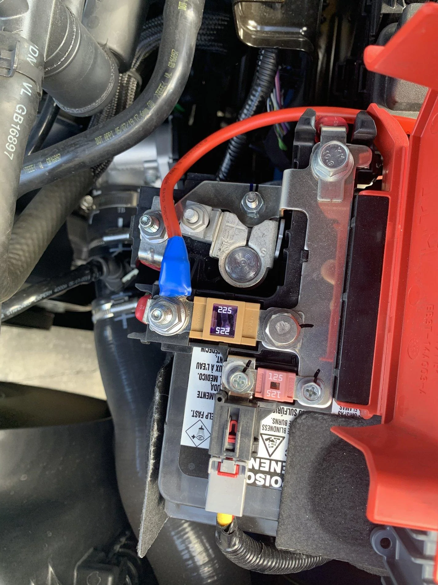

My biggest Q is i see 3-4 different locations on both positive and negative terminals i could have run my cables ,
Did i pick the right spots?

Do you have 20 amp fuses in the add a fuse tap at the in cab fuse box?

I've never seen a add a fuse rated for 20 amps, most are only 10 amps. the only concern i would have. most of them have a rating printed on the package

I don't understand why you guys are adding another fuse...you can see that there's already a 100 amp fuse built into the line...

I only ran it to the fuse box so it would turn on with marker lights without any splicing or cutting
The trigger should take care of the rest as stated above
According to web site only Trigger 6 has the in line fuse (as well as low voltage cut off).
OP Noel installed a trigger 4

I see...thanks for pointing that out...

To ensure proper operation of the Battery Management System, any electrical devices that are added to your vehicle should not have their ground connection made directly at the negative battery post. A connection at the negative battery terminal can cause inaccurate measurements of the battery condition and potential incorrect system operation. When a battery replacement is required, you must use a recommended replacement battery that matches the electrical requirements of the vehicle.
